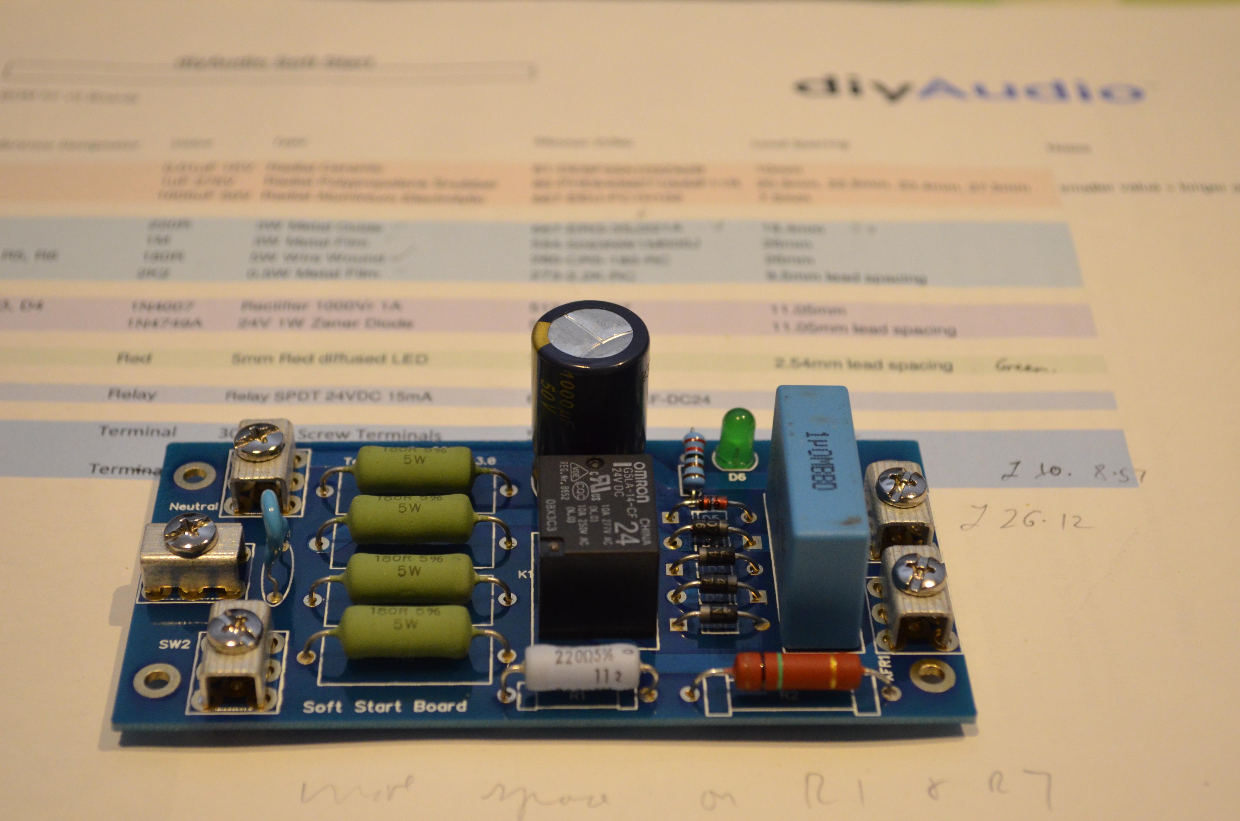

Here's a couple of pictures of a completed board.
I used the Keystone 30A screw terminals instead of the Fast-On connectors.
My Soft start board is built!

Just some comments about my build. Mouser in Europe (Germany) had run out of a couple of the resistors so I picked an alternative brand for R3-6 (Green Vishay) I tested all the resistors before soldering in.
I also picked a green LED, slightly different forward voltage, thanks for confirming it would be OK.
Really useful to refer to the photo of your built board ToeCutter esp for polarity of C3
Based on the post below I will remove the one thermistor (TH) and I guess just solder the leads from the primary together. Note UK 240v
http://www.diyaudio.com/forums/pass-labs/207103-f5-turbo-builders-thread-268.html
"If using the Soft-Start, you may omit the thermistors in the transformer primary"
Cost about £50. for parts, pcb and shipping.
Are there any basic checks I should make before connecting to my amp and turning on?
I will install and update you all by the weekend

Yep. Before connecting the mains, Visually inspect that the joints are good and there are no shorts. Check for no continuity to the chassis from hot and neutral and from hot to neutral.
When ready to power the soft start, do it without anything connected to it downstream and ensure that both relays operate as expected. A voltmeter across the mains output will show mains voltage without the amp connected since there is no current draw.
Then, assuming that are powering your amp up for the first time, next just connect the transformer, again verifying operation of both relays. Repeat with the first PSU, then the first amp channel, the second channel PSU (if dual), then second channel. It doesn't take much time to do and makes troubleshooting much easier since you are isolating modules.

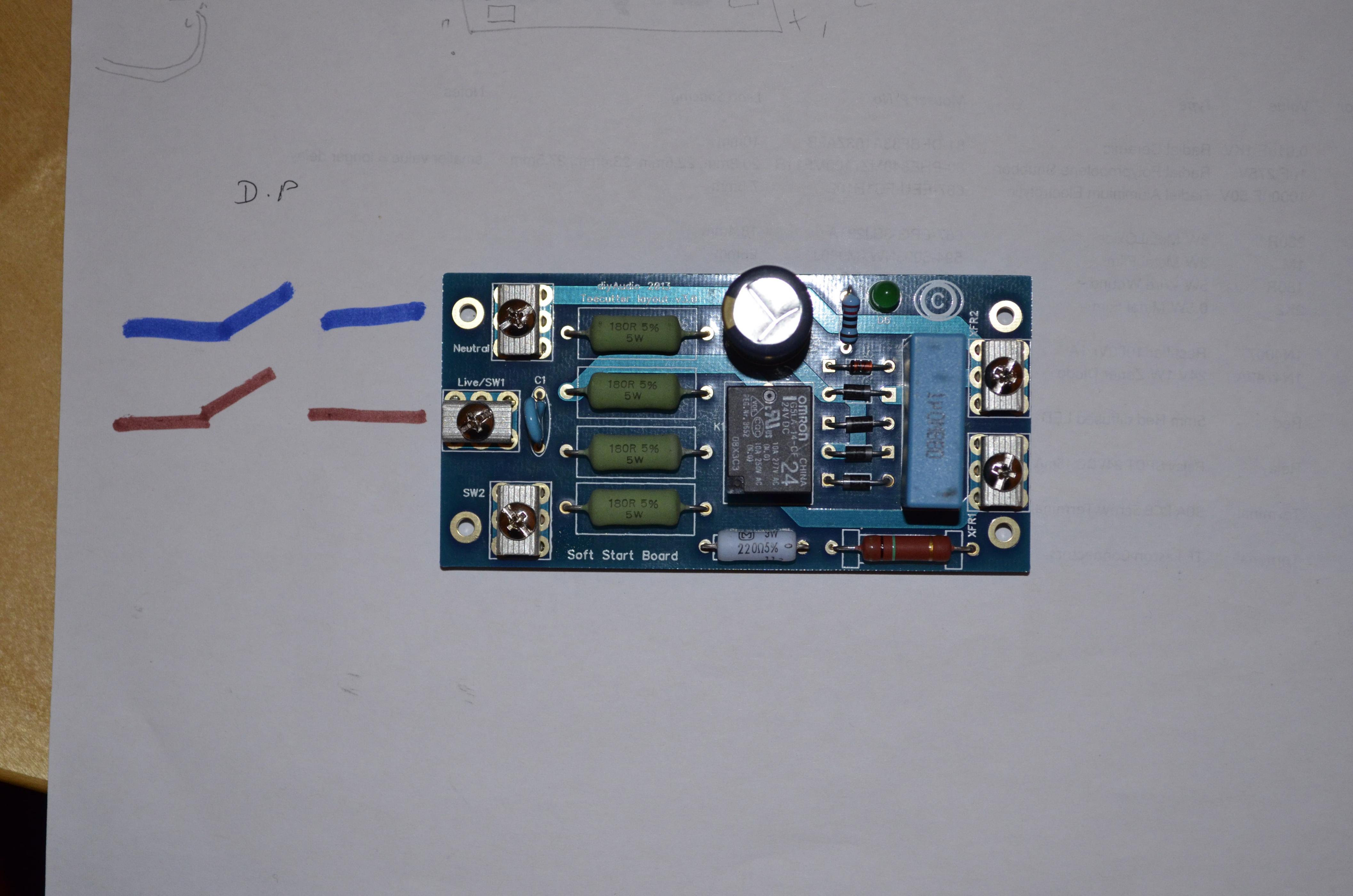

Question about wiring up the soft start board v3.0
Hi All
Please can you help me with wiring up this new board, I need it spelling out to me...:confused:
It seems obviois to put mains L and N from mains switch on left as per photo. Therefore Live mains brown wire to 'live/SW1' and blue neutral to 'neutral' board connector. However I can't figure what connector 'SW2' is for?
Does the primary of my transformer connect as follows, brown wire to XFR1 and blue/N to XFR2 ?
Once you share the answer with my I will update my hand drawn schematic and post for the benefit of others
