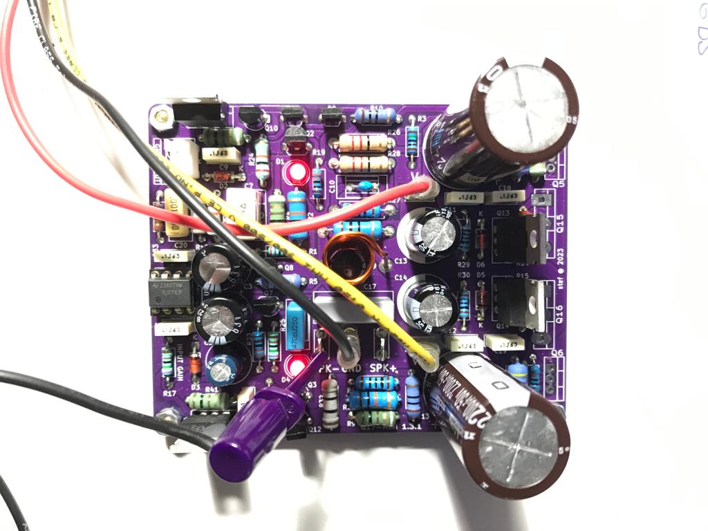

Give it on your advice: I had 1.3.1 pcb and psu pcb's made.psu voltage +-40dc

I couldn't get the circuit to work. The LEDs do not light up. IRFP240-9140 overheats in a short time. Can you help me where am I making a mistake?
First, you should measure the resistance between + Power and Line out, as well as - Power and Line out, without the modules being connected. Before taking the measurement, discharge the capacitors using a metal object. During the resistance measurement, the reading should increase as the capacitors charge.

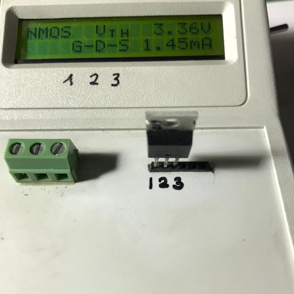

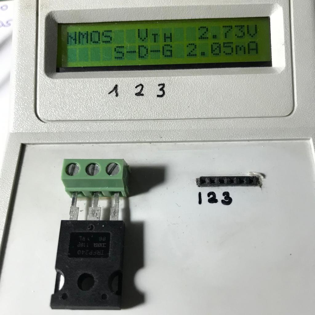

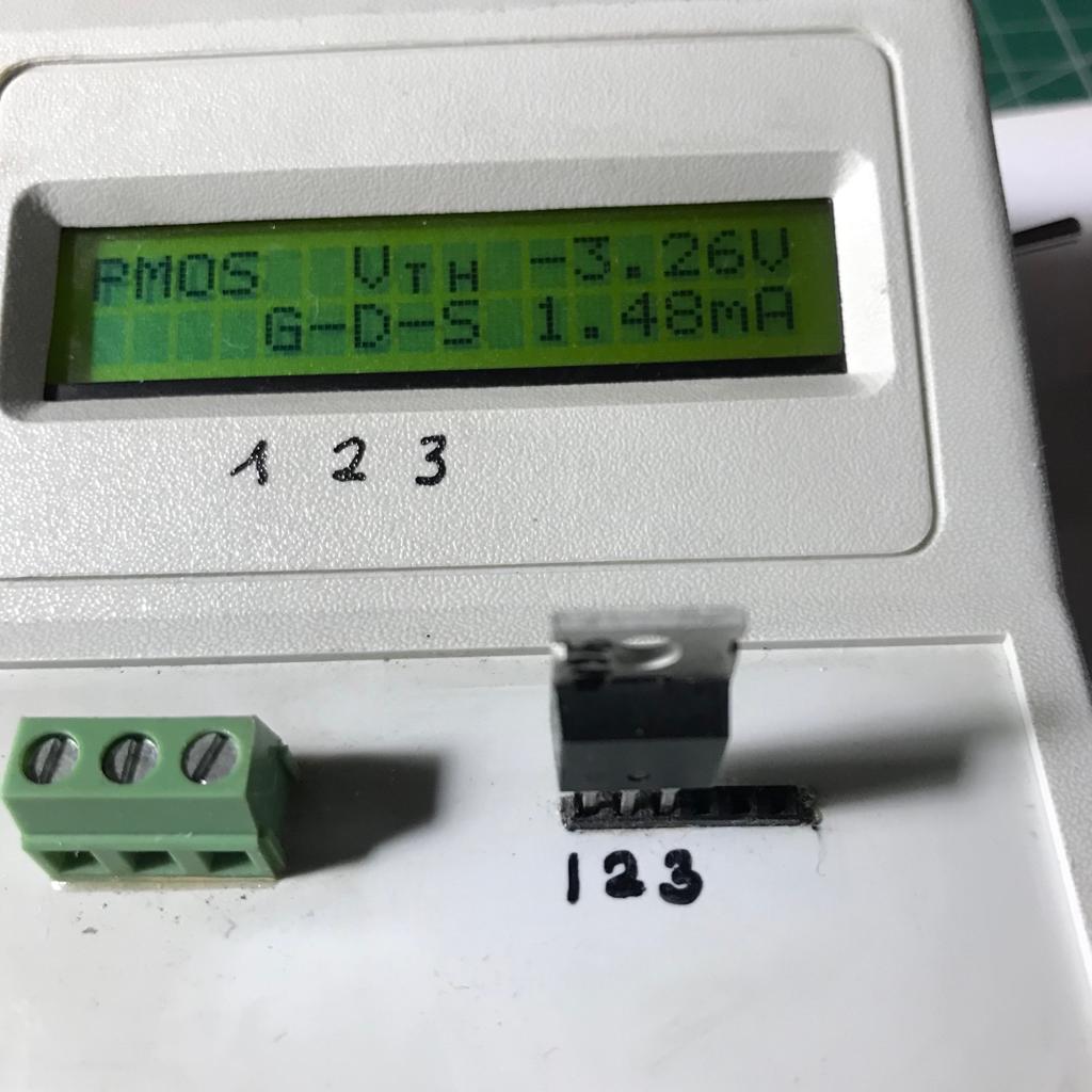

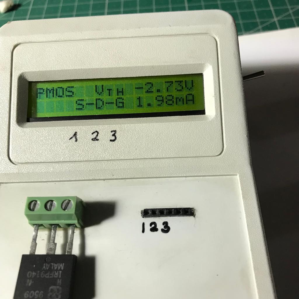

First of all, I would like to thank all of you for your interest and help.
I removed the Q5-6-15-16 mosfets. I checked them with both a tester and a multimeter. They look solid. When the MOSFETs are not on, the LEDs are on.
I checked the values and directions of all resistors, diodes and capacitors. All are normal. I made measurements according to the table on page 107. Most of the values do not hold. I'm leaving it for now. I can't deal with it. I don't have time.

Just curious, did you properly electrically insulate all the mosfets from the aluminum heatsink?
And use plastic shoulder washers for the TO-220 fets?
Also, I wouldn’t trust kapton tape as an insulator, any sharp metal burr from all the holes in that aluminum plate would surely create a short.
