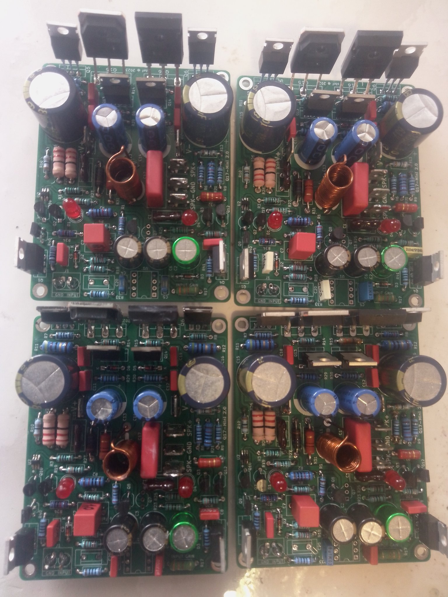

Here are 4 Q17 mini 2.0 tested ... C20 removed.

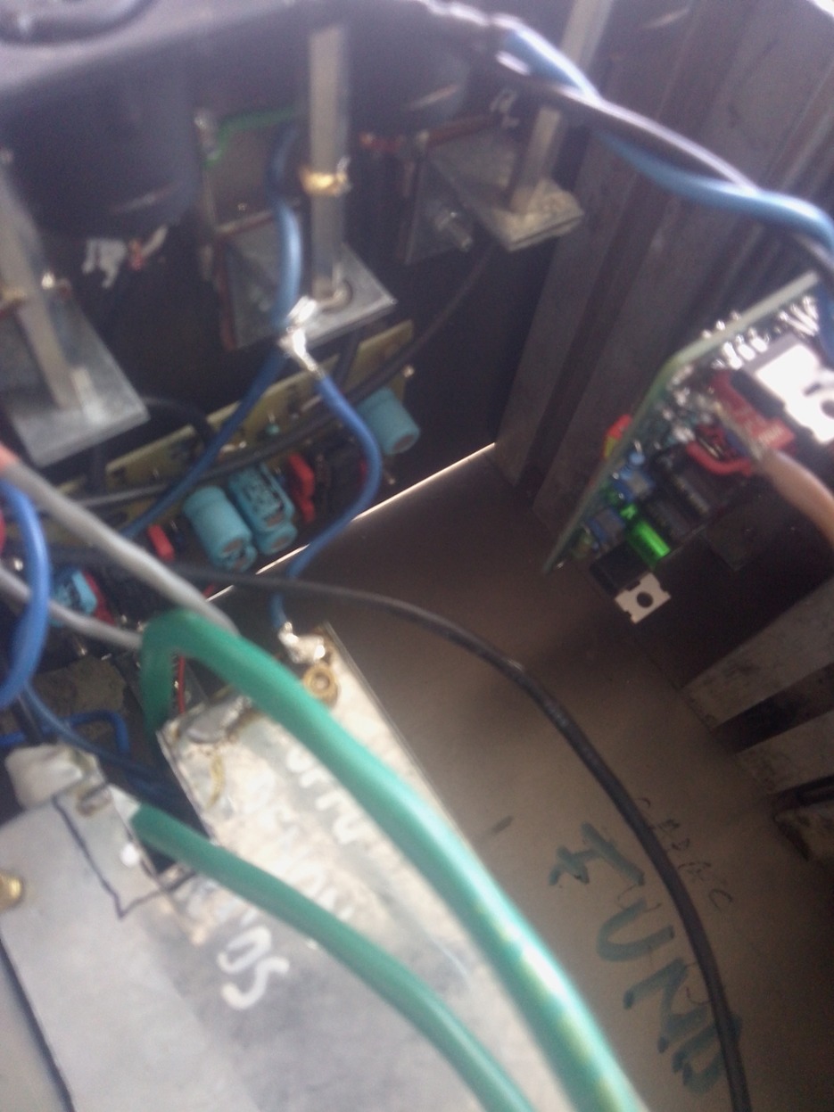

on the other section of the forum someone told me that longer terminals of the Sigma 22 Mosfets might induce oscillations, no matter it is on the DC rail ... I said I am not an expert, but isn't this actually applying for the mosfet terminals of Q17 ? There indeed is high current signal oscillations. The linear DC power supply has constant voltage and variable current on the same polarity, which depends on load.
He said, that because the DC rail is in series with the audio signal, then the length of terminals, dc internal cables, they can induce "absolute audio frequency "modulation"." If that is true, then what kind of internal cables should I use from the rectifier +/- toward the Sigma 22 and then from the +/- output of Sigma 22 toward the Q17 PCB ? ...
unfortunately I can't make them very short because of the distances. My metalic box is half meter long, and at the very back is the transformer, and at the very front is the Quad PCB and a preamp. So the direct current cables are very long already, no matter how long are the mosfet terminals themselves ...

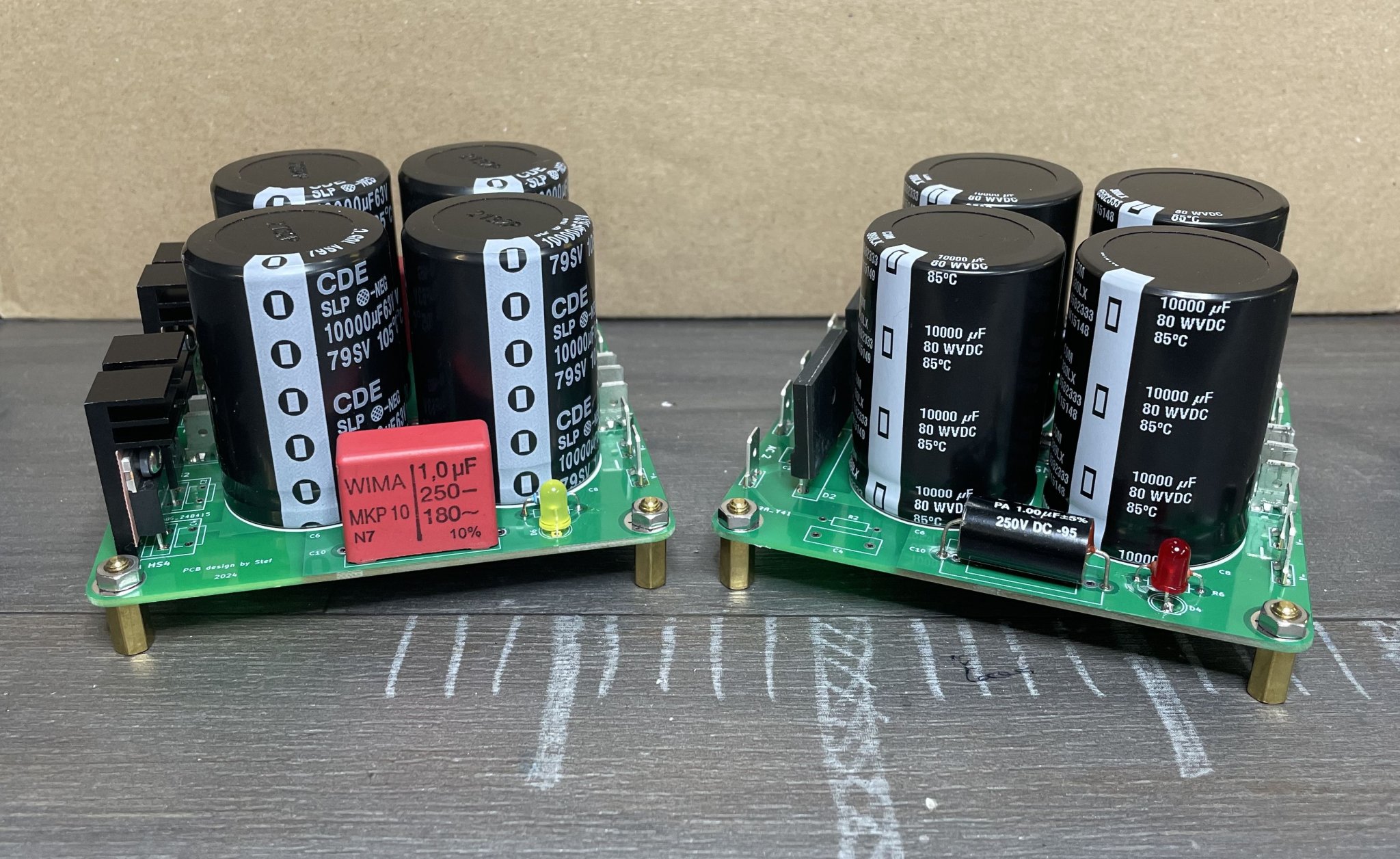

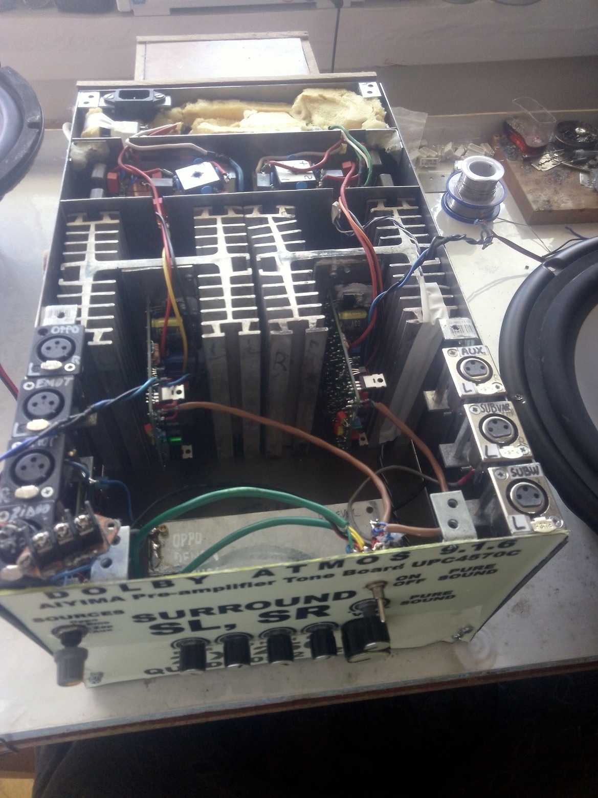

Tested and installed, two more Q17 Mini 2.0 modules. It works great. No audible noise from the Q17 board. I need to change the trafos. They were undersized, and don't give much current. I'll use (as soon as I get it) a SMP800RE configured at +/-63V x 8 Amps (15A peak short). In addition to that I may or may not add the newly developed Sigma 22 for +-55-59V.

I was lucky to get the last piece available at 800W ... maybe it will work on my speakers. Because I am listening everything in quadrophonic, I am just guessing that I won't be needing so much bass. SMPS800RE may cover peaks up to 1150W ... I don't know. My trafos are only 300W per stereo so 600W per quadro. But if the SMPS will work ok for a stereo module, then I'll buy another one for the other stereo module. I won't power everything from one single SMPS board. It might not work for bass.
I would still add 10 or 20.000 uF (with some risks) in order to get enough joules for the bass. I'll test if the SMPS800 will accept 20.000 uF or only 10.000.
Ok, good to know 3800 uF maxim. The worse case scenario, I 'll buy 4 x 800W for each Q17 board separately. I hope it will not be the case. It costs 500$ for 4 SMPS's ... however trafos are not cheaper also. So, not much difference. But boards are small and light, trafos are big and heavy.

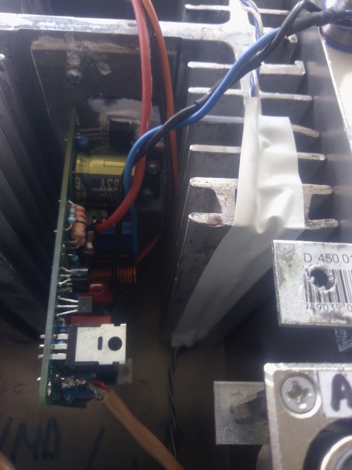

What I feel it might pose a problem is the R11,R12 of 47 Ohms which are heating at 65 degrees Celsius, and they are placed just nearby the C15,C16 heating them at about 45 degrees Celsius. Maybe moving R11,R12 on the back side will solve the problem. The same problem I had with the chinese Quad, and the 560Ohm resistors at 2W and even if I changed to 3W it was still hot, so finally I added them on the back side. On long term function, C15,C16 will shorten their lives ... and/or explode.
It's not the amount of smps supplies, but the possible failure to start if cap bank after it's output is large. Some smps go into protect mode if charging surge from caps is too big. I haven't noticed issues with mean well lrs supplies up to 18k uf (but experiences may differ).
It should depend on the amps they were designed to offer ... and secondly to the caps' ESR. Low ESR maybe worse than ordinary ESR and they still doing the good job.
