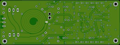

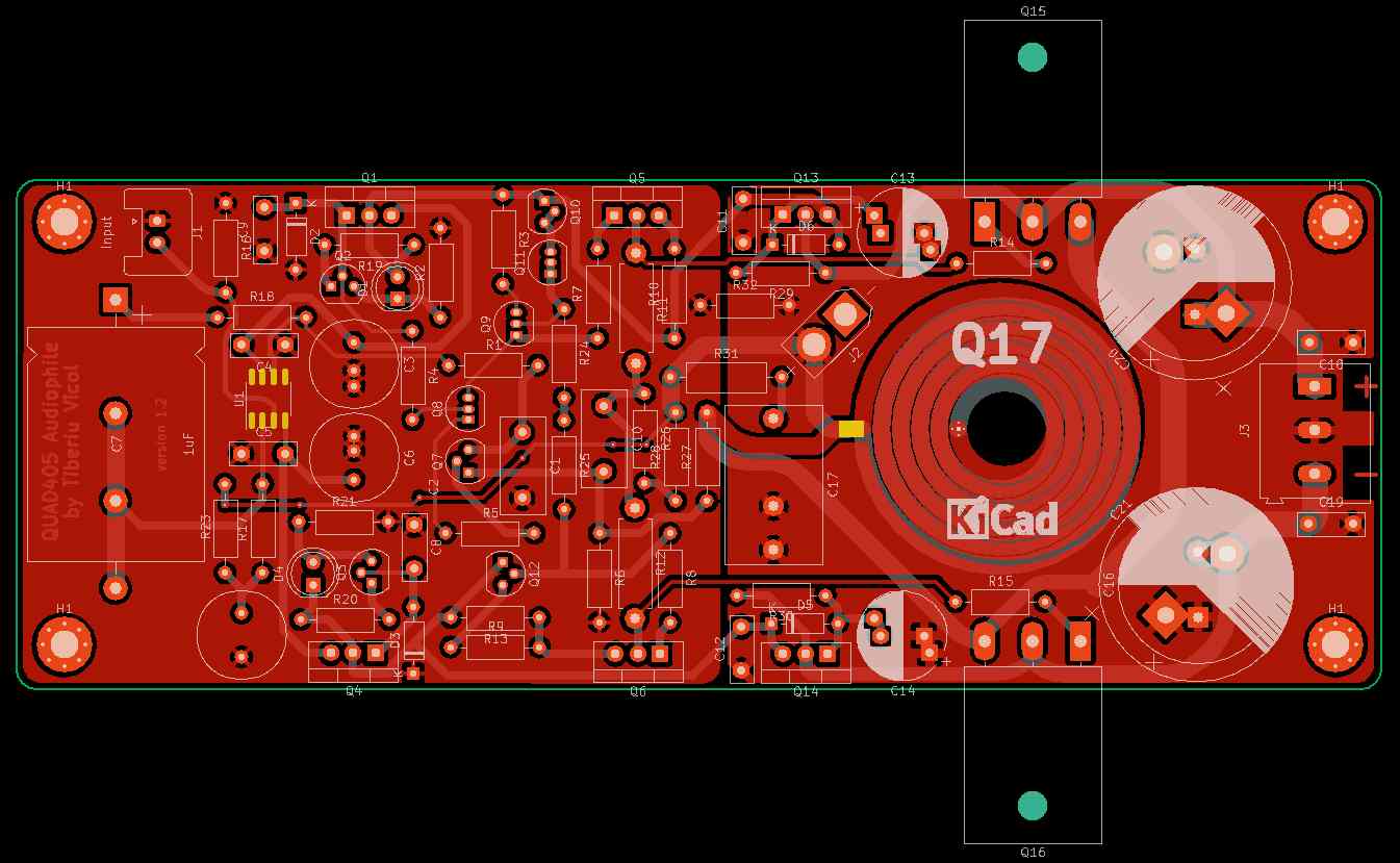

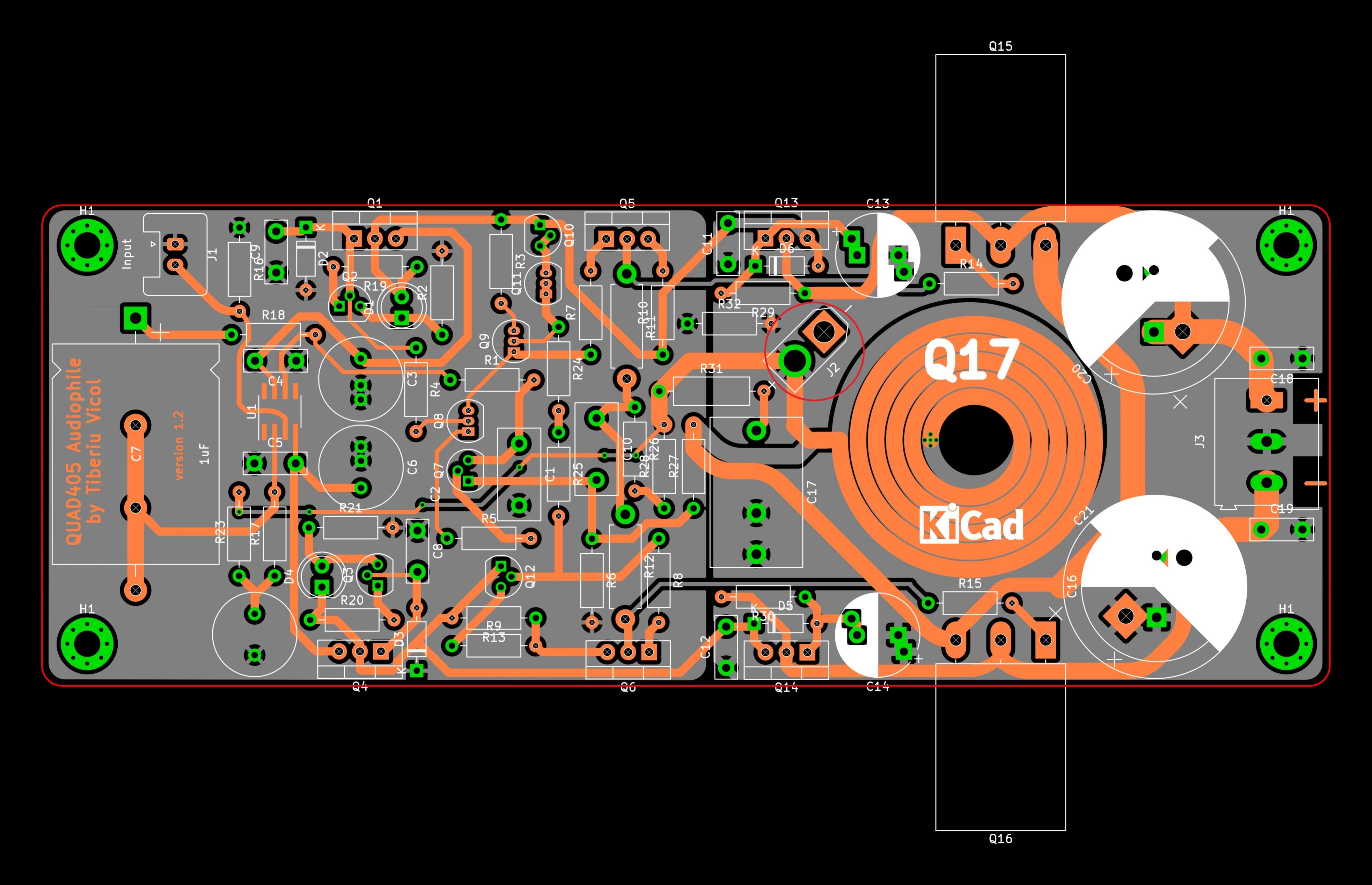

Hello Tibi,
it is really much less work to adjust the layout with the new KiCad. I have compressed it a bit so that the large film capacitors also fit on the PCB. The MosFet now also move to the inside, so it only needs 8 x 16 cm area. It's definitely not easy to assemble, but for a couple - never mind.
I will report when it is finished.
Regards Tim

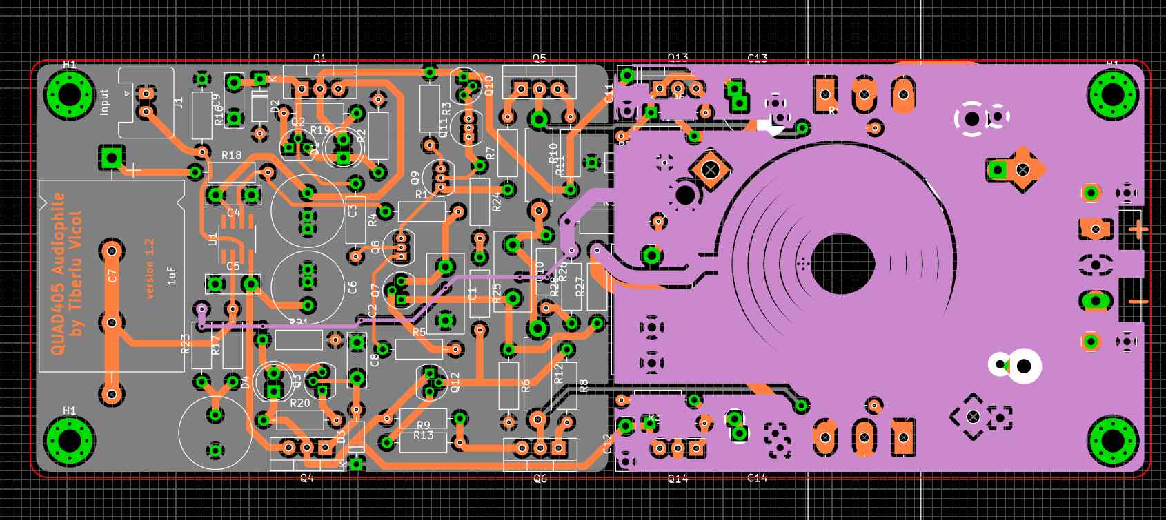

Gerber files imported in Sprint Layout are not OK. Output connected to GND ? Electrical test , the same .:(

Hello Tibi,
Regards Tim
Looks nice !
Do you use series LED's instead zener on opa regulators ? If yes, than you must choose these to summ ~18V. Over mosfet you will loose 3-4V, so regulator output will be 14-15V.
Tibi
As far I understood (from KiCad forum), here is the mother company of gerber Reference Gerber Viewer, by the developer of the Gerber Format
Also, KiCad developers mention that KiCad is one of the few EDA that fully comply with gerber standard. I do not know too much about gerber standards, but I like what KiCad has become, so I trust them for their word.
What I want to highligt is that, if you want to check your gerbers for compliance and errors, Reference Gerber Viewer, by the developer of the Gerber Format is the place to go.
Alex, I'm sure you can design this board far better than me. I see there are people that would like to have a drop-in replacement for original Quad405 boards. Why do not make one ?
Tibi
Hello Tibi,
right, I would need 8 LEDs to get to 18V, but only 3 mm size of the available space will do. I will replace this with a combination of low voltage Z-diodes and green LEDs. I have read that Z-diodes of low voltages are supposed to noise less.
About the PCB layout. I'm actually more interested in the resistance of the inductor and when it blows like a fuse. The thickness of the copper layer on a normal PCB is very small, the specification of 0.5 unces per surface is not clear. Possibly it is 35 um in the case of JLCPCB. Then the 2 mm wide inductor should have a conductor cross-section of 0.07 mm² and approx. 50K overtemperature at 4A. I calculate a resistance of 0.21 Ohm from this, provided the copper thickness is correct.
Another point is the ground on the board. I therefore put the ground on both sides - the one from the input and the one from the output - so that the two sides are connected to each other through the contact holes of the components.
The components can be ordered cheaply from Reichelt - except for the QFET - and are half the price of Mouser.
So here's another question: You chose Q7 as the NPN, is the 2N7000 less suitable? I am also surprised that you chose a transistor with hFE in the order of 600, they are supposed to be more noise. So if I interpret what you say, Q7 is a pinhole for the sound. ;)
Regards Tim

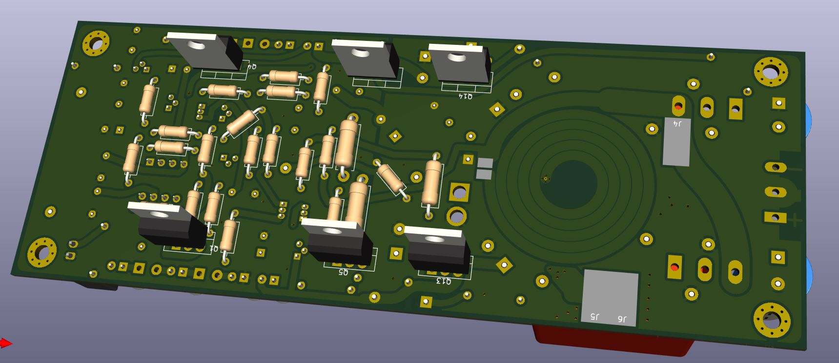

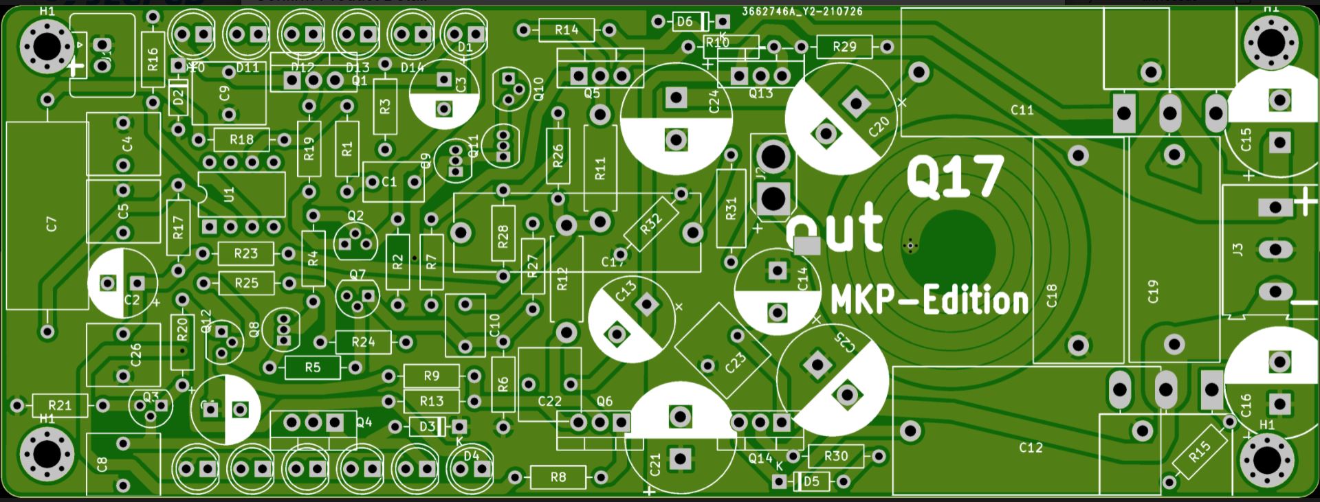

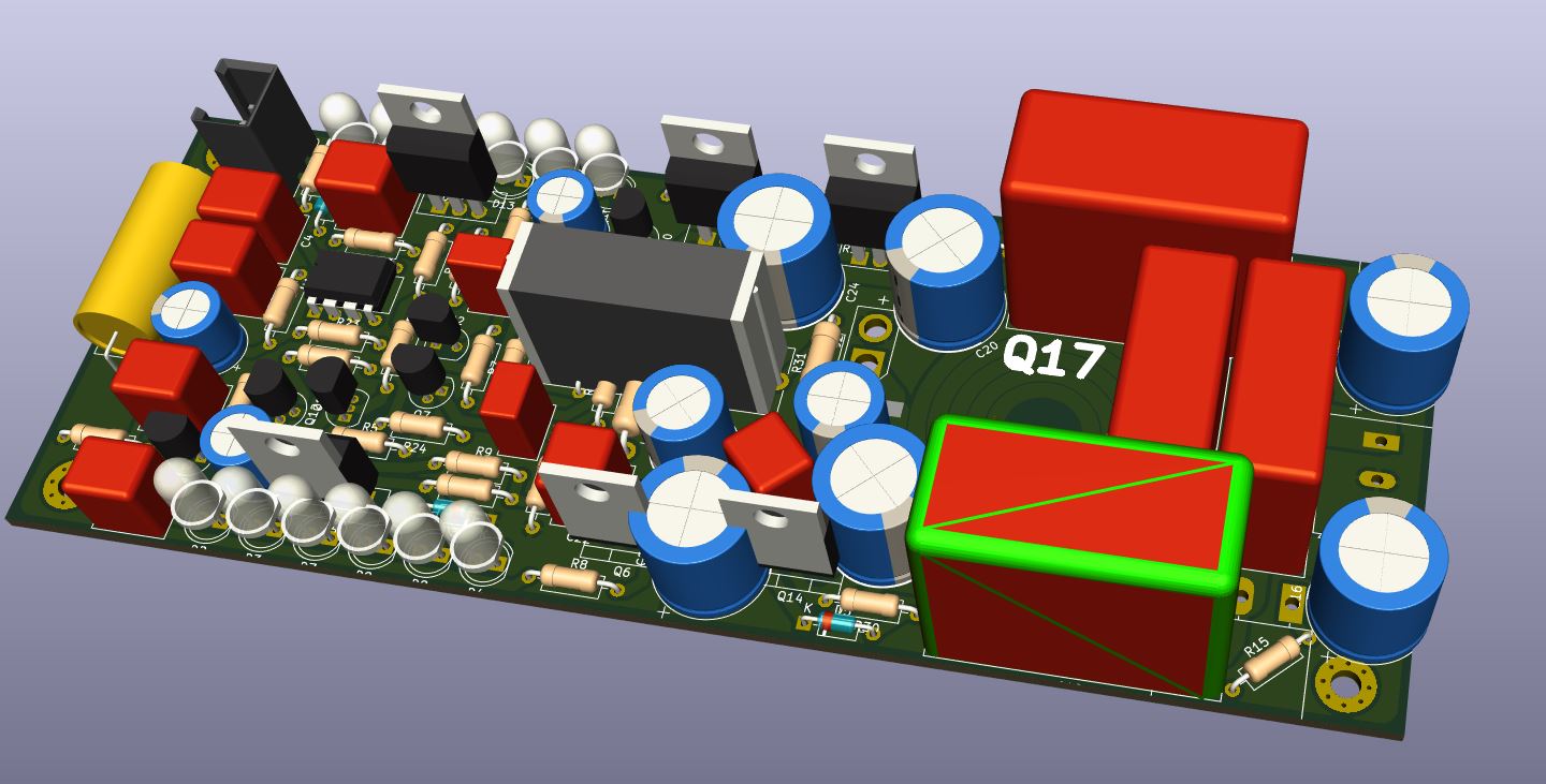

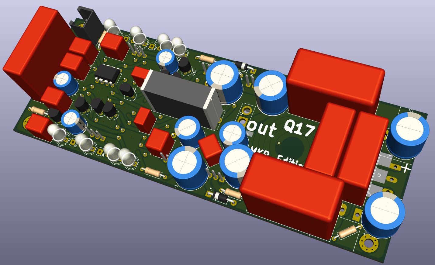

Hello,
I have further developed the PCB layout, now the resistors are on the back side, also the large transistors are now drawn in upside down.
With this I create space for the assembly of the top side.
Since the QFET are designed for a lot of power, I have added contact areas, so that both the onBoard inductor, as well as a self-wound from thick litz can be installed. Beside the contact points for the connectors and terminals I added solder pads, so you can also solder cables directly.
The 18V diode I have built by a cascade of LED and Z-diode, so everyone can install his personal favorites.
The large MKP should be Wima MKP10 for the power supply, for the 1.0 uF and 0.1 uF capacitor I would install Audyn QS6, which is cheap and very good. Tin foil capacitors would then be for me the extremism variant, for especially clean reproduction. The electrolytic capacitors are Panasonic EB-A, these should have particularly good ribble damping.

Output connector issue was corrected and I have rearranged component description for all parts. Everything must me more clean and easy for someone who want to make this amplifier with my gerbers.
I can not edit attachments in first post, therefore here it is.
Tibi
