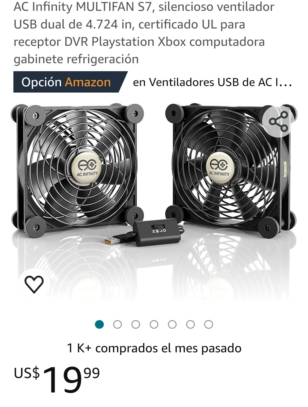

Maybe I exaggerated. The fans are really loud like they are on high speed or something.I wonder if there is a speed dial inside that could control the fan. Or I wonder if I could replace the fans with something like this

I wonder if there is a speed dial inside that could control the fan...
There's nothing inside the fan that you can change. Externally, it would be a chopper regulator for DC fan and a TRIAC phase control /dimmer for AC fans. For AC fans, you could also reduce the frequency but that would also require a proportional reduction in voltage, which is double the trouble.

"There's nothing inside the fan that you can change. Externally, it would be a chopper regulator for DC fan and a TRIAC phase control /dimmer for AC fans. For AC fans, you could also reduce the frequency but that would also require a proportional reduction in voltage, which is double the trouble."
I didn't mean if there is something inside the fan. I meant if there is something inside the amp that sends a signal to speed up or down the fan.

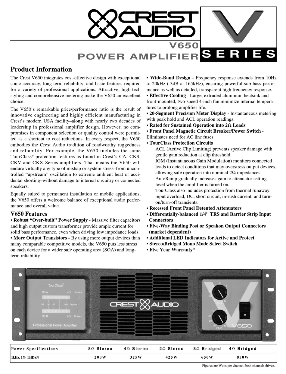

The service manual doesn't seem to be freely available but this document says the fan is "two-speed", so it's likely to be a DC fan with the speed controlled by the drive circuit voltage.
And as mentioned above, the original fan label should have the make and model number on it, so it should be possible to find the specs.
Then you can search for a replacement with a lower noise spec, while having the same voltage and an equal or greater CFM spec.
It's also the possibile the fan is worn and noisier than it should be, or there could be something wrong with the drive circuit so the fan is running at high speed all the time.
I would start with a good cleaning inside the amp to make sure dust is not causing the problem.
