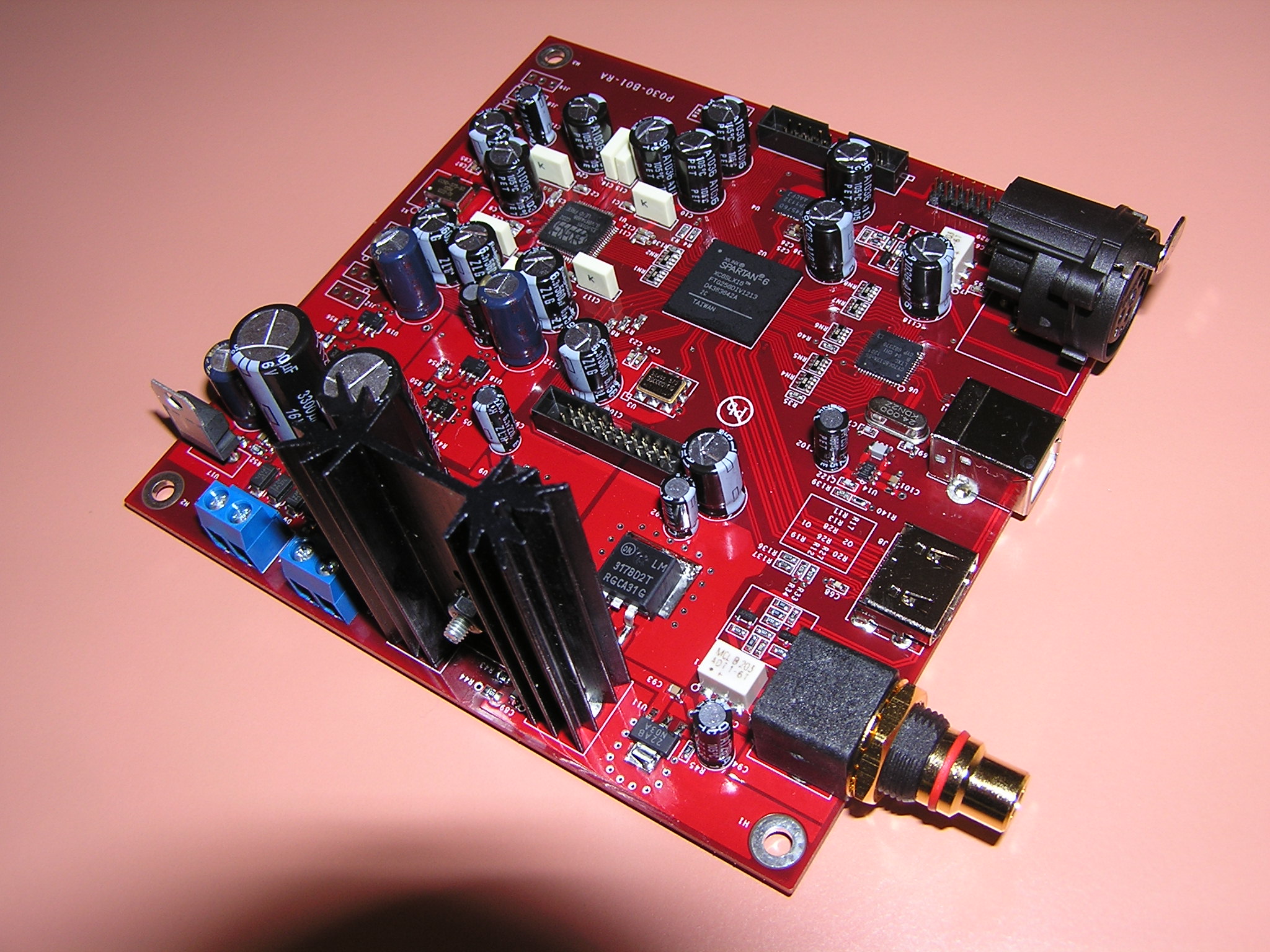

Here it is some info on our future dac RD50, a highly integrated dac with USB, S/PDIF, AES/EBU and I2S/DSD inputs. It features remote control, alphanumeric display, access to ES9018 registers via user interface (a cool feature for those who want to play with ES9018 capabilities in real-time).
With the mighty XC6SLX16 Spartan6-fpga as digital front-end featuring custom digital filters (much better than the ones inside ES9018), an asynchronous FIFO and digital receiver controlled with SI570 digital programmable clock, the module can be configured in a variety of ways. The outputs from ES9018 are directly available for any suitable output stage.
With all rectification and low noise regulators on board, all that one needs to do is to apply the AC voltage. No more myryads of extra boards for USB, reclocking, supply etc - just a simple but very powerful unit - with very short signal paths for perfect signal integrity.
Any comments/thoughts are welcome.

Some of the RD50 features :
- DSD over USB
- DSD over I2S port (lvds)
- up to 384K(PCM) on I2S port (lvds)
- CCHD-575 (100 MHz) master clock for asynchronous dac operation
- Cascaded Dual digital PLL
- remote control with source selection, volume control, settings
- variety of digital filters (filters inside Spartan6 and ES9018 can be switched on and off)
- 4x20 alphanumeric display
..and the list can go on. Due to the fact that firmware is under developement, I let the list open for any ideas.
Also, if there is interest for this dac module, please express it here, it can have a good impact on final pricing.

Hi TiEx,
let me answer point by pint.
1) We are using Rubycon ZLG which are ultra low impedance.
2) For now it's just the module, but it includes all the controls for the ES9018, remote sensor, display etc. No external MCU is needed. I will post a general diagram for better understanding of the configuration. Basically this module is 'plug and play'. Aside from the module price (about 400 euros), you need only trafos and display, eventually the remote.
3) Currently USB supports 192k (an upgrade to 384k is possible in the future) and DSD over PCM (DoP).
4) No chassis yet - it will come soon.
5) Yes, lock status and other relevant informations will be displayed. PLL setting can be set into the low range, (probably lowest - we are performing tests) because of the DPLL built into the FPGA in digital front-end.

As I stated earlier in the thread, the RD50 firmware is not finalized as full functions or user interface. To make it quickly available we have chosen the same UI as for RD30 - same display and remote.
The board will need a IV - as the outputs are directly from ES9018.
The linux support exists and plays quite well - still some bugs are present though. For board mechanical drawing, see below.
