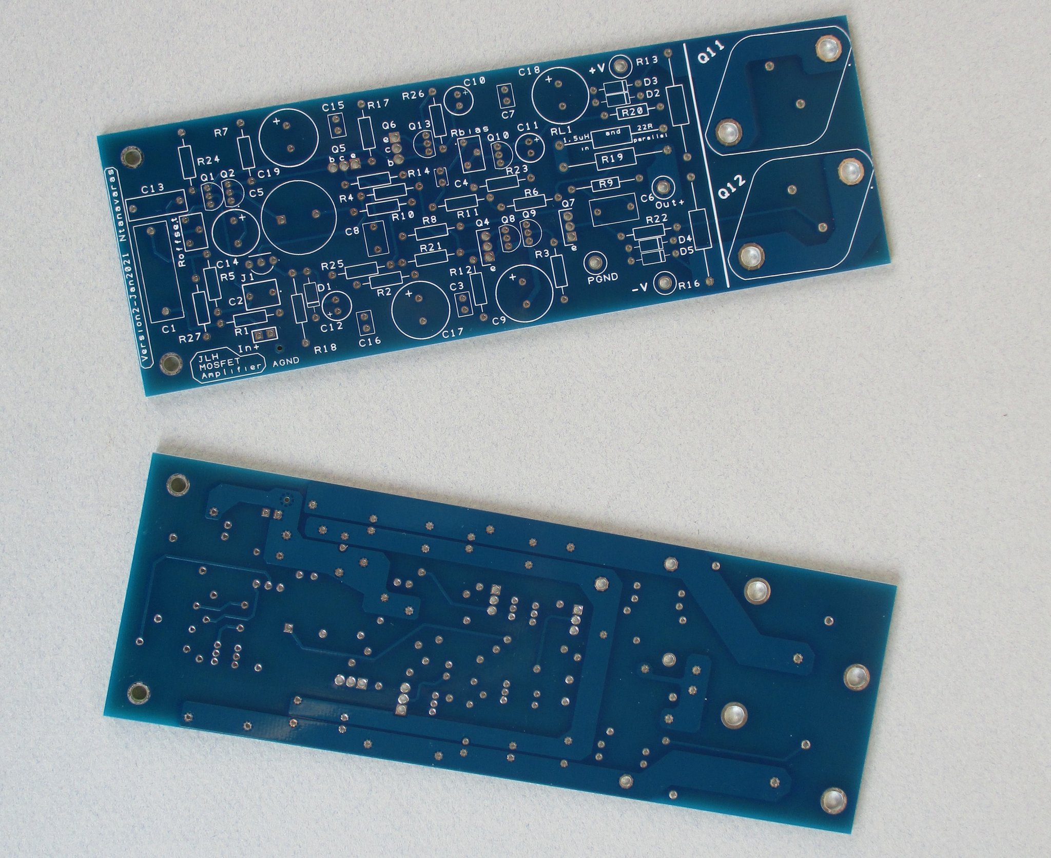

I just received a new batch of PCBs for building the amplifier.
If someone is interested, send me a message.

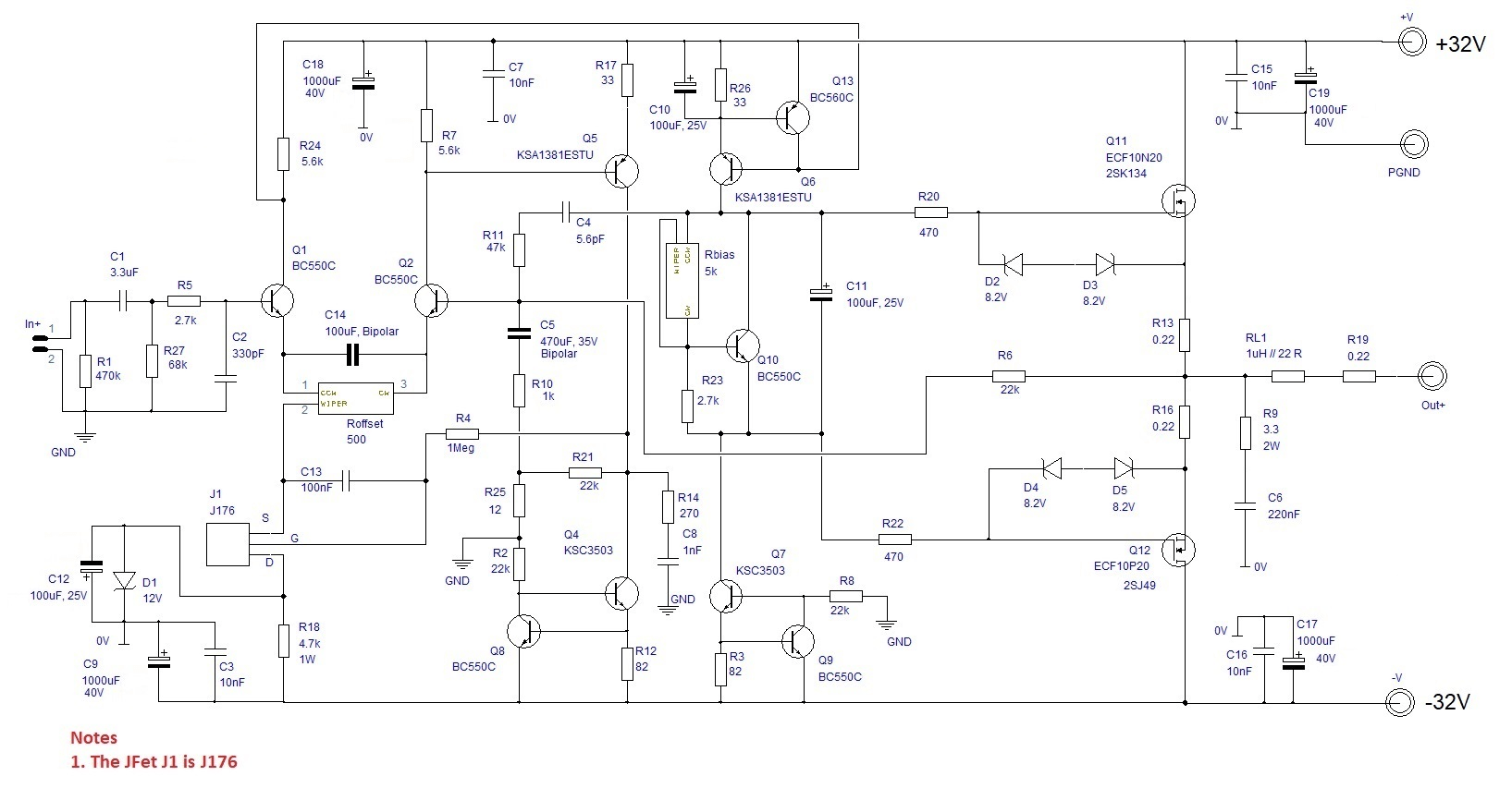

how J1, C13, R4 and positive feedback R21, R25 work. Comments welcome.
From the JLH article, concerning C13 and R4 with J1:
"they form a DC feedback, used to regulate the input current supplied to the input long-tailed pair so that the output voltage at the collector of Q5 is stabilized".
R21 and R25 adjust the positive feedback ratio to increase the open loop gain of the amplifier.
I built this amp with success at the time but I always had some difficulties to understand how J1, C13, R4 and positive feedback R21, R25 work. Comments welcome.
It's an unusual circuit for sure. I think J1, C13, R4 are used to adjust the right end of R21 to be at near gnd; like a dc servo. R25 is a mystery...it doesn't provide much PFB at all. Curious.
The circuit as a whole looks marginally stable.
