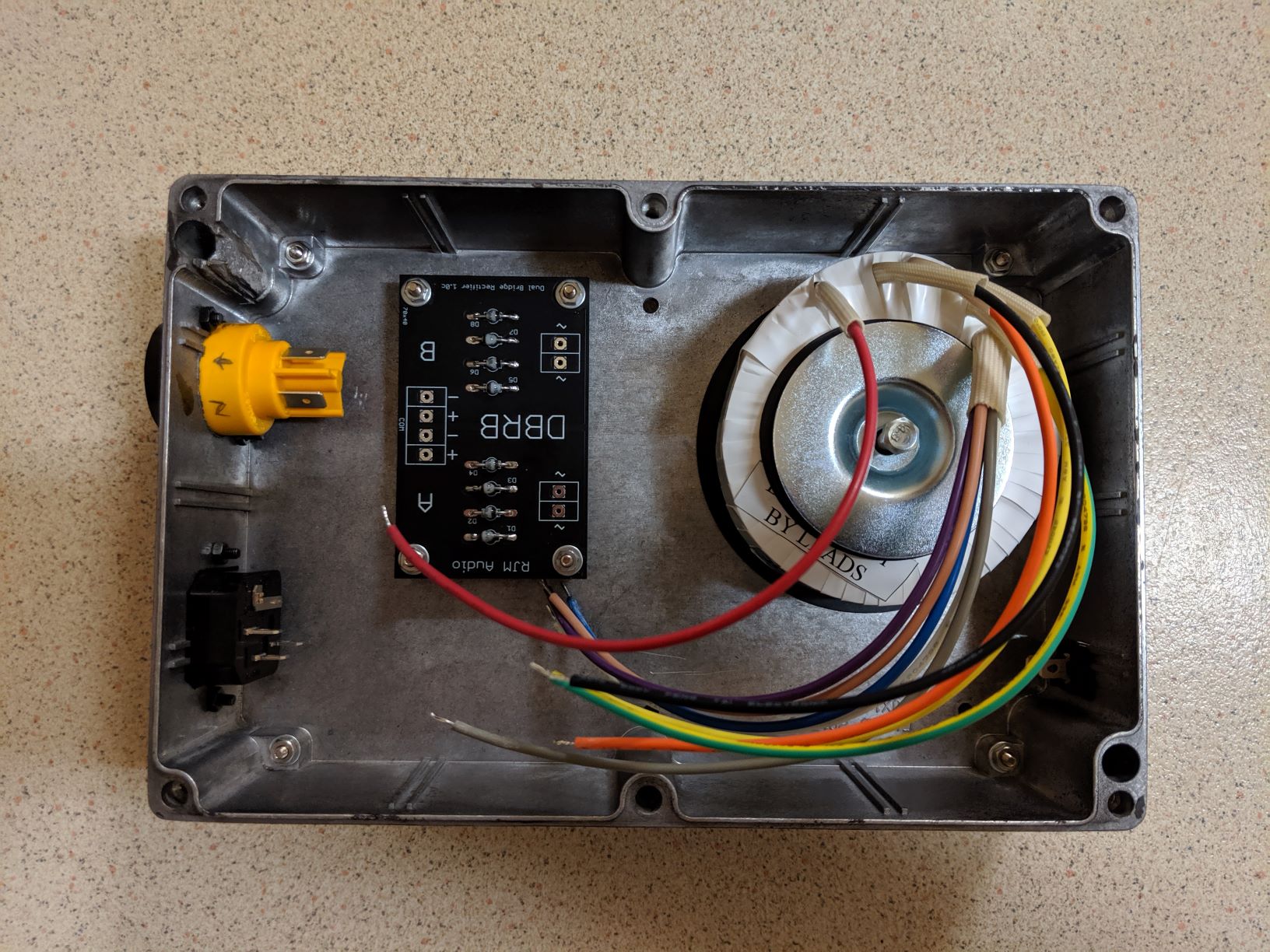

Ok moving on to the transformer casing are there any do's or don'ts that I should be aware of? I recall your recommendation of twisting all wiring (except mains earth) but is there anything else? Spacing of the transformer and DBRB board for example? Also is it ok to add an LED into the transformer case? If so, wired from the rectified side of the board? 240V mains-in spaced away from the DC out wires is another question?

Since the power supply doesn't carry signal, there really isn't much to worry about except safety and not mixing up the positive and negative connections.
All good then. Thanks.
A pic of where I'm at then...

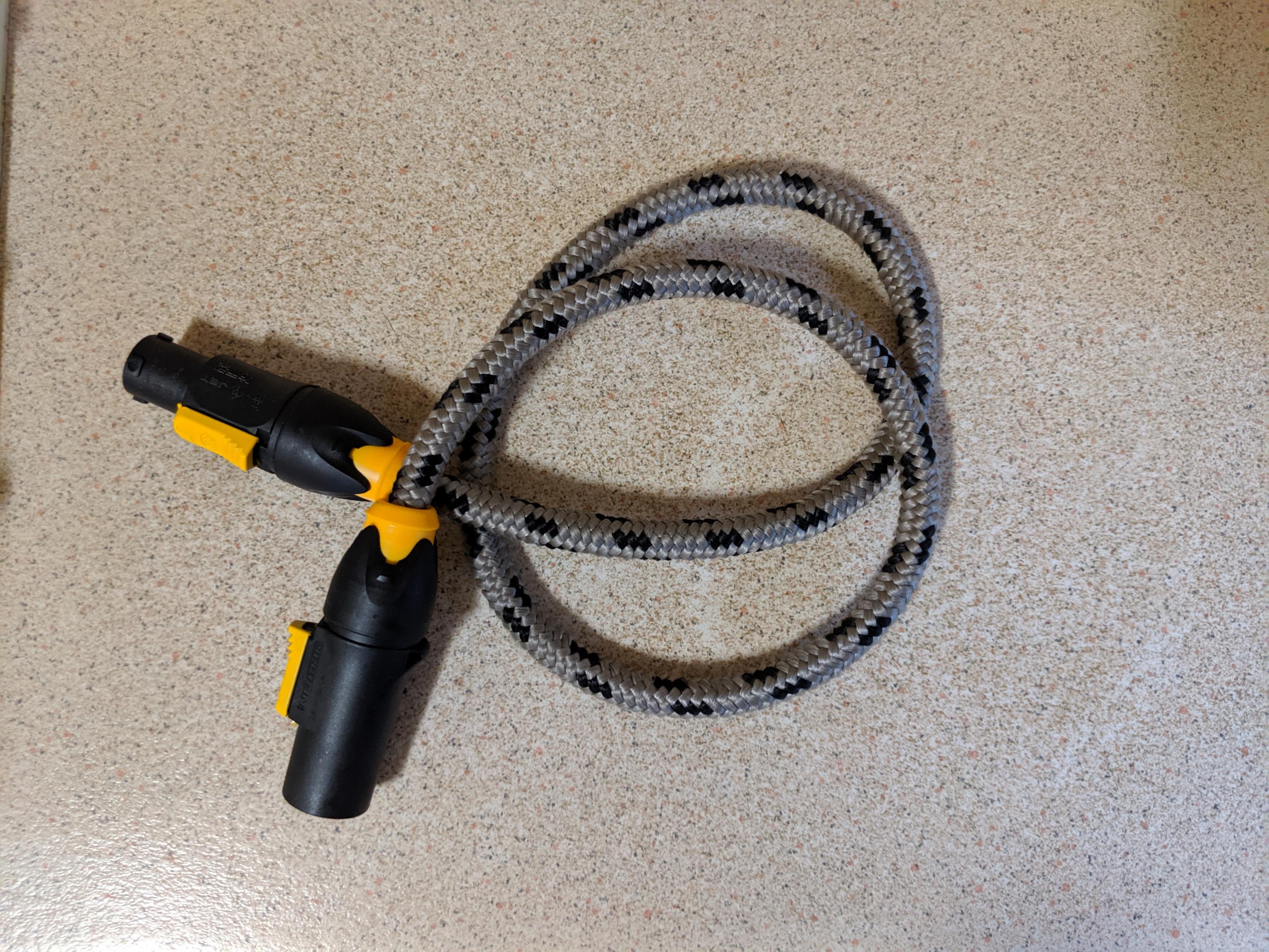

Seems like you have everything well in hand. What is the yellow connector for the power umbilical? Is it XLR?
Correct.
https://www.neutrik.com/en/neutrik/products/powercon/powercon-true1
Umbilical done,

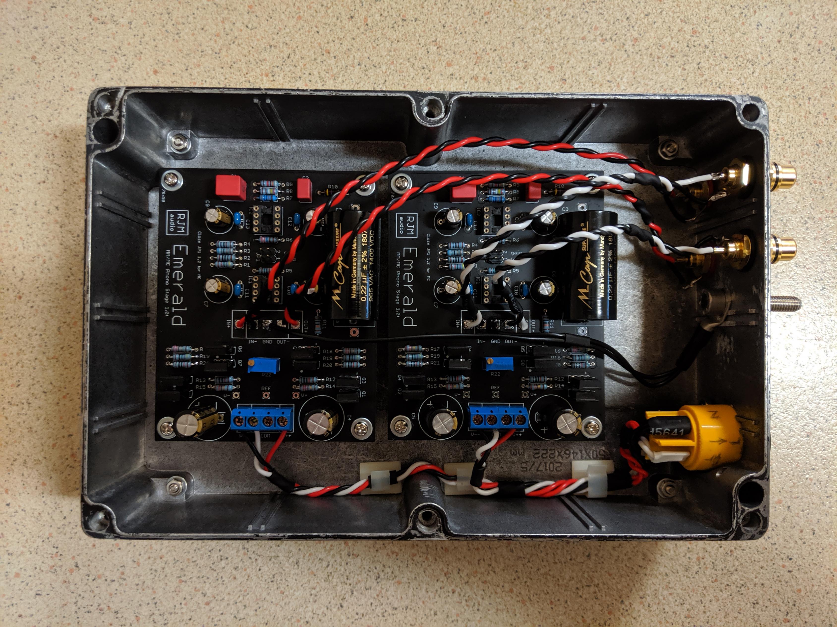

I have built the Emerald and more recently the Sapphire Headphone amplifier.
For testing I used a single 32va transformer.
Now that I am about to move all the boards to a rack mount chassis I thought to improve the power supply and connections..
I installed dual 32 va transformers with single bridges and canon connectors....
Wow!.... there is just no comparison....it's like I upgraded from a $500 circuit to a $5000 circuit....
Now playing lp after lp.....
