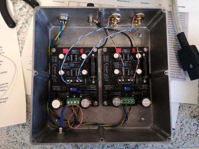

I finally got around to completing the build of the phono stage! The kit has been sat staring at me for a year or so to the side of my desk, so a few rainy days last week gave me the opportunity to get cracking. The most tedious process for me was putting the resistors onto the boards. I'm colour blind (reds and browns) and I did pretty well identifying each resistor value by eye and then verifying with a multimeter. I used my temperature-controlled soldering iron which I picked up from AliExpress - Quicko T12-955, I did have a little difficulty with the smaller pads but managed to get a very good "Hershey's kiss" style solder joint.

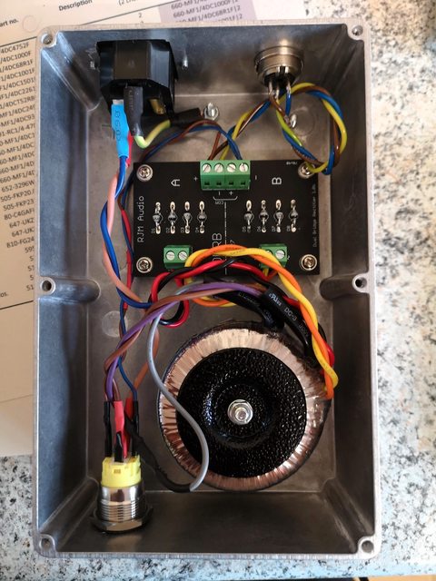

I also took the time to tidy up the wiring in the power supply unit, and also noticed a mistake I'd made with the power LED indicators I'd fitted with no current limiting resistor! These are rated at 12V and have a base voltage of 2.8V @ 20mA, although I found for the anti-vandal switch in the power supply that a 2.2k resistor was fine with no noticeable drop in light output (this LED was also wired up with a braided copper cable). In the phono stage I was using an anti-vandal LED pilot with the same specifications but found that the 2.2k resistor was getting very hot (too hot to touch), I'd wired this one with the same solid core UTP cable I'd used for the audio signal cables, so made the assumption that the cable in the power supply was providing some resistance which the UTP cable did not. I upped the resistor to a 4.7K which gets warm but can be held between fingertips without feeling too hot. Incidentally using the LED specifications and the following formula was suggesting an even lower value resistor which would have allowed the LED to draw even more current!

That brings me on to the other peculiarity I found when testing the voltage coming out of the power supply, I was seeing around 18V on both - and + although this was dropping down to the expected 12.7 - 13V when tested at the test points on the phono stage.

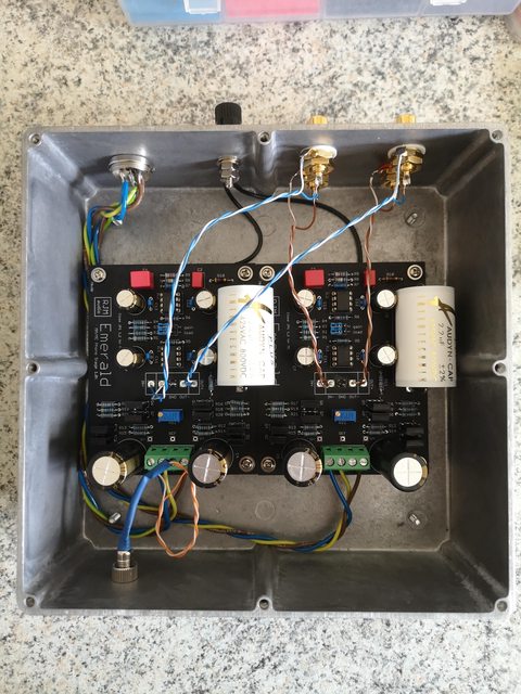

First listening impressions with my Technics 1200 GR and Goldring 1042 MM vs my recapped NAD 314 were astonishing, the sound stage was extremely wide and well defined, I stayed up well past my bedtime spinning discs and enjoying the new sound. I've ordered a pair of Audyn MKP Plus 2.2uF 800V to replace the Bennic caps so can't wait to see if there are any obvious differences. I also managed to get a new Audio Technica AT33PTG/II MC cartridge from Amazon which had been reduced by £100, I took a while making the decision but glad I did as a few days later the price had gone back up to the original.

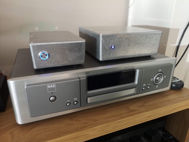

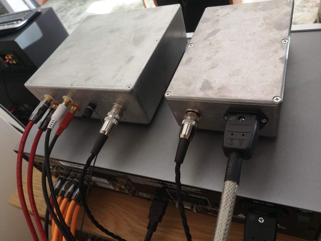

Many thanks Richard and everyone else for sharing your builds and providing ideas. Here are a few pictures of my build!

Your build is very similar to mine, but I tip my boxes upside down so the lids are concealed and the units have a /---\ taper rather than \---/.
18 V (DC) is the normal voltage at the V+ and V- board inputs. You start with 12 V (AC) out of the secondaries, which generates 18 V (approx) DC after the rectifier diodes. The 18 V is brought down to about 12-13 V by the voltage regulators on the boards.

My Audyn caps have arrived, so looking forward to swapping them in soon and listening to any discernible differences.

New Audyn caps installed - had to move the right board over slightly to fit them in the case.
Not sure I can tell the difference, but it still sounds amazing! Listening to The Alan Parsons Project - Tales of Mystery and Imagination yesterday evening was sending shivers down my spine!
