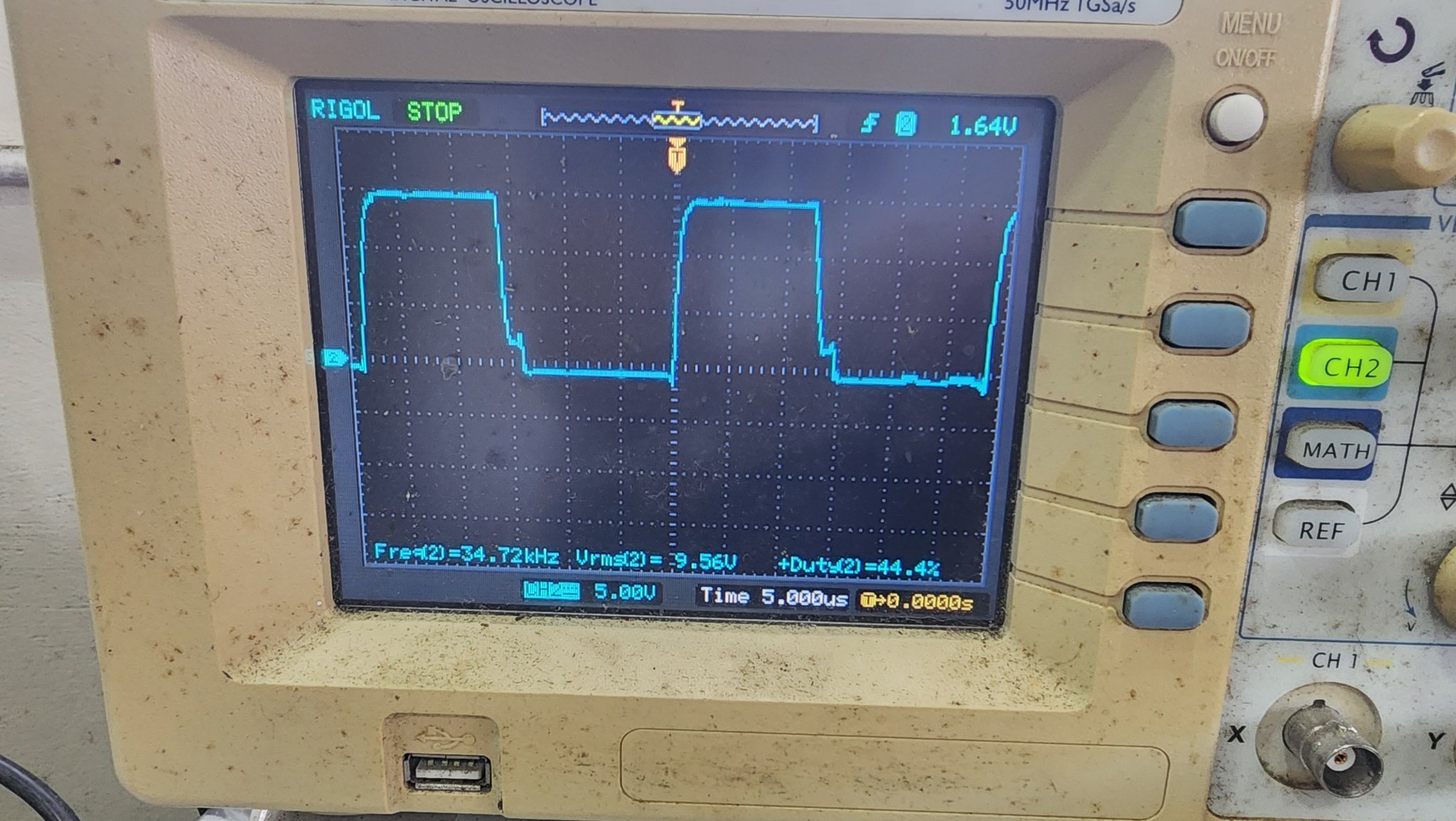

Got this amp with blown power supply fets and driver transistors. Fets were IRFP064N. This amp was repaired earlier and technician had spoiled someone the vias of power supply driver board. I changed fets to 75344g and also gate resistors 51.1ohms. Amp coming on and producing good clean outputs. But power fets gets very hot at idle. And almost pulling 2.1amps. Any suggestions?
Picture showing number of driver board and waveform attached.

I would try reducing the gate resistors. I don't have this diagram but the T400 uses 34 ohm resistors. Rockford goes as low as 22.1 ohms with that PS FET.
I'd go down as little as possible for the FETs to run cool. Then drive the amp hard for at least 10 minutes to confirm that there is no heating of the primary filter caps.
