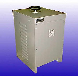

I won't even mention the guy who destroyed a huge floorstanding Staco three phase Variac
that cost around $10k. That wheel on top is nearly a foot in diameter.
I was a Mr. Fixit at the Motorola plant in Florida from 1975 to 1984. During the 70's we made NiCad batteries and cells. There was a "very scary machine" for "polarizing" newly made NiCad cells that I got to fix several times. It included one of those huge three phase Variacs. That Variac fed a three phase custom made transformer that had three large copper bars sticking out of its side. There was a row of about 10 stud mounted diodes about the size of a doorknob on each bar. This apparatus made about 2 volts at "thousands of amps" which fed a rack of several hundred newly made NiCad cells. Measuring the current involved measuring the voltage drop across a piece of metal that was about a foot long and a half inch in diameter. When said "very scary machine" wouldn't make rated current, or blew the breaker, they called me, as the last guy managed to melt a large wrench and wouldn't go near the machine again. The line workers were quite astonished at my diagnostic technique. For blown breakers I turned the Variac up slowly until the scary machine emitted a loud hum and touched the fat braided cable coming out of each diode. The hot one would be on the shorted diode. For "won't make current" I turned the knob up full and again touched each wire. The cold one was on the open diode. Remember to turn off ALL the breakers before trying to change a diode. That machine was only scary to those who didn't understand it. All of the lethal voltage was enclosed inside the Variac box or the breaker panel. We did have other machines capable of killing a Mr. Fixit dead. They demanded respect and real safety procedures. The big CO2 lasers had power supplies rated for 25KV at half an amp. The vapor deposition chamber had a vacuum tube based RF "power supply" that ran on 3000 volts and made 1.5 KW of RF power.
