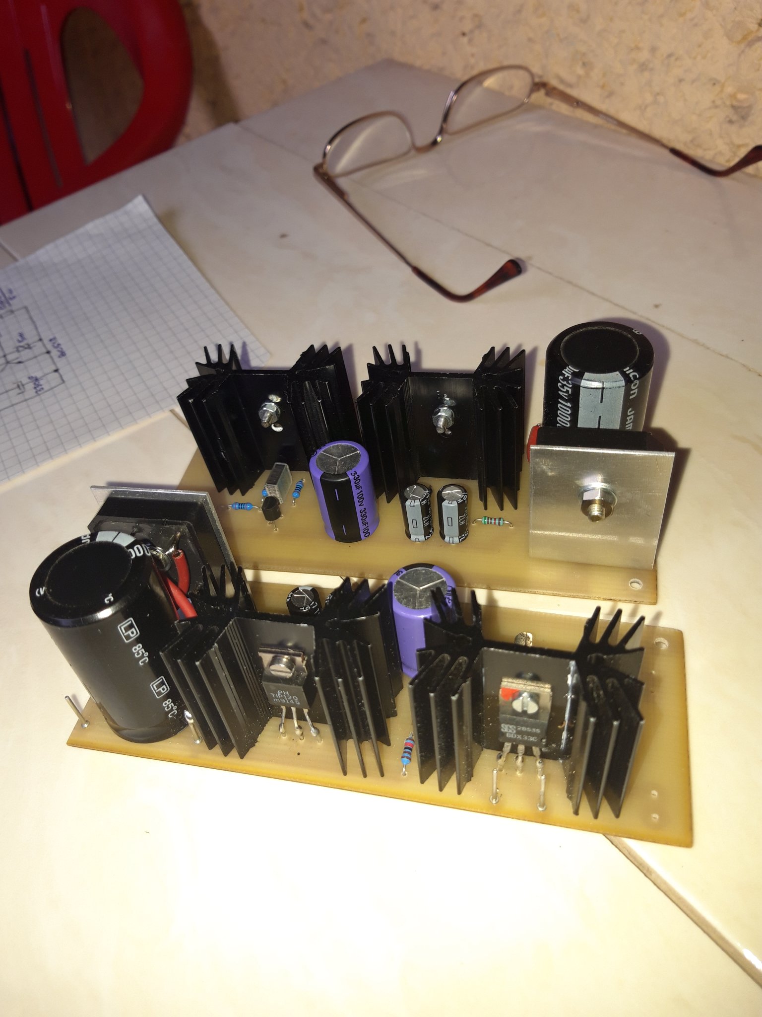

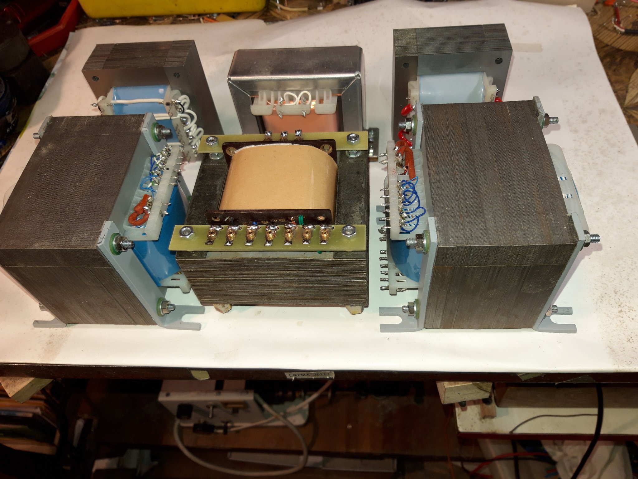

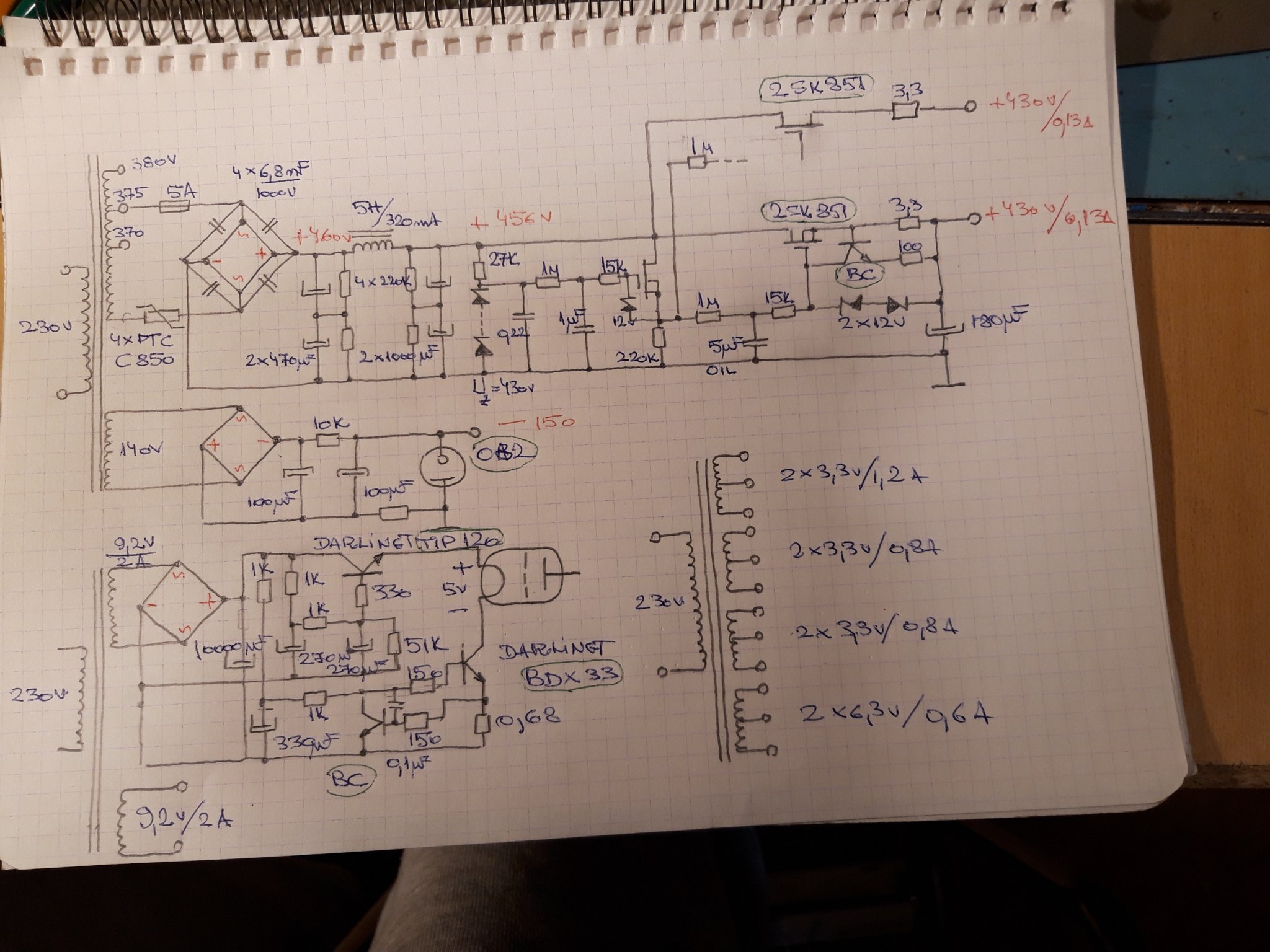

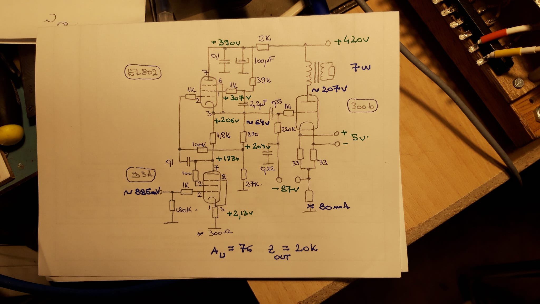

Hi guys, I tested a new SE amplifier with 300b and a mu folower type driver with D3a and EL802, DC final tube filament supply, anode voltage 420v, bias current 85mA, OT impendance-5.2K/8 ohm and a servobias system for bias regulation. All transformers are built by me and soon I will start building the chassis

This is the designed and verified scheme, driver distortion is less than 0.2%/70v a.c. required for 300b tube and amplifier output power is 7w with a THD <3%. Operating stability is ensured by the correction loop of the servobias system and by stabilizing the anode voltage

The output transformers have oriented grain core, 6P+4S+KFB, L=23 H, Llk=5.1mH R=200 ohm, 18Hz/-1dB-52.6Khz/-1dB. For the network transformers I chose the solution to divide the power part on three transformers distributed more easily on the chassis and the shock coil has 5H/320mA/40 ohm
Reactions: 1 users
With some properly implemented GNFB, THD could easily be decreased even more.
