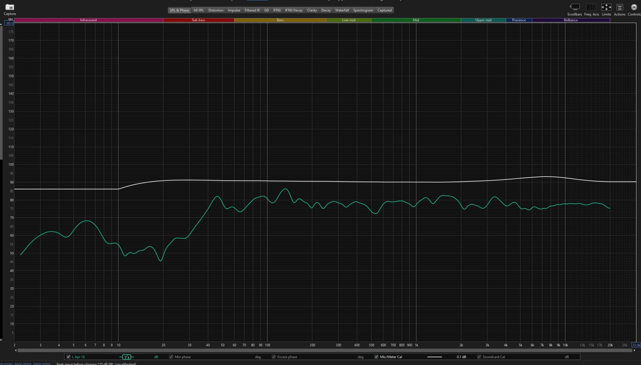

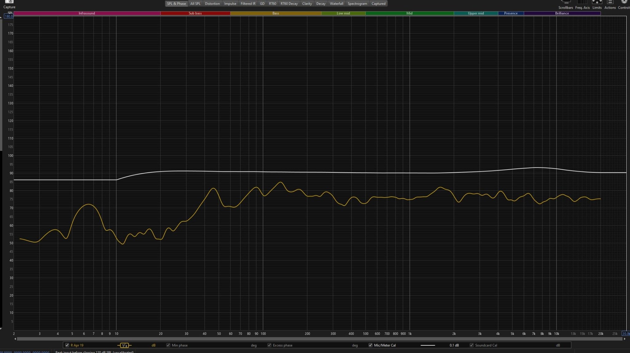

Ran my first measurements in REW yesterday night.
Setup: Umik-1
Running off PC
Amplifier: Dayton Audio HTA20 (20W/ch, pretty clean amplifier for the price (Sub $150).
Cables: Audtek 6'
The microphone was mounted on a dedicate microphone stand and I eyeballed the distance and center for now.
Extremely surprised at the results after 1/6th octave smoothing. For speakers that are over 40 years old.
