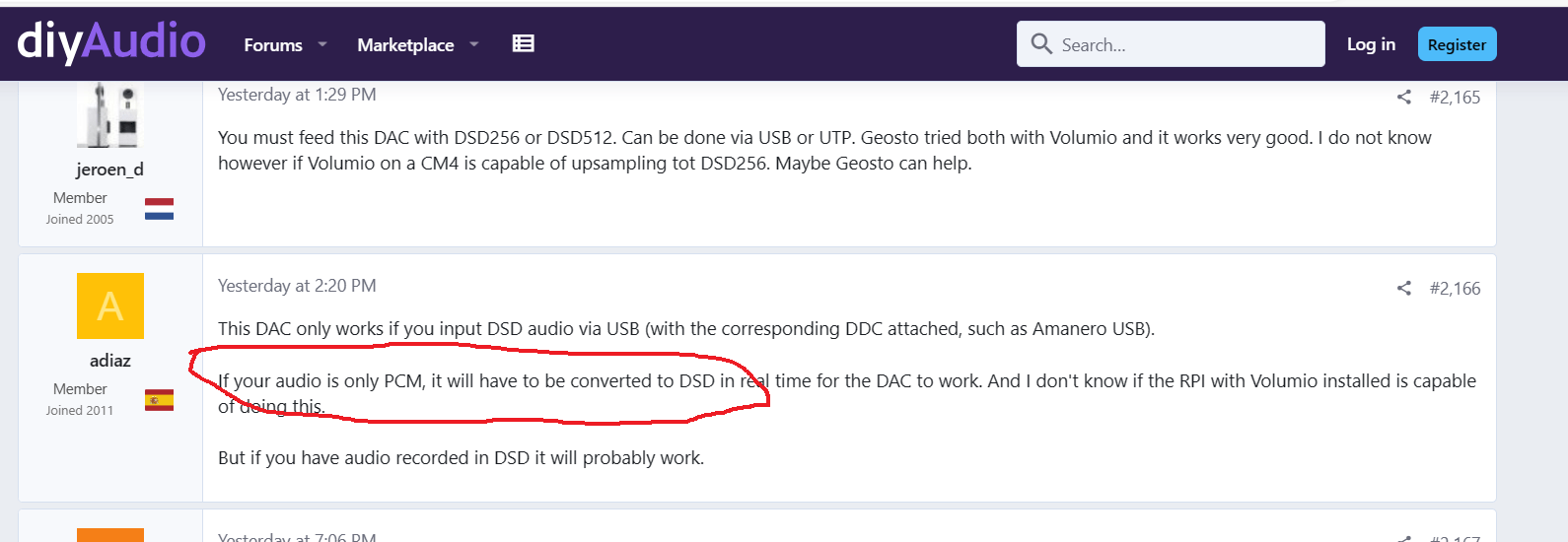

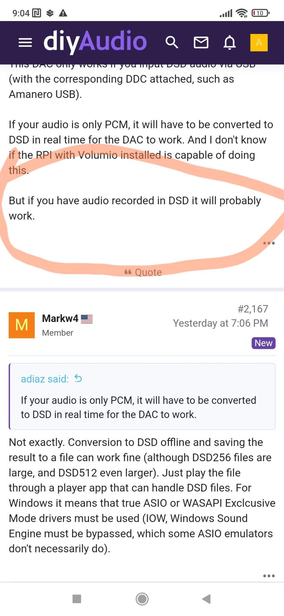

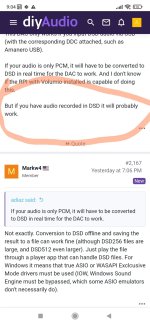

This DAC only works if you input DSD audio via USB (with the corresponding DDC attached, such as Amanero USB).
If your audio is only PCM, it will have to be converted to DSD in real time for the DAC to work. And I don't know if the RPI with Volumio installed is capable of doing this.
But if you have audio recorded in DSD it will probably work.
Not exactly. Conversion to DSD offline and saving the result to a file can work fine (although DSD256 files are large, and DSD512 even larger). Just play the file through a player app that can handle DSD files. For Windows it means that true ASIO or WASAPI Exclcusive Mode drivers must be used (IOW, Windows Sound Engine must be bypassed, which some ASIO emulators don't necessarily do).
Why didn't you read the final sentence of my message?
That is incorrect. It does not have to be done in real time.
You also said:
...if you have audio recorded in DSD it will probably work.
Why only probably? It should work, period. Otherwise something is broken.
In short, your post was confused and incorrect. It was reasonable for someone to respond with correct information.
