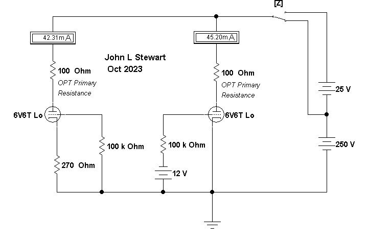

Here is the Sim comparing fixed bias to cathode biased operation on well aged 6V6s with the normal cathode emission dropped by 10 %.
The in circuit fixed bias tube emission dropped by ~9.5% while the cathode biased tube plate current dropped by ~4.1%.
Cathode biasing minimizes the need for bias adjustment. And also protects the tube in case of a problem.
Some might wonder where all the Ls, Cs & OPTs went. Biasing is done at DC, all the reactive components don't do much at DC.
And at DC the power pentodes look like triodes for biasing, even when the plate voltage is higher than the screen.
The important number is the screen voltage for biasing calcs. In a good pentode plate current doesn't change much.
Thats where screen curves are more useful than grid curves on the plate family graph. But watch the plate watts.

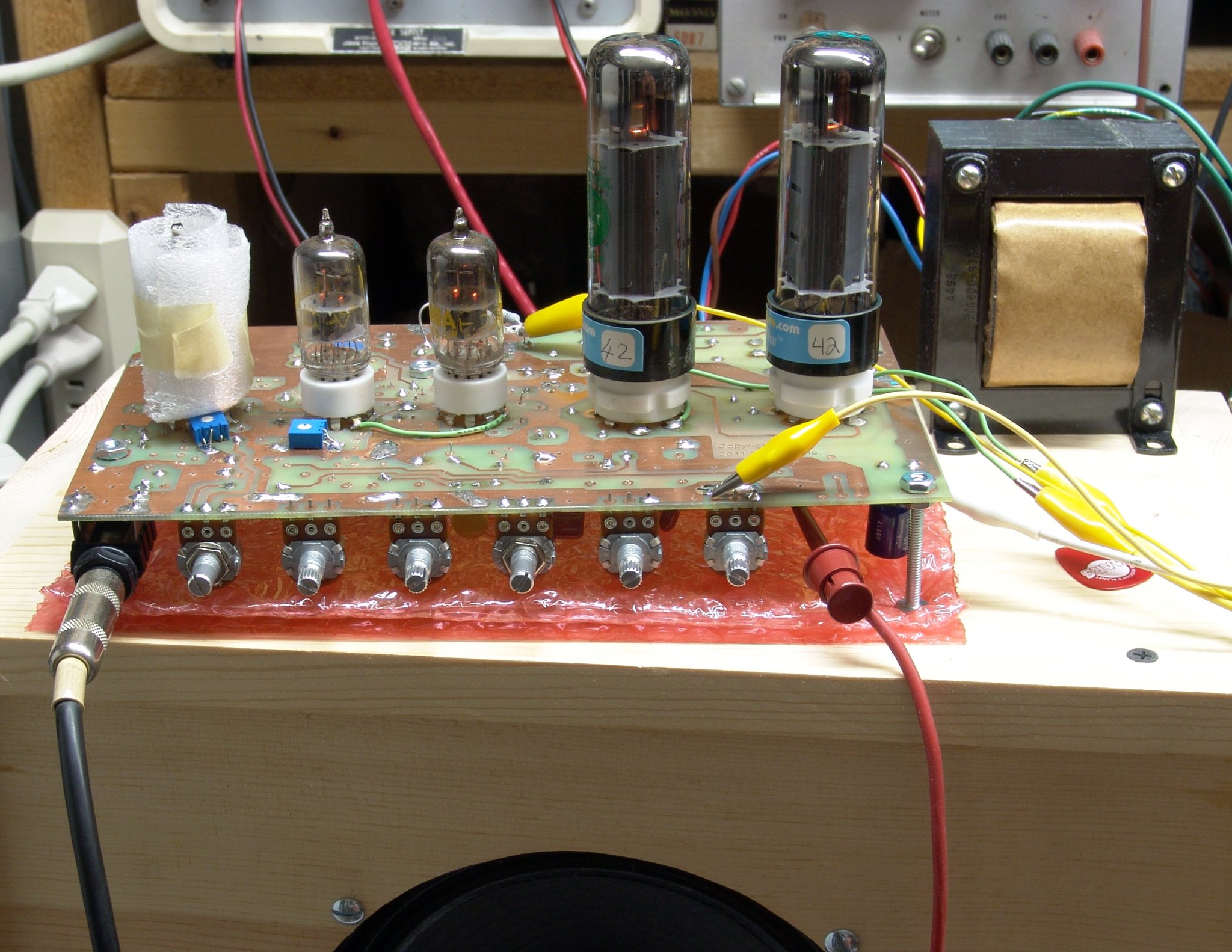

It's amazing how a single forum post can spark up some old and long forgotten memories of stuff I did in the past. Mention of the UL84 tube by Bondini in post #44 reminded me of how I obtained a box full of 6CW5 tubes maybe 25 years ago by stripping a bunch of old HP 200CD audio oscillators for parts. Somehow a pair of those got stuck into an EL84 / 6BQ5 amp to see what would happen, and it wasn't pretty. I mentioned that fact in post #54 and referenced a series heater string guitar amp I had built for the Hundred Buck Amp Challenge thread 12 years ago. I built two complete amps for that challenge, both series heater string designs that used an isolation transformer for power. I even posted some pictures of that amp that are still on my hard drive. I did not give it much thought until I got a request for the schematic. in post #58. It took a bit of digging to find that schematic since I could not remember what I called it. I found it in my Eagle directory, posted it, done.........
I found myself answering a post in the instruments and amps forum about a very simplified guitar amp. I had breadboarded such an amp a very long time ago. The schematic was simple but I didn't remember the component values. Maybe it's time to dig through the "box of broken dreams" where dead projects go to be mined for parts as needed. I did not find the simple 6AU6 - 6AQ5 guitar amp, but I did find a third amp that was started for the HBAC, but never made the cut since I couldn't get the cost below $100 even with some $1 TV sweep tubes. That project died abruptly when all of the 50JY6's disappeared overnight. No $1 sweep tubes, no need for the octal amp board. It hit the "box" while the 9 pin version went on to be a real guitar amp.
Now that I have the 12 year old PC board in my hands I remember hacking it up to run 6 volt tubes and stuffed some EL34's into it. I think it wound up in the "box" when my job at Motorola ended and we had to start packing for a big move in 2014.
I have now found the Eagle directory and ONE picture. Will this be enough to bring this old relic back to life? If so, I'll start a thread in the instruments and amps forum or wake up the old HBAC thread.

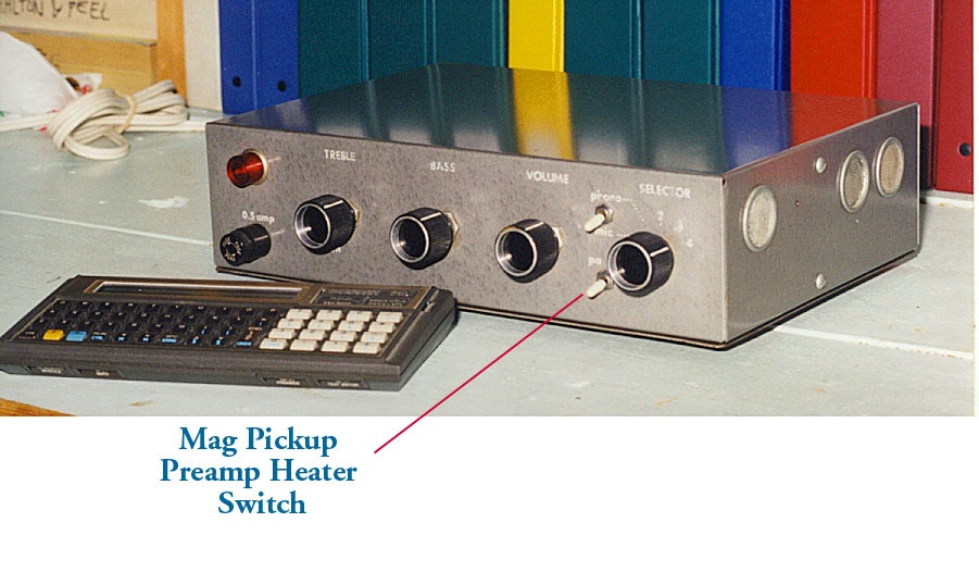

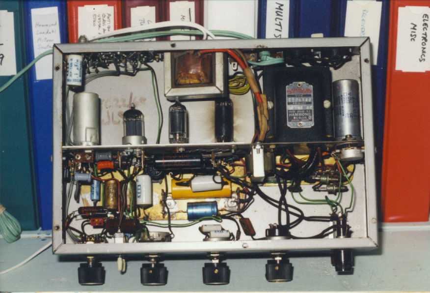

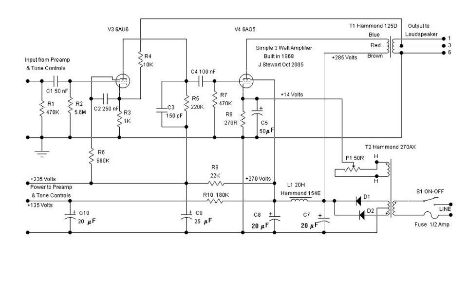

Somewhere in this thread an SE amp of 6AU6/6AQ5 was mentioned.
Here is mine from 1968, a complete amp with PS, Baxandall Tone Controls & a front end for mike or GE VR Reluctance phono vinyl pickup.
ALL jammed inside a Hammond 8x12x3 chassis, There are ventilating holes on the bottom & sides.
The front end 12AX7 heater can be shut down when not in use.
The calculator is an HP 71B, it runs in BASIC, (y)
There is a thread in the instruments and amps forum where the OP asked about a minimalist guitar amp that used a 6AU6, 6AQ5 and a 6X4. His circuit was missing a few vital parts, so I mentioned them, and posted the schematic for the 5C1 Fender Champ which used a 6SJ7, a 6V6 and a 5Y3. I breadboarded an amp similar to the Champ with a 6AU6 and a 6AQ5, went looking for the old breadboard so I could fetch the parts values, but could not find it.
https://www.diyaudio.com/community/threads/6au6-6aq5-6x4-amp.404812/#post-7497168
