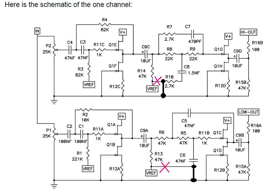

Capacitors C6 and C8 prevent any DC current from flowing, so why not return those "legs" to ground? No matter how low is the noise level on VREF, the noise on ground is even less.
_
