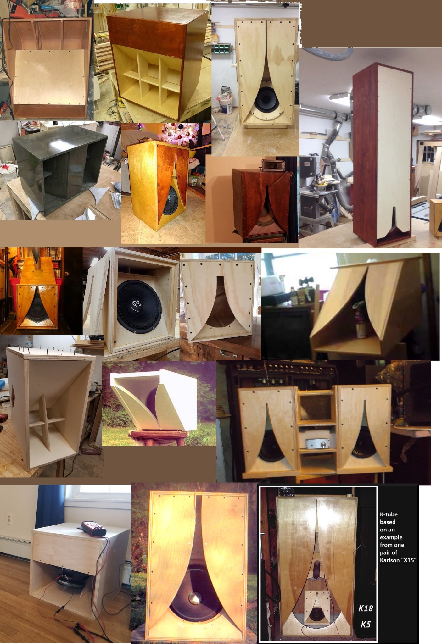

the original Karlson - K15 (rules the roost w. good coax and solid-scrape) - not sure which FR would be best - you could try Fane 250 12" on an adapter ring retaining the cutout for 15" drivers. Brace the back - run short dowel's from K15's front shelf to the wings for front bracing. Star with 40.5 sq.in. port - narrow to taste (full width may be best.
GregB's Karlsonator 12 is tuned to 37Hz and will milk the good from 12LTA - K12H-200 - probably good with the real bargain ($69) PRV 10FR300. Add a JBL ST200 super tweeter to all of those.
Karlsonator12 pic is 3rd from the left in the top row - Jesse has that one loaded with a BG20 (too small a driver for that cabinet)
