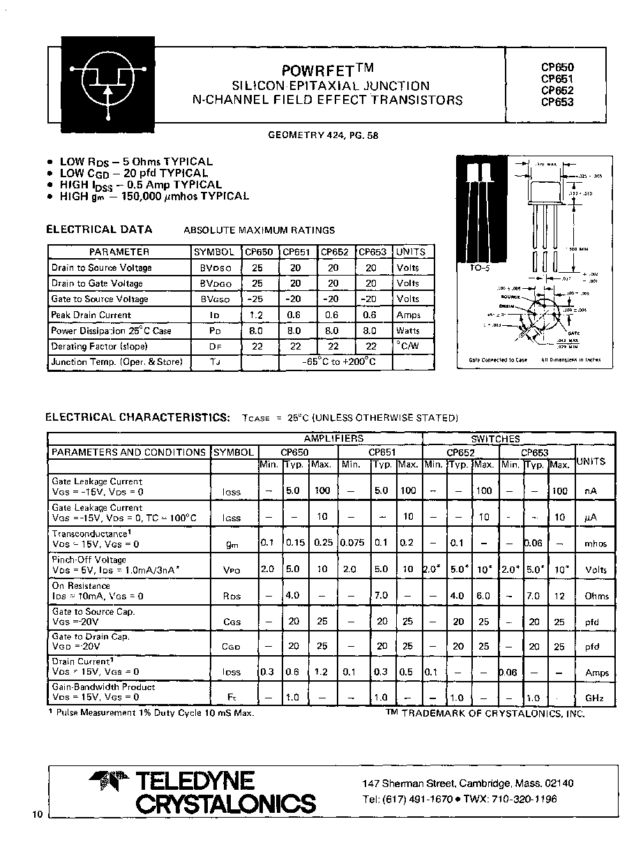

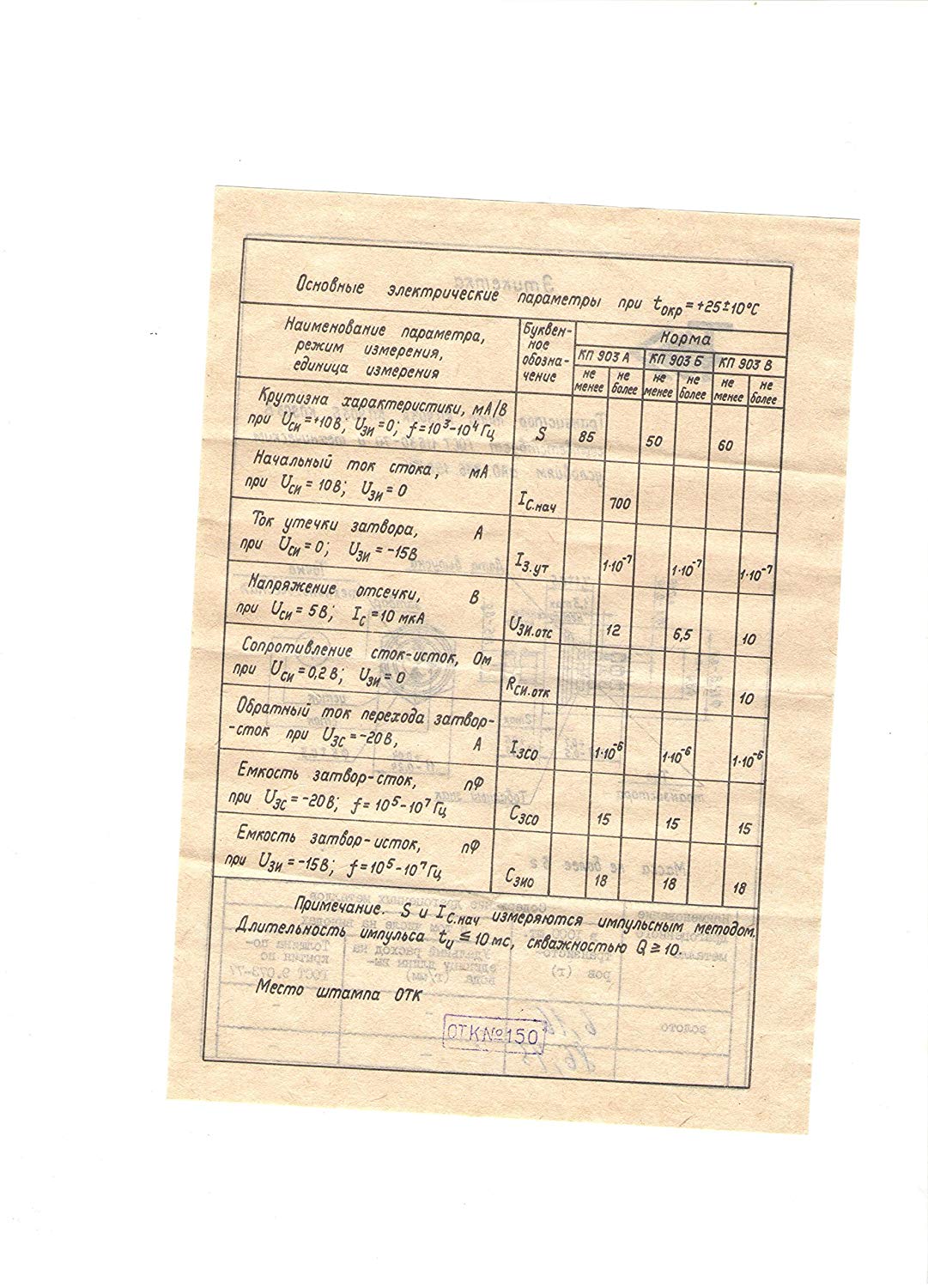

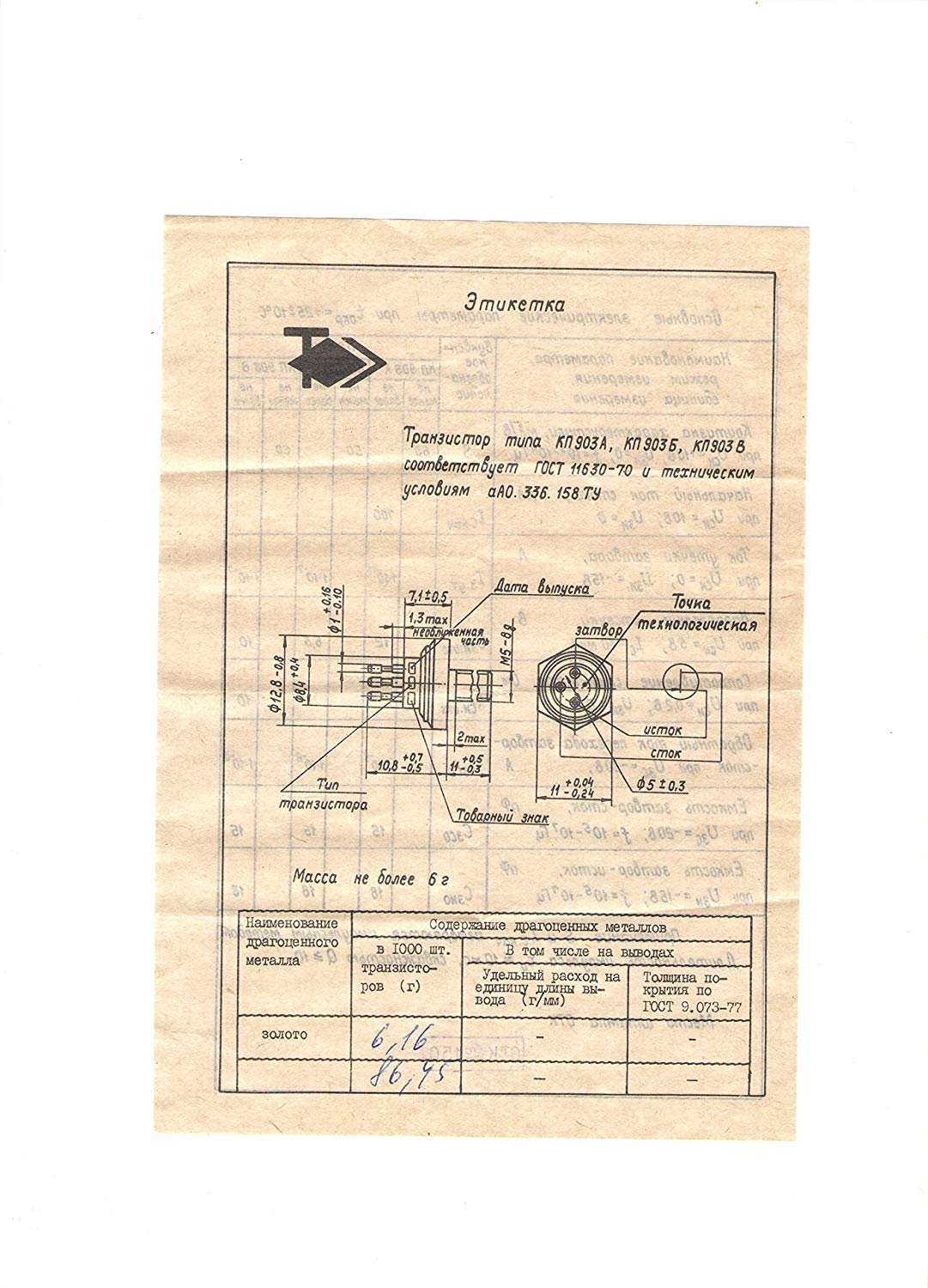

Spice model for Russian KP903A JFET?
I managed to find the datasheet, is anyone able to decipher this and produce a Spice model from the data?

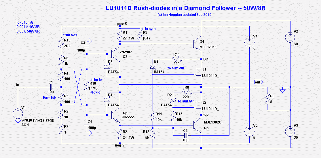

Hi Ian,
I designed this one for Pawel
IansEchoAmp - Google Drive
and simulated it for proof of concept, distortion and power dissipation checks. I haven't made one.
It uses a floating +/-5V supply. It can be changed to a stage with gain by grounding the 5V centre rail and removing the ground of the 40V center rail (ie floating 40V rails). The Area=2 means two in parallel for 100W. For a 50W version use only one.
I can share the LTspice file if you want, also my LU1014 model I created using the VDMOS for a better fit to the datasheet (you can see how I added param Mu=10 using a VCVS).

Kp903 is an amazing device ! I have tested 2 dozens in various configurations and it is truly superb, especially in line amplifier duty. But there is a catch, unfortunately part to part parameter variation is huge by any standards! My fets were bought from 3 different suppliers and parameters were off by a 50%! This makes the parts unusable. Though for some applications you can find 2-3 matching pairs for a line amplifier let’s say.

Hi Ian,
Thanks for your interest! It is an unusual design. No global feedback.
Like any follower it needs a high voltage driver amp (30V peak or 20V rms).
The floating 5W supplies may be off-putting to many but...
I'm thinking a 2W +/-5V DC/DC for each ch would then allow 1 transformer for a 2 ch amp.
The 5V rails need to be regulated.
Attached is an updated design with LTspice simulation files.
My updated LU1014D subcircuit model can be found in this file.
BTW I don't have any LU1014D's yet to try it - I'll get some in next order.

Hi Ian,
2SC3263/A1294 should be fine.
I have done some further design work ready for a bench trial. I have written a paper explaining the options for making a practical 50W or 100W using this arrangement. It is here IansEchoAmp - Google Drive
It will take a month or two before I can try this amp.
I wasn't aware the LU1014D had gone extinct :eek: I intend to use MOSFET's instead of LU1014 jFET to try it. Are you still interested if there are no longer jFET's in the amp?
You can still use the LU1014D's but I won't be able to verify the circuit first. You will only have simulations modification to go by if you make one.
