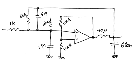

Right. Shoot-through.
The diodes on q5(?) and q11 won't be very effective... It's a baker clamp. You need a lower forward voltage than that of the cb diode of the transistor ie one schottky. Not a standard pn diode and certainly not two. The simulation won't catch this because recovery isn't very well modelled in spice.
Simulate one single driver with a mosfet with an ohmic load to get a feel for the kind of resistor values you need. Hint: only the 10 ohm resistors are correct.
Look at the gate wave form. If you want to prevent shoot-through the gate waveform should fall quickly.

Self-oscillating amps are indeed liable to produce intermod tones. So far we've gone up to 5 channels x 100W crammed on a single PCB. The layout is a ***** but you can get the tones below a few tens of microvolts, which is acceptable. Besides, if you're a hobbyist - who cares if you try the water with mono blocks first?
A propos of this thread, Jan-Peter was wondering if the SODA modulator couldn't be released into the wild by now. I guess it can. It isn't nearly as good as the current state of the art UcD but I can't give you that yet of course. On the other hand it's already got one important thing: post-filter feedback. A disadvantage is that it doesn't like to be clipped without load. I'm leaving it up to your own imagination how to detect if the amp's gone oscillating at fres, but simply disabling and re-enabling the power stage is enough to get it back onto its feet.
