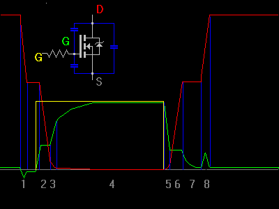

I said I would explain it later...
MOSFETS have high capacitances between G, D and S : 'Cgd', 'Cgs', 'Cds' as shown in the drawing. These capacitances couple to the gate everything happening in the drain
1 : Negative transiet coupled fron drain to gate throug Cgd
Before 2 : Some dead time. Then, gate happily charges until the thresold voltage is reached and the device starts to turn-on
2 : Gate charging, Vgs does not increase mostly because Vds is decreasing and this robs through Cgd most of the current supplied by the control circuit until Vds stops decreasing
3 : Rds-on is further reduced due to Vgs is increase
4 : The device is fully turned-on
5 : The gate is happily discharged until Rds increases enough to cause Vds to start rising [the device is no longer enough 'saturated' to be able to conduct all the current flowing through the inductive load]
6 : The rising slope on Vds robs again through Cgd most of the current provided by the control circuit. This phenomena provides a quasi-constant Vds slope that depends on the magnitude of turn-off gate current available
7 : The gate is further discharged, this process is slow since gate capacitance for low Vgs is higher and the resistor that discharges it is conected to ground [or worse : to one or two diode drops above ground]
8 : The device on the other side of the primary turns on causing a fast rise in Vds of this device. This fast rising slope is coupled to the gate through Cgd and tends to turn on the device again. This is called 'parasitistic turn-on' and must be avoided

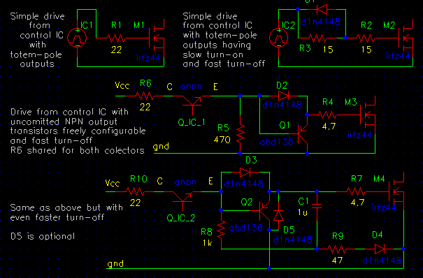

tennisballg :
Your captures suggest you are suffering some degree of parasitistic turn-on. Look at the drain waveforms, they bounce up and down just after turn off of each device. Thiere shouln't be any bouncing at all
Try adding some RC damping to the primaries and look if bouncing is still there [It could be transformer resonance but it's less likely]
Then, try adding another 2uS of dead time and see if bouncing is stil there. If adding dead-time cures the bouncing then you should use higher dead time or speed-up MOSFET turn-off and reduce the impedance seen from the gate to ground to help reducing the positive spike coupled through Cdg and eliminate parasitistic turn-on
