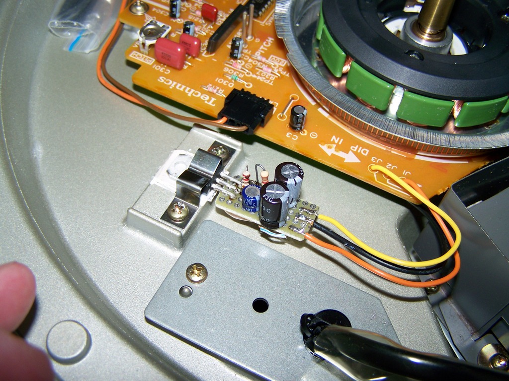

This is stage one of my PSU modifications, a different regulator of some sort will be next....
EDIT - and here it is:
After reading this fantastic article - Using 3-pin regulators off-piste: part 1
I have installed the first LM317 based regulator in my SL-1200. There is not a specific schematic in the article, look at the one on page 1 of the 'off-piste' article, and all you do is replace R2 with a Zener reference and make sure you include C2.
I did mine point-to-point and covered up all in heatshrink as I don't want anybody copying me directly, as it's a point-to-point salad of wire and tape. Do as I say, not as I do and all that...
It works wonderfully, sounds great, and took about 15min to install.
Here it is... not particularly exciting.
Lift the motor PCB and remove the old pass transistor and wires. (You could just cut the old wires and splice if you desire)
It mounts in the same position as the old transistor.
Don't forget some kind of insulator under the regulator - the old transistor was a 'full-pack' and did not need an insulator.
The regulator needs to be grounded here, at the turntable center ground.

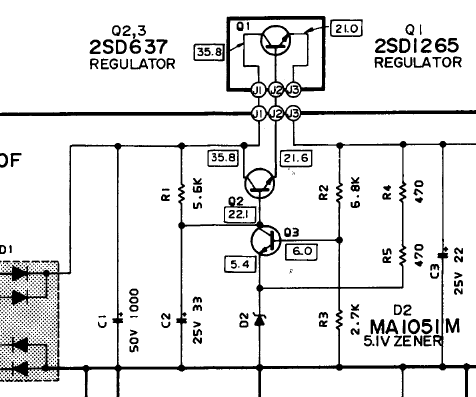

I've done this mod to my 3 MKII and i'm really happy. It sounds better than stock. If you want to keep the light and strobe and still bypass the internal supply including the regulator, remove the wire that leads from the emitter of Q1 to J3, and connect 21VDC at J3. This is how I've done it.

I will bypass the internal regulator, and replace it with something different in the same position. The mount for the pass transistor can be utilized for heat sinking and the existing wires connect the regulated voltage at the proper location on the PCB.

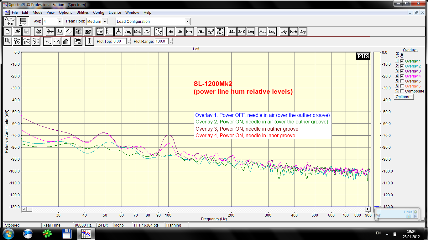

I changed power regulator to classical LM317 circuit as a first step of PSU upgrade, it very simple and took 1 hour. Unfortunately, I didn't make audible comparison, this replace was done right after I bought my 1200Mk2.
But such upgrade doesn't affect to transformer noise, see second picture - I tested 4 variants (needle in air and on the LP, power On and Off). Obviously 50 and 100 Hz are transmitted via chassis as a mechanical vibration. So, I think that external PSU incl. transformer is absolutely right and necessary upgrade.

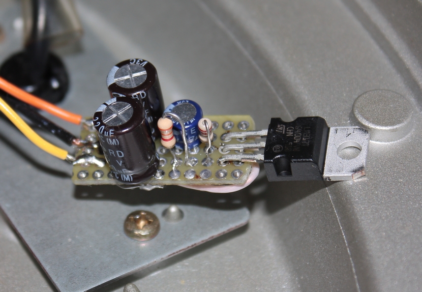

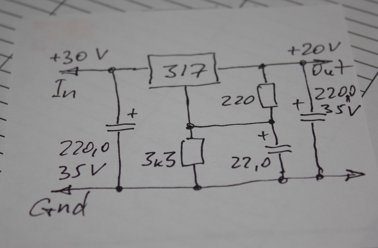

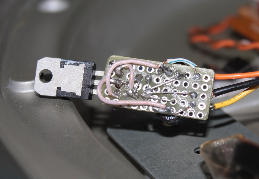

Khom - Do you by chance have any more photos or a sketch of your perfboard layout you used for the 317 circuit? I would love to make one just like that.
Yes, of course. See attached photos:
1. Schematic. It's simple datasheet schematic calculated to 20V output DC.
2. and 3. Top and bottom of board, all connections made by parts leads and some additional wires. I didn't created printed board. To connect you can use old YELLOW and ORANGE wires (J1 and J3 - see original schematic 4.), ground wire (BLACK on my pictures) should be added and connected into Tech PCB in any suitable place near power regilator. Do not forget to isolate LM317 from chassis (I used thin mica strip)!
However I still think that the best power solution for Technics is combine of an external PSU with transformer and improved internal regulator like this or something similar.
