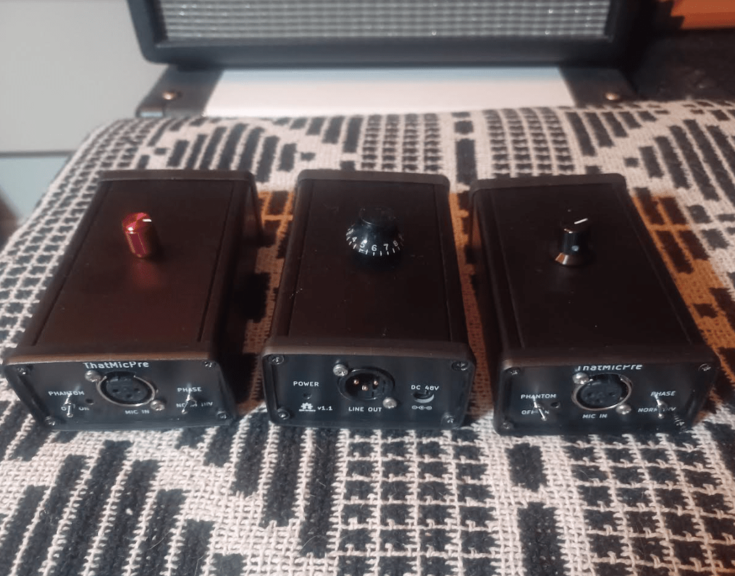

Awesome to see some new builds since the last time I checked in!
My end panels arrived and now my units are looking like some legit name-brand pres :love:
Thanks again for sharing these ojg!

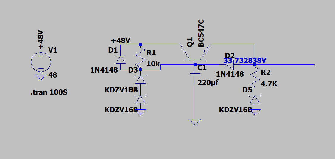

Dear ojg
Is D15 D16 D17 18V Zener regulator? I have roughly simulated your power supply circuit with a similar Zener regulator. You can get about+33~35V power supply, which can meet the demand of single power supply. Is it possible to add a voltage follower to generate a ± 15V~± 17V power supply?
Correct! D15 and D16 forms a zener regulator with Q2 as the pass transistor to make a 35V supply for the THAT1510.
D17+C18 creates a stable mid-supply reference, so there is no need for a +-15V supply in this case.
All that is needed is a single 48V supply. You can also use a single 36V supply, then the phantom-power for the microphone will be lower than normal, but most microphones will handle that just fine.

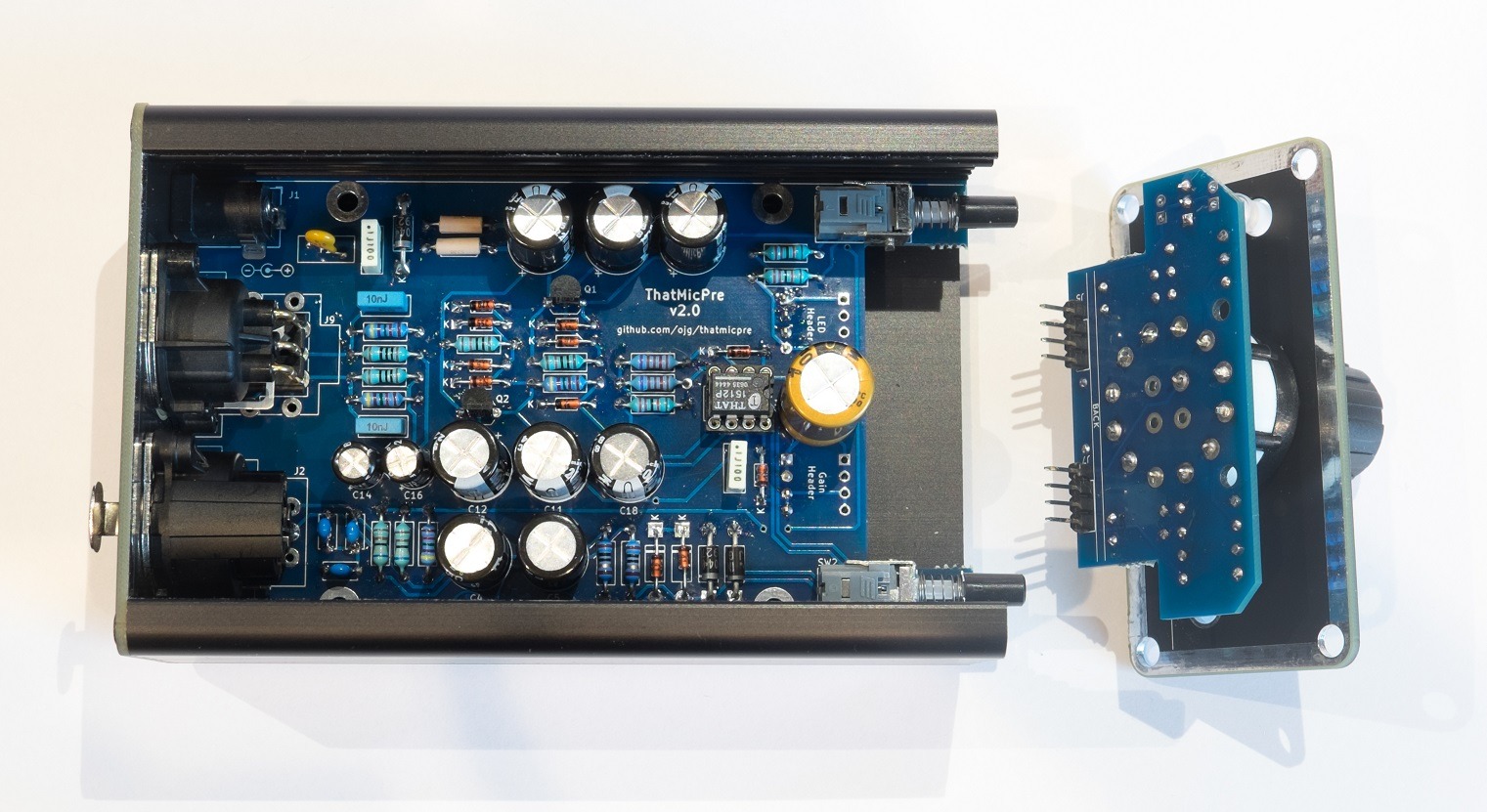

New rackmount version available!​
Finally got around to build the new rack version. Happy to say that the mechanical fit was good, so I went ahead and built the rest.
As you can see there is now a separate sub PCB for the front panel which the gain switch and gain resistors are mounted to. There are female angled single-row pin headers underneath the main PCB, and regular pin headers on the front-panel PCB that connects them.
The circuitry is otherwise almost exactly the same as the desktop version, and there are no measurable differences. This one I built with the THAT1512, and it measures exactly as predicted in the datasheet.
Documentation on github is updated.
Happy building!
OJG

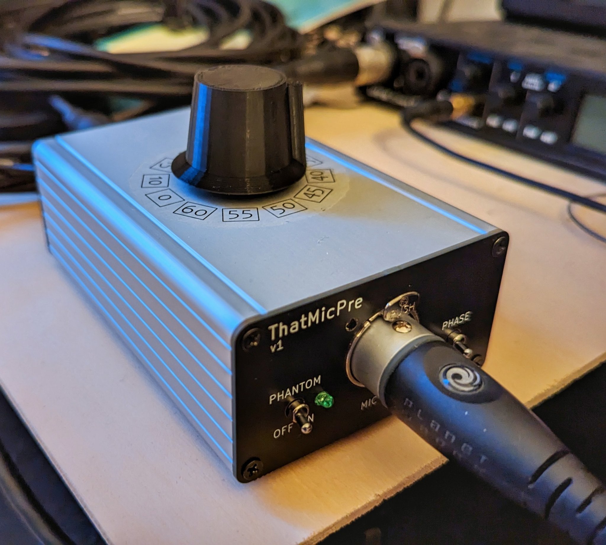

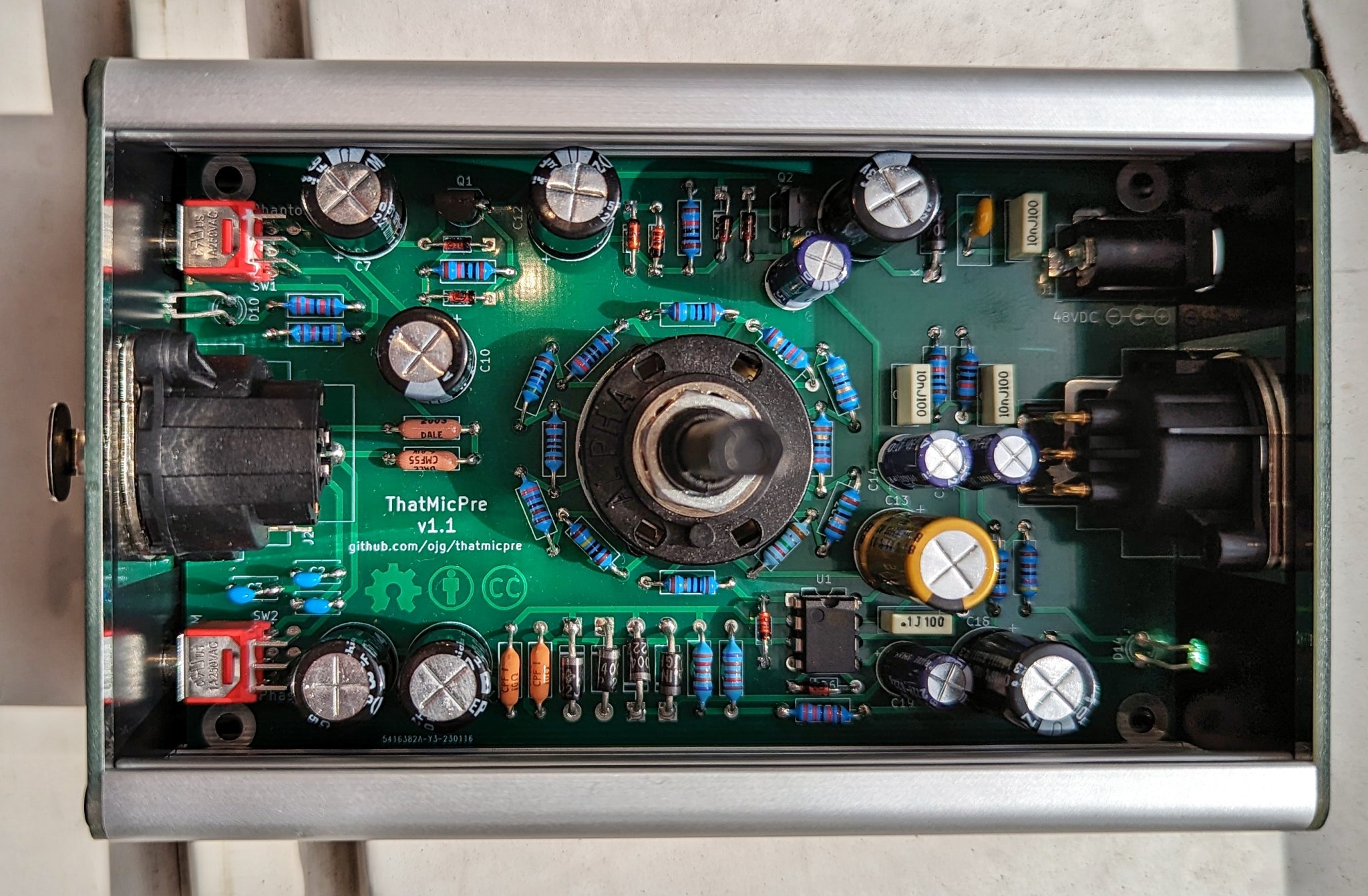

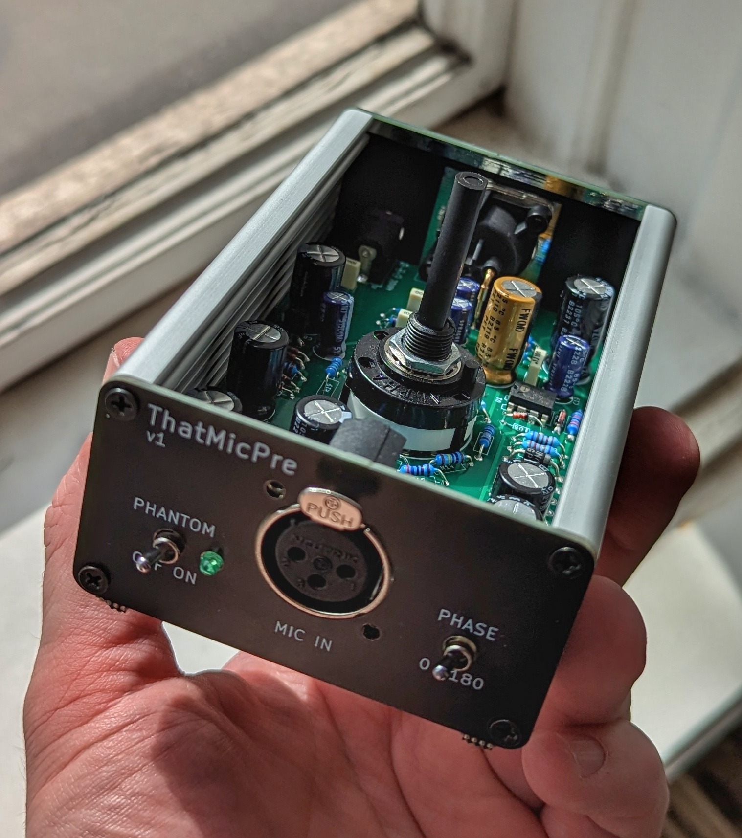

Hi everyone!
I just got done building v1.1 a couple of weeks ago and finally got around to making the first recordings - it's working perfectly! Now I finally have a preamp for my Shure SM7B since only one of my audio interfaces has a strong enough preamp to record it properly.
To be honest, I'm actually surprised that I apparently didn't make any errors, what with my soldering skills... Thank you so much, OJG!! This was an awesome project to build, the PCBs are spot on, also together with the Hammond case.
Do you have any plans for creating any other open hardware audio equipment? Or do you guys have any recommendations for other projects that are as well-documented as this one? I'm kind of hooked...
Here are some pictures (the knob is still WIP, I need to print another one that's less clunky..):
Again - thanks for this valuable new piece of equipment!
Joachim
Thank you for posting your build, it looks excellent! Black-on-silver looks good!
