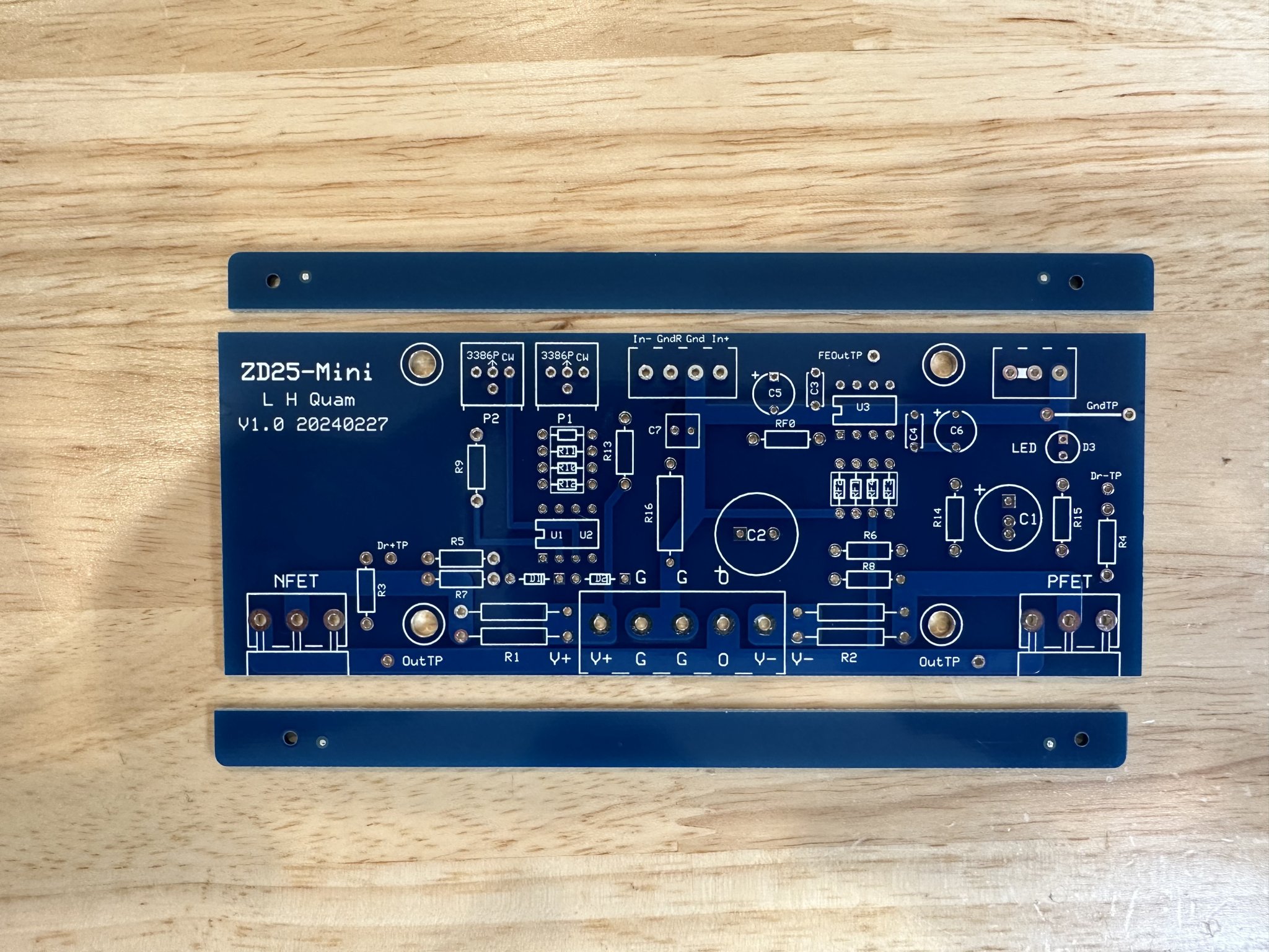

Although this is a different output stage, I believe the IXTQ26P20P will also be a good match in the ZD-25 output stage. I will assemble an amp once a couple pieces of aluminum stock arrive from OnlineMetals.

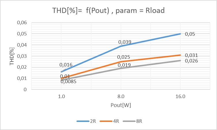

The front end gain set to 12 with R3 = 120k, R4 removed and OPA551 replaced by an OPA604 from my old stash and a quick THD check vs. output load done.
Yes, I did two changes at once thought it would be fine and really it is.

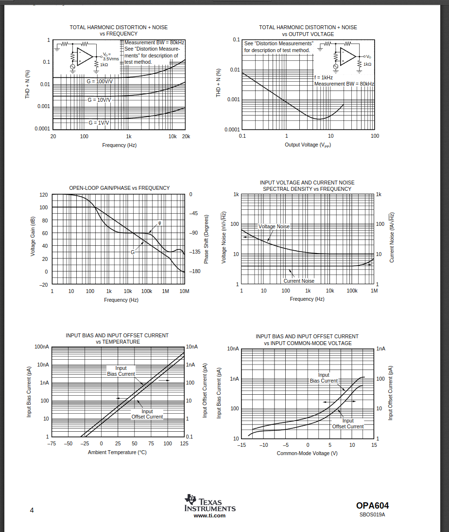

Looking at the OPA604 datasheet, the output voltage swing appears to be limited to +/-12V. Looking at the plot, how to do get 16W into an 8R load which requires a +/-16V swing? Maybe I misread the datasheet.

But one thing is certain, with +/- 23.5V rails the OPA604 is able to fully control the OPS up to clipping without distorting.
I stopped testing with 16W because the power resistors got too hot and I didn't feel like waiting for them to cool down again

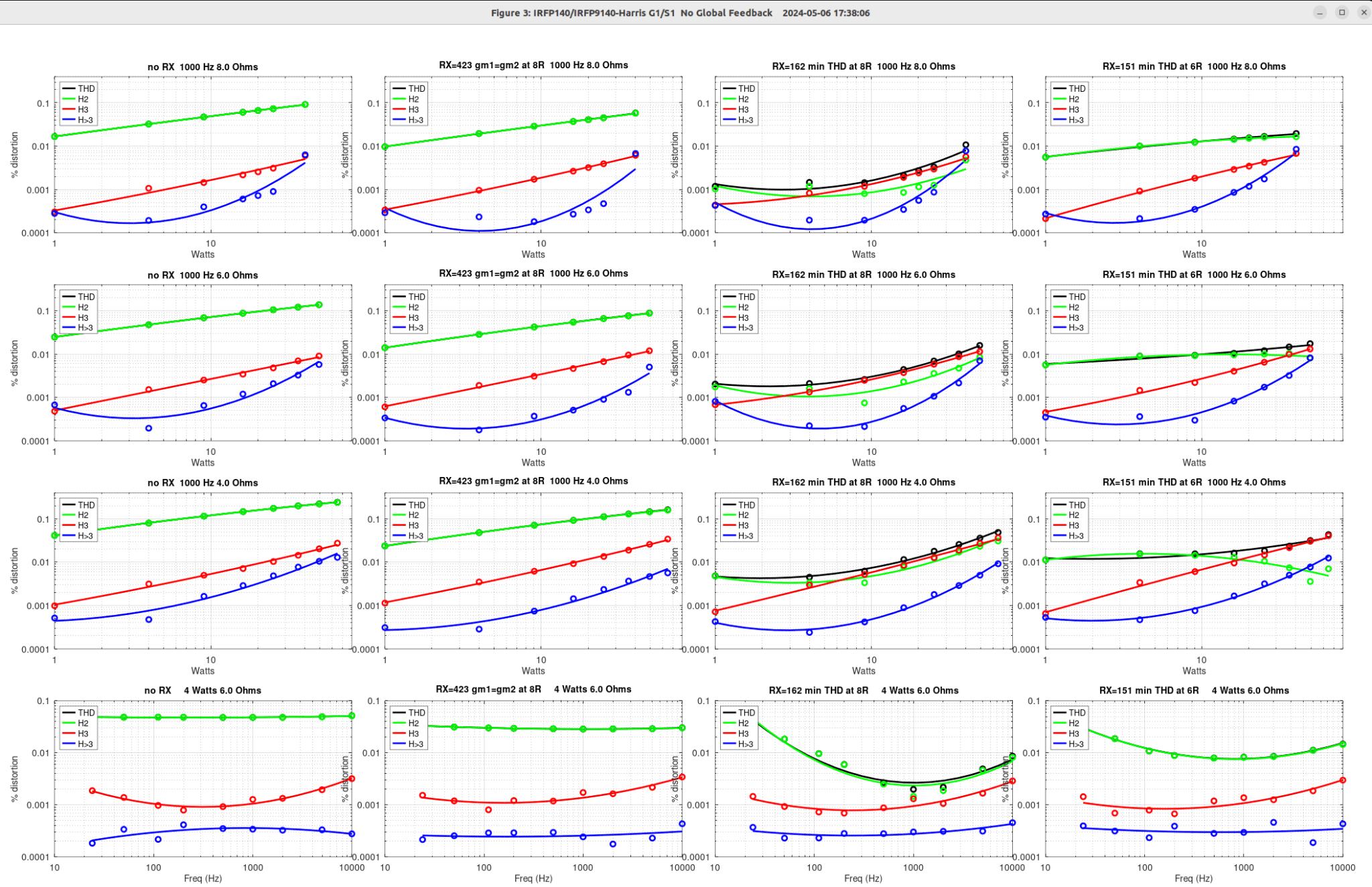

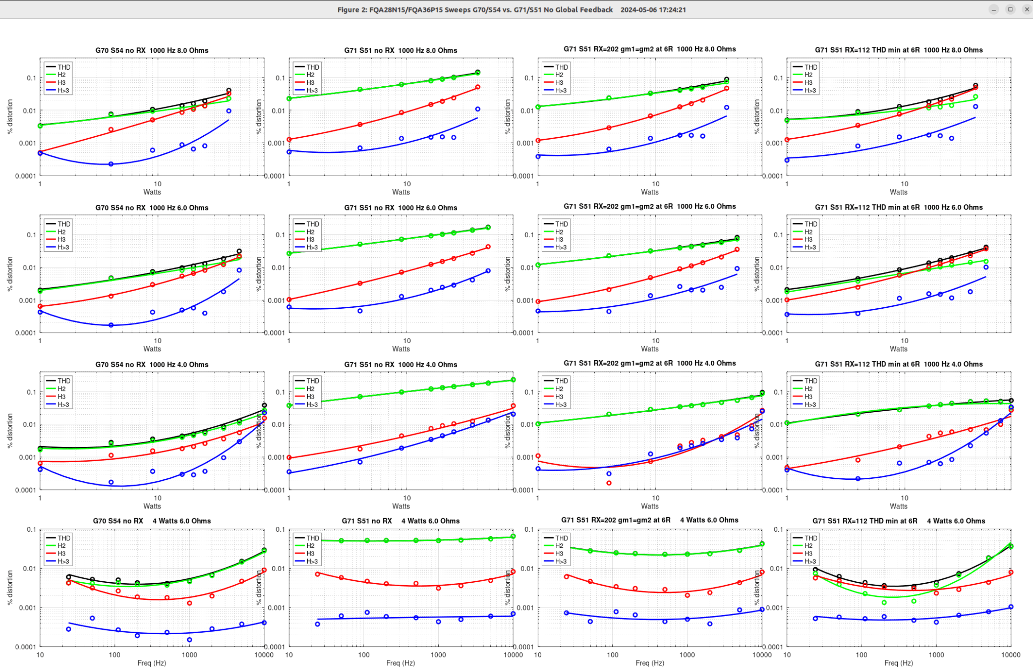

I finally obtained a set of well controlled distortion sweeps of the FQA28N14/FQA36P15 and IRFP140/IRFP9140(Harris) FETs.
Bias Current: 1.25A, Rail voltages: +/-28.8V. No global feedback.
The first image shows sweeps for the FQA28N14/FQA36P15 FETs.
- The first column is for a pair of "nearly perfect" gm matched FET G70 S54 (gms 4.31S 4.35S).
- The remaining columns are for highly mismatched FET pair G71 S51 (gms 4.44S 3.52S) with with differing settings of the RX pot.
My conclusions:
- The RX pot modifies the second harmonic (H2) but has little affect on the other harmonics.
- Adjusting the RX pot for minimum THD (and H2) result in harmonics similar to best matched FETs.
- But: Is reducing H2 important when the absolute levels are so low: THD<.1% without global feedback?
Nothing wrong with giving people options. They could try it themselves and see if they like. Otherwise what is a little H2 among friends. 🤣But: Is reducing H2 important when the absolute levels are so low: THD<.1% without global feedback?
