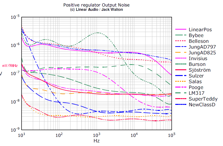

Have anyone measured the output noise in Vrms of the bib? what is the measured output noise?
I see the nv/SqHz I agree its bandwidth based calculation but did anyone measured it on the Vrms wise? Do you see a short noise band on CRO with 1mv per division setting?( As I have a CRO which can go till 1mv/div at best ).
Can anyone reply on the noise measurement please?

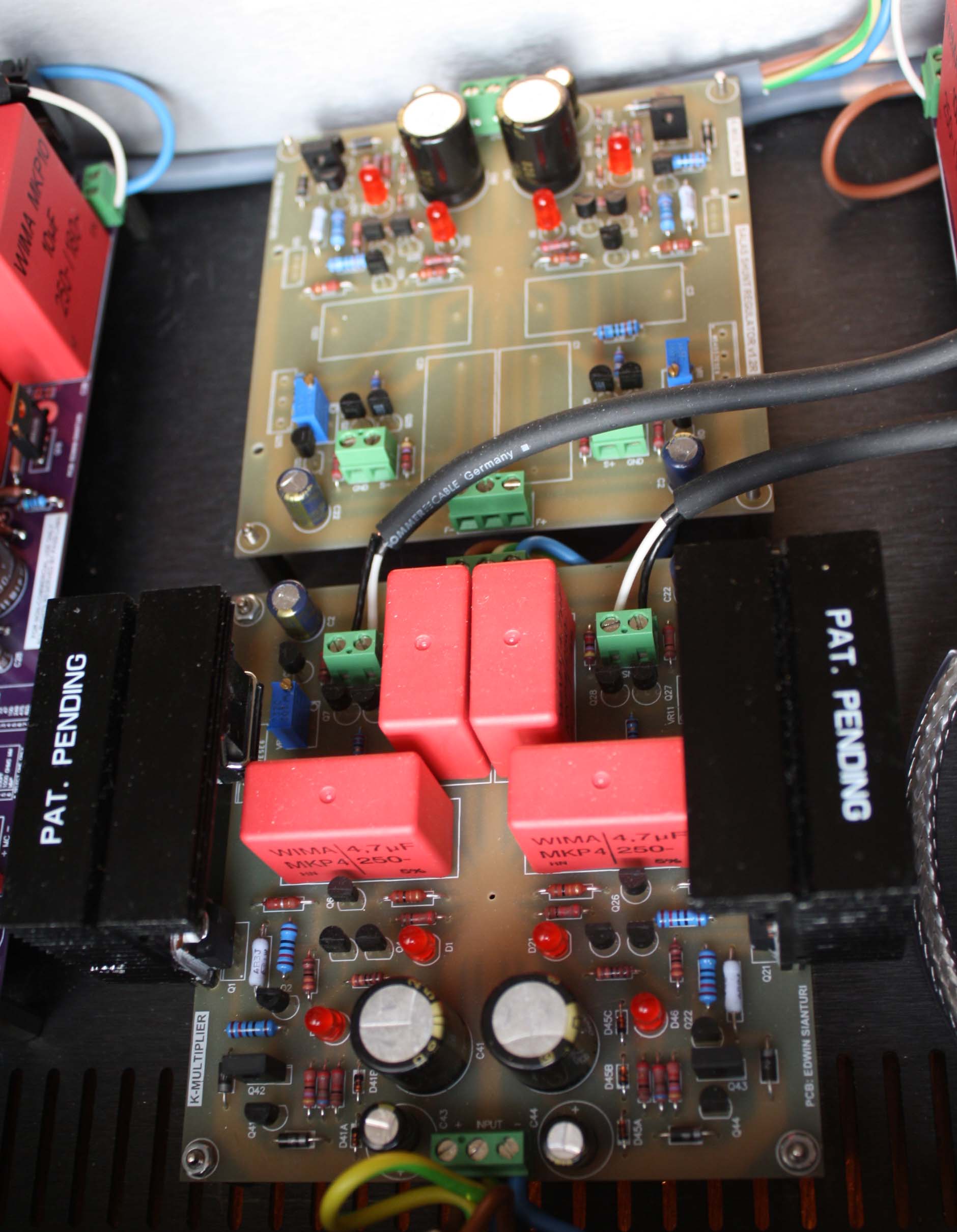

Bipolar Salas V1.2R + Keantoken Multiplier and some measurements

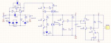

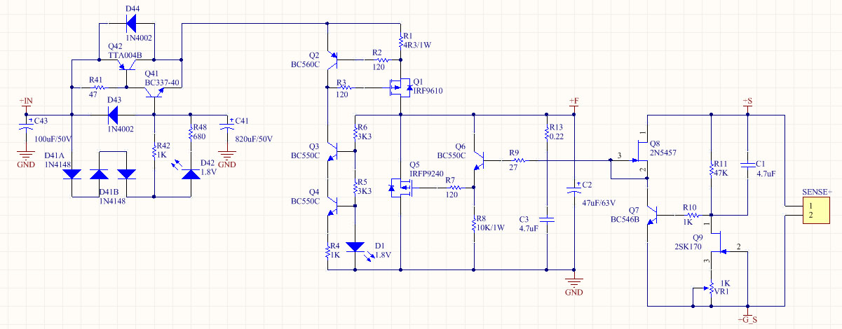

I made a version of V1.2R for +30Vdc and -30Vdc, coupled with Keantoken's Multiplier (K-Multiplier) for powering Aleph (X)Ono phono (clone) stage. Here's the circuit (only +30V shown):

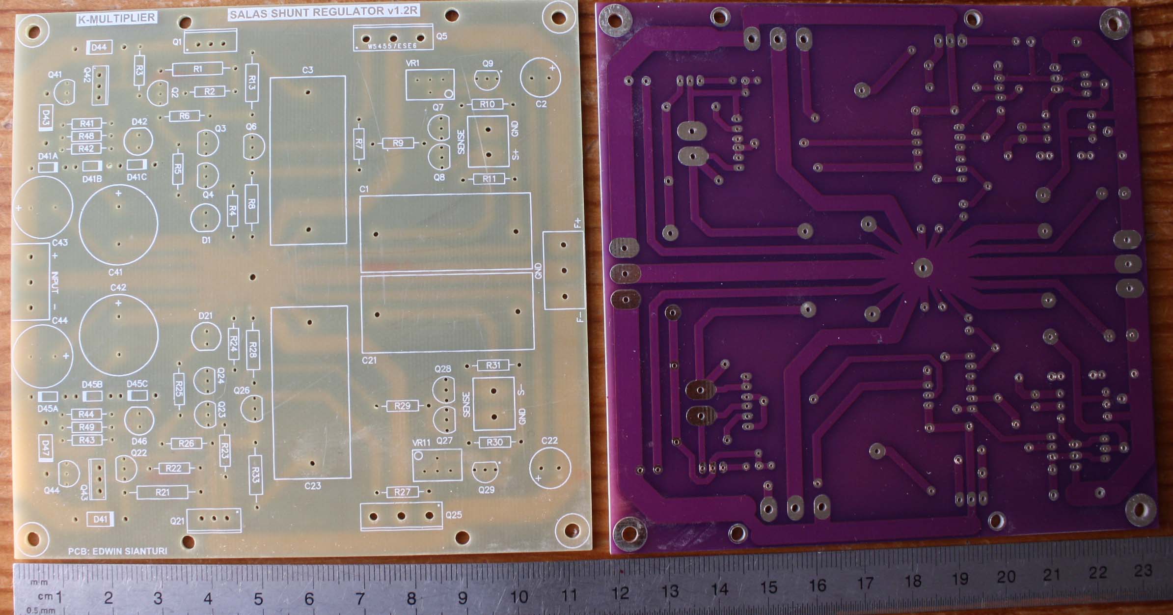

And the PCB:
Here's the populated PCB:
The input of this regulator is fed with +40Vdc & -40Vdc, coming from a C-R-C full-bridge rectifier.

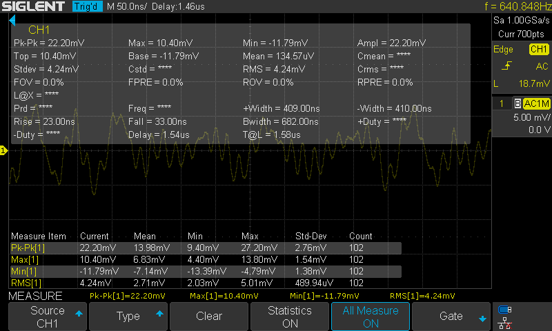

I measured the peak-to-peak ripple at the input of this shunt regulator (+40V only):
And at the load (+30V only):
Measurement at the load was performed with the aligator clip (for ground) and the probe tip (for +), since I'm using the 4 wire Kelvin connection (the + and GND terminal is separated a bit long, about 4 cm), so I think I picked up some additional noise there.
Measurement at the input was performed with the oscilloscope's ground spring.
Comments and suggestions are welcome.

Scoping at the output should show a flat line. Maybe thickened by random noise but no ac patterns. Try two wire output mode too by linking F+ with S+ locally at the output connectors. You already have no separate F0s, but a star? That's not in the design. Maybe its half sensing over a wide loop area now and picks much noise (if it is not oscillating).
Hello Salas,

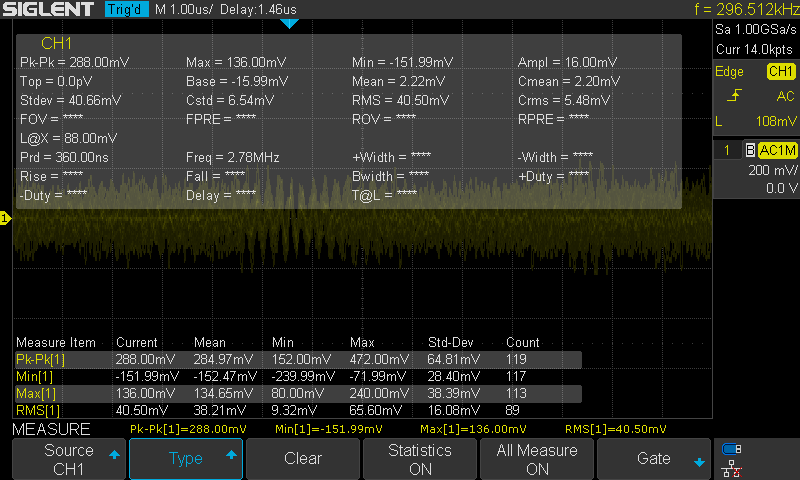

I measured again the 30V+ ripple. This time I set the oscilloscope in "normal mode" (before, I used: detect-peak mode) with 1X attenuation probe. I set the horizontal scale at 50us/div. I could see it is indeed a random noise. But the peak-to-peak amplitude is about 12mV. This is too high, right?
I tried using 2 wire method (connecting Force and Sense directly together at the regulator output), but still the same. So is it oscillating??
About the PCB ground star, I merely copy the Bipolar design for V1.2 shown in the post#1898. But anyway, I added K-Multiplier before the SSLV....
I'm trying to debug my regulator. Perhaps, first thing I do is to test only the V+ section (while disactivating the V- section) to see if the use of common F0 is the root cause? The load is aleph Ono (current consumption is about 110mA for the V+).

If it does not have a distinct AC pattern riding on the line it isn't oscillating. 12mV thick line is too thick for random noise unless it is not coming out of the build but its picked common mode from the environment. Needs short return on the probe as you know. The "coil" pointy thingy. One good comparative clue is to power it off as it is probed and see if the random noise on the screen remains the same or not.
In #1894 for V1.2, I noticed that you take the regulator output directly from Zobel network. I did not do this for V1.2R in my pcb layout. Dooooh :bawling:
Anyway, I searched in this thread about my problem, and found out that RCruz had 30mV ripple, and played a bit with the value of R & C for the zobel. Also noted that someone here recommended putting elco right at the output (ie between Force and Gnd).
I tried installing a 22uF elco right at the output F+ and Gnd, and the ripple went down to just about 4mV peak-to-peak. Can I further improve this by taking the voltage output directly from the zobel network (i.e. I have to change the position of the zobel network R13 and C3 in V1.2R, so that it is closer to the regulator output)?
Hello Salas,
After debugging my circut, I found out that the K-Multiplier does not work. It is actually adding noise, and one time I could see that at the output of the K-Multiplier (in this case is also the input of SSLV v1.2R), there was some noise riding on a 100Hz square waves. Dooooh :headbash: So, I guess my K-Multiplier was oscillating.
I replace the K-Multiplier by just a small elco, and I'm down to 2mV pk-pk at the output of SSLV. Now, I'm happy! Guess I could put a C-R-C in front the SSLV to improve things a little bit. Thx for support, Salas! You're the best! :cheers:
