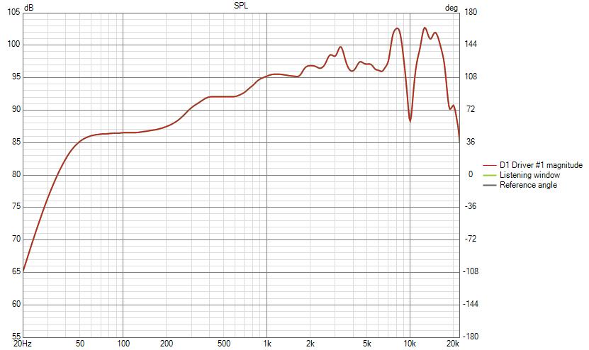

A pair of which are enroute to me. Plan is to use in a small ob with a sub. People seem to like this diver inspite of the 15khz Mt. Everest in the graph. Infact it is not mentioned at all. Do you all think this will need attention?

I wouldn't be concerned about the peak at 15Khz either...but this is how the chassis measures in the real world, in half space.
The measurement is imported from the german magazine HobbyHifi and can be trusted.
As with all (ALL) fullrange chassis you have a massive rise from bass levels to the mid and high regions...
Filling in the lows with a sub will help, the OB will most likely introduce a dip somewhere around 1kHz, and the peak at 3,4Khz should
be taken care of since your ear is most sensitive there.

Half space, that's mounted to a wall ?
That graph makes sense for what I think i hear, it's 10 db down from 1khz to 100hz.
Even on the floor, my speaker needed massive bass boost.....
If using 2 different speakers (flipping between a and b), it took me a bunch of loudness/bass knob fiddling to sound as full as my 12" 2-way (no baffle step).
I got tired always fighting to get the bass sound dialed in.
The manufacturer's graph is not even close.........wow
And definitely notch that peak, I agree.....

With open baffle and using a small baffle.
You will have a large Dipole peak.
So the peak at the top end is the least of your concern.
Off axis a 8" starts to drop quickly in highend
its not really a concern. Or easily fixed with a tweeter.
Simply use a wide notch to fix the dipole peak
and find a woofer that crosses over high to fix
the baffle step drop off from open baffle.
The wider the baffle , more easier to fix
and the large step will be lower in frequency
