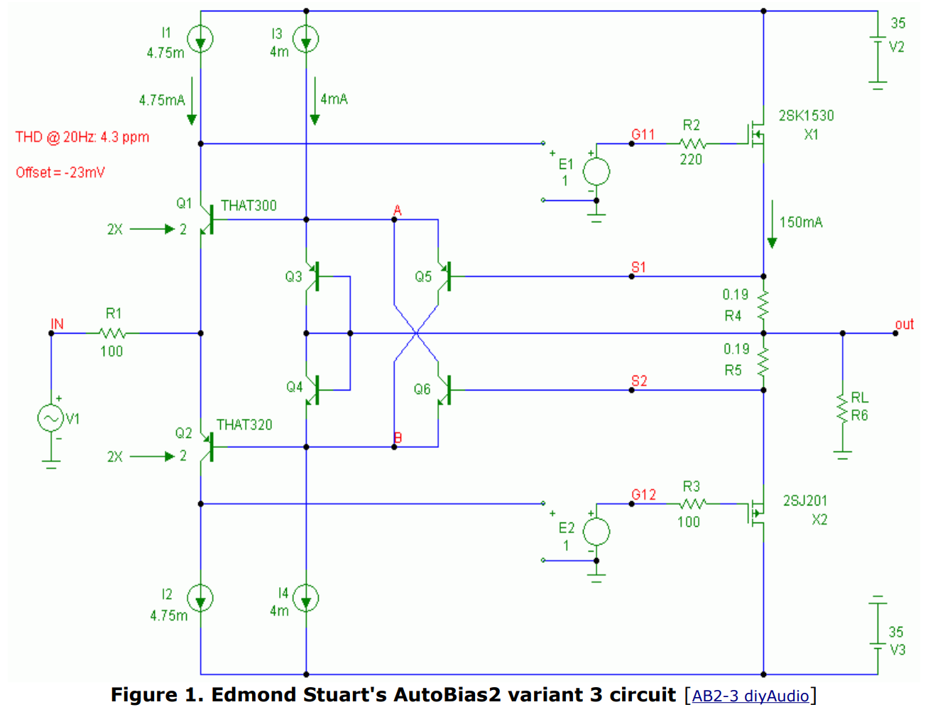

Post 14 Edmond Stuart's AutoBias2 circuit.

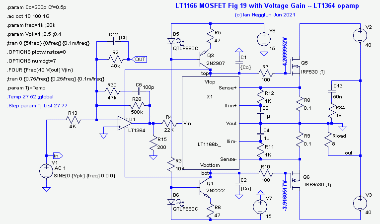

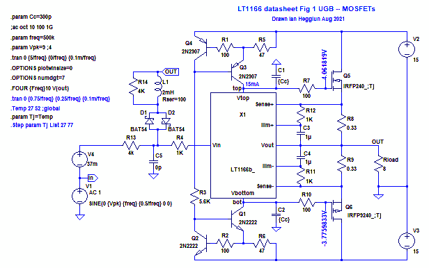

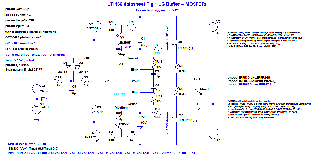

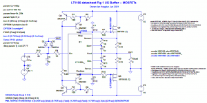

Some LT1166 sims

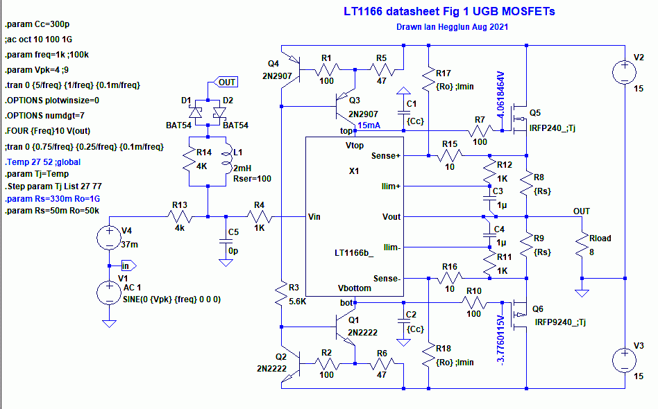

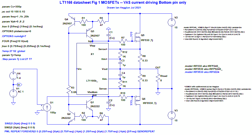

More from Syn08's post about implementing an Auto Bias loop using the LT1166 IC from here:

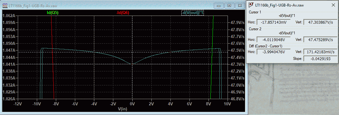

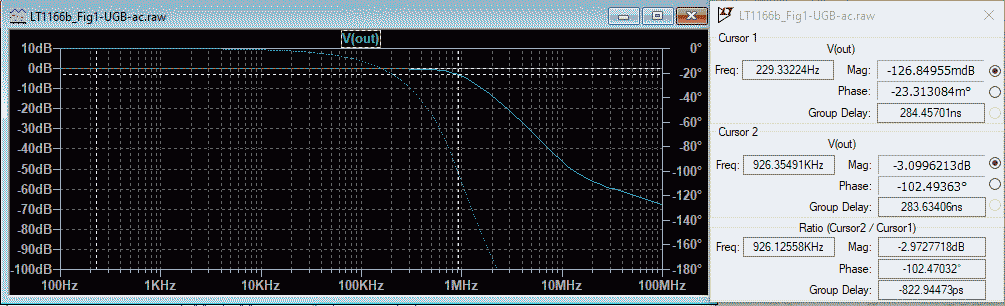

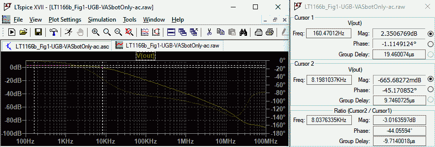

A simulations shows the LT1166 driven by a current source to the Bottom pin like a VAS would drive it.
The ac plot shows the f-3dB below as 8kHz
This is abysmal, pretty much unusable in this way as a drop-in Auto Bias generator. This may have been the way Syn08 used it? BTW The datasheet never showed it used in this way.
When the LT1166 is driven at the Vin pin (as below) like in the datasheet then the f-3dB is dramatically improved to about 1MHz. That's more like what we need.
The simulation files are attached.
Included is a symmetrical VAS drive which is no different BW to the Bottom VAS drive.
Also a simulation with 1uF capacitors across the Top and Bottom pins to show they kill the Auto Bias IC altogether.
A paper on my simulation of the LT1166 is here: LT1166-Bias-Controller-Follower-Simulation.pdf - Google Drive
and the LTspice files are here: LT1166-Bias-Controller-Follower-Simulation-files.zip - Google Drive
Yes, back in 2007 .
https://www.diyaudio.com/forums/solid-state/94204-contribution.html#post1107005
The data sheet shows this mode in Fig. 7 and 19. That's because the distortion performance when using the VIN pin is a dismal. I can confirm (by measurements) this disappointing performance over the VIN pin, so the conclusion is the LT1166 is a no win solution .
LT1166 Vin pin
Hi Syn08,
Originally Posted by IanHegglun Post 2, "This is abysmal, pretty much unusable in this way as a drop-in Auto Bias generator. This may have been the way Syn08 used it? BTW The datasheet never showed it used in this way."
Reply by Syn08
Thanks for the link to your earlier posts. I was aware of driving the Top and Bottom pins (DS Fig 19) using an opamp, like your circuit.
But my circuit was driving the Bottom pin using a current source without any global feedback. When you use global feedback the opamps high gain takes over giving low distortion (like DC Fig 19) and wide bandwidth.

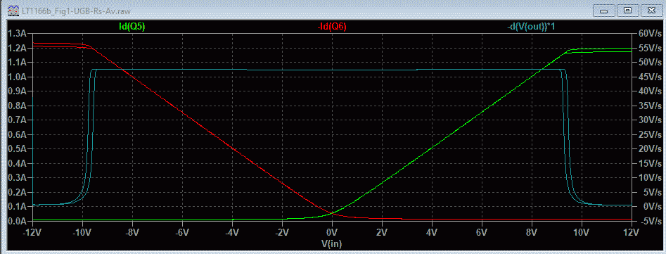

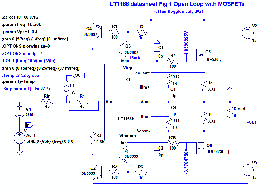

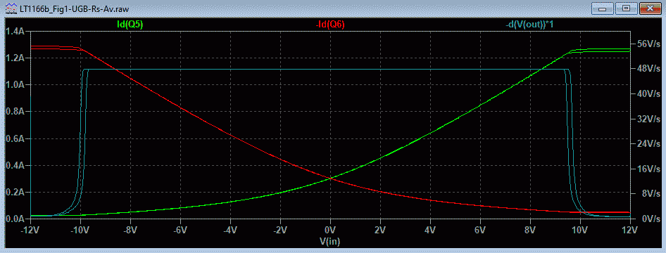

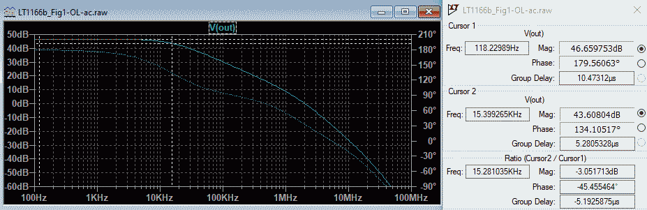

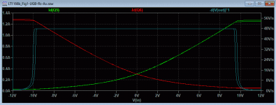

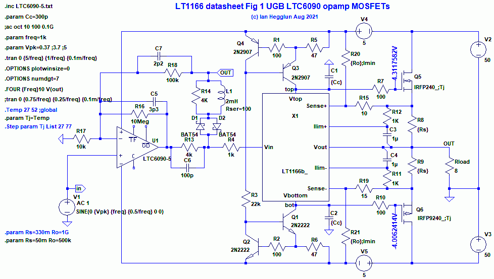

But then, how much is the LT1166 actually doing at HF if it starts to roll off at 15kHz?
The question about driving the Vin pin rather than the Top/Bottom pins -- which is it worse?
To try and answer this I used the circuit below to look at the open loop gain and phase plots. Things change with the input resistor Rin so I did several runs at 100 ohms, 1k, 5k and 100k. Notice the sources are grounded and the power rails are floating to make it open loop. The inductor is needed to maintain the same DC operating point as Rin changes.
With Rin 1k the open loop voltage gain is 47dB and f-3dB 15kHz. With 100 ohms it is 52dB (x400) and 15kHz. With 5k it is 37dB and 100k 12dB (all same freq). With 100 ohms the gm is 400/8=50 A/V and with 100k it is 0.5A/V. The open loop gm drops by half when Rin is about 1k.
This shows the behaviour of the Vin pin depends on what source resistance is used to drive it. If you use a current source to drive it you won't get much performance from the LT1166. If you connect it to a conventional VAS stage which is a very high resistance (at least at LF) then you need a buffer stage to get the best LF end performance with the LT1166 when driving the Vin pin.

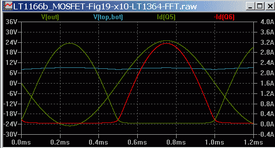

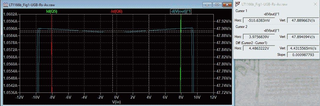

What is the gain when driving the Top/Bottom pins?
Post 2 simulation shows you need to inject about 0.5mA into one of these nodes to get about 1A change at the output -- current gain (equiv. Hfe) of about 2000 times. BW 15kHz.
For this post the input current for 1A out is about 5mV (from1/gm= 1/200 with 1k Rin) into 1k is 5uA. That is 100th the current when driving the Top/Bottom pins in open loop. Same BW.
Why then can you get lower distortion by driving the Top/Bottom pins (as shown for DS Fig 19) and as others have proven? I think it is because driving Top/Bottom pins with an opamp and then the global feedback can bypass the LT1166 above open loop 15kHz rolloff.

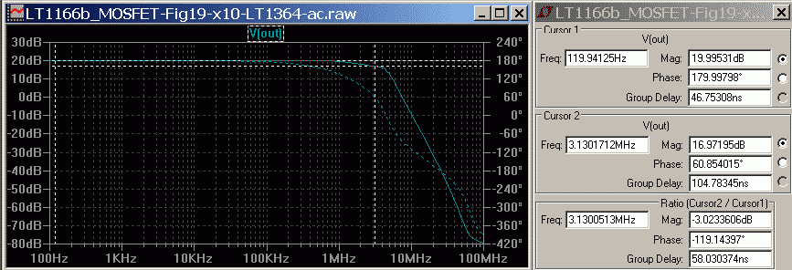

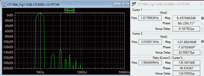

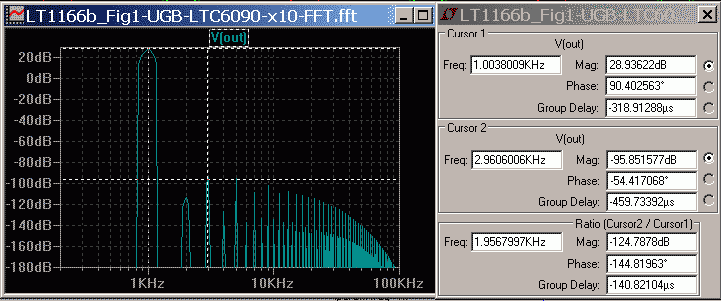

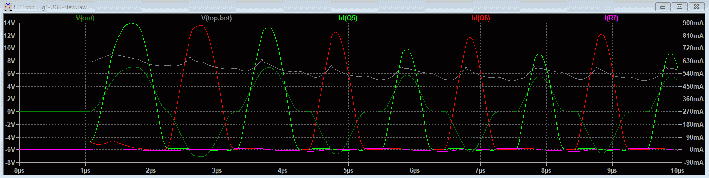

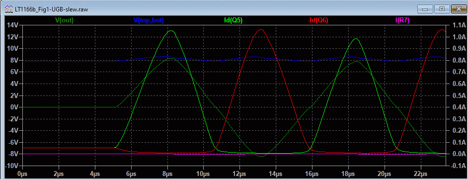

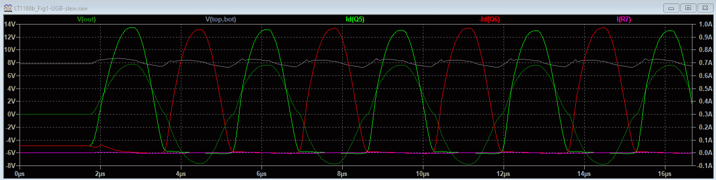

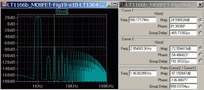

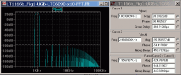

LT1166 opamp Top/Bottom pin drive *and* Vin pin drive
Here's a simulation of the LT1166 with an opamp driving the Top/Bottom pins and the Vin pin. Notice it uses floating PS rails so a standard voltage audio opamp can be used.
With a voltage gain of 20dB the BW is 3MHz. THD is quite low 0.002% at 1kHz.
Driving the Vin pin as well as the Top/Bottom pins adds some extra loop gain below 15kHz. R4 needs to be above 10k to prevent the LT1166 getting too confused. To see the effect of R4 in an ac plot replace R2 with a 1GH inductor.
Sim files are attached (including the ones for the previous post for open loop).

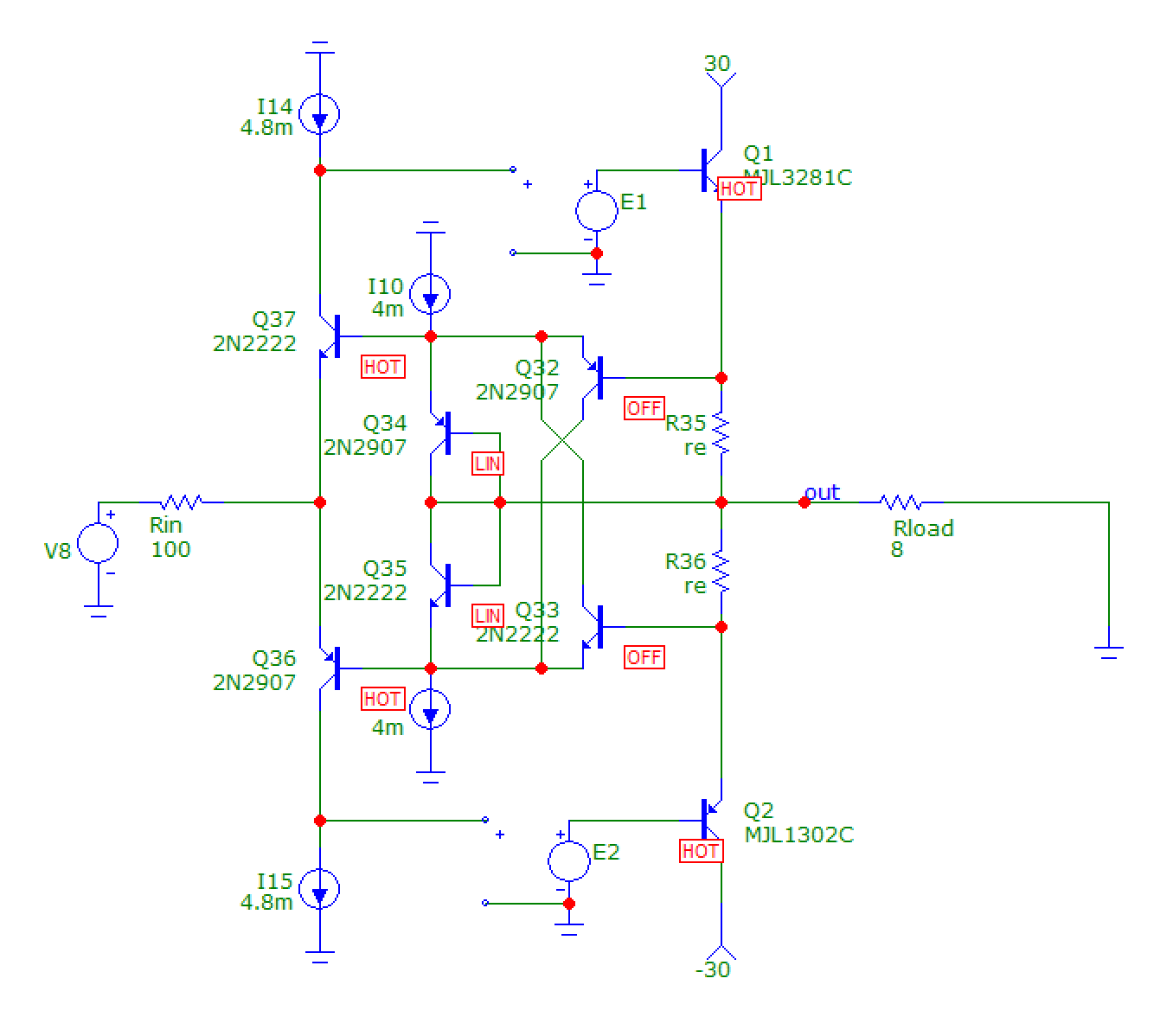

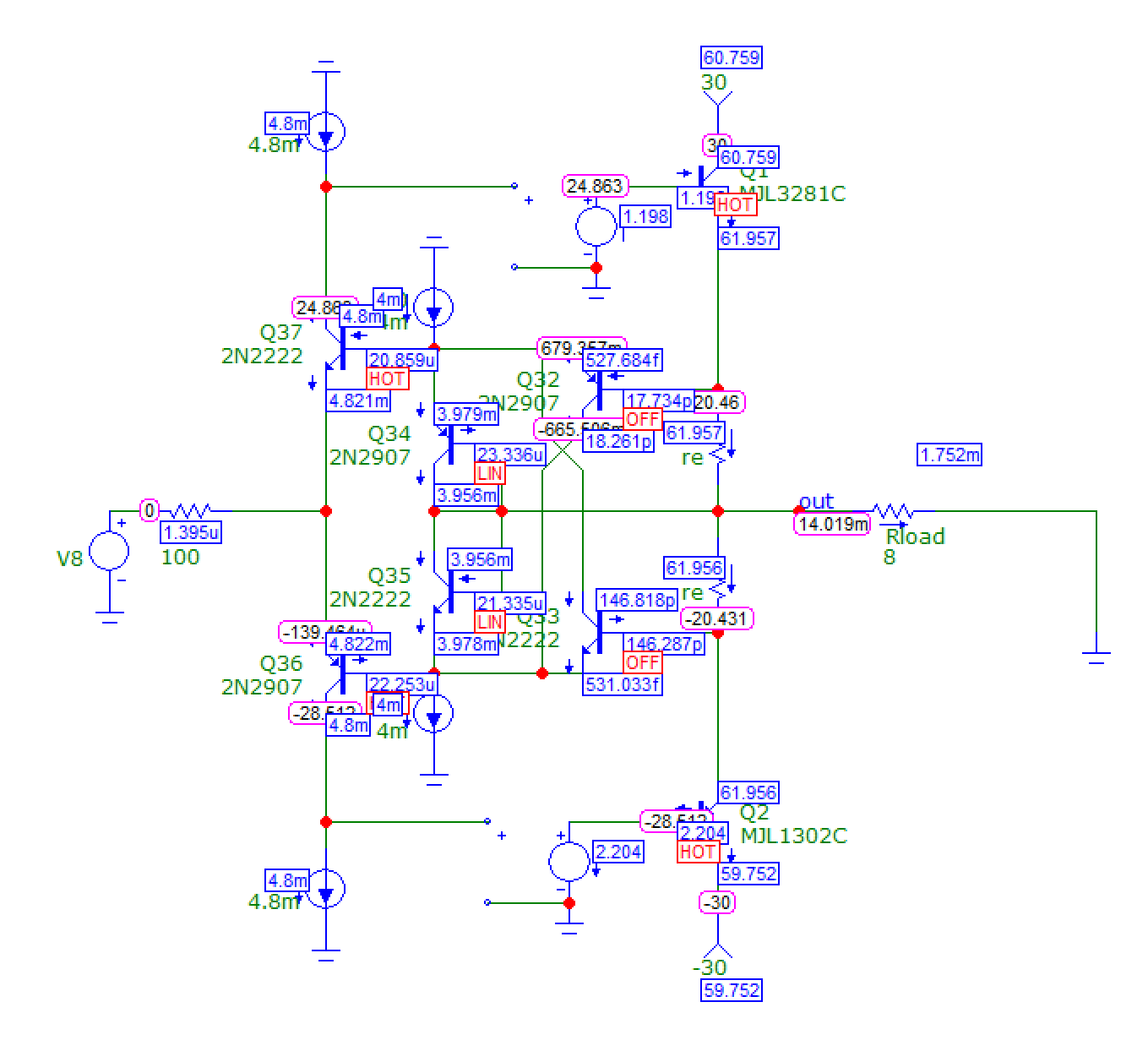

syn08 I think I've found out why you got AutoBias2 to latch up. I got it to latch up in the simulator.
If, due to some unfortunate circumstances, both Q5 and Q6 turn off at the same time... then Q1 and Q2 are only controlled by the diode transistors Q3 Q4 which means they sink a collector current of about 4mA. Since I1 and I3 source more than 4mA, Q1 and Q2 can't keep the bias voltage under control, and it rises. Since that increases the voltage across the emitter resistors, that keeps Q5 and Q6 off, which means it is latched up at the maximum bias current the power supply will provide.
Slew rate workout
Without the inductor in series with the diodes the slew rate is 4V/us which limits full swing to 100kHz (below) with a sinewave (slew limiting makes it triangular)
With the inductor the slew rate peaks at 20V/us allowing full swing of 8Vpk at 300kHz (below)
Now with the inductor at 500kHz the LT1166 cannot maintain its proper control and the bias voltage falls causing severe crossover distortion
Notice the LT1166 when operated beyond its control limit does not give cross-conduction which is a very desirable thing for any bias system. Cross-conduction at high frequency causes excessive dissipation and usually eventual destruction as the heatsink heats up. So auto bias circuits need to be checked for cross-conduction when pushed to their limits. And driven by 1MHz the MOSFETs stop conducting after a few cycles. Looking good.
This partly answers my question, that the LT1166 Vin pin drive does allow safe control of the MOSFETs even when pushed into slew rate limiting.
With higher voltage rails, like used in most power amps, the slew rate is high enough for operation to 100kHz (eg +/-50V rails), and that is without an emitter follower to drive the MOSFETs.
Looks like the LT1166 is not as bad as some have found. Looks OK for full the 20kHz.

The next question: Does that safe operation with SR limiting also apply to driving the top and bottom pins with an opamp? Yet to confirm.
I'm still thinking about this question. Some more simulations using the Vin pin. This time slew rate simulations with a 9V input - just below clip with a 15V rails using the Datasheet Fig 1 circuit again as below - but with mods to the Schottky clamp diodes for higher slew rates....my circuit was driving the Bottom pin using a current source without any global feedback. When you use global feedback the opamps high gain takes over giving low distortion (like DC Fig 19) and wide bandwidth.

latch up?
Cheers, E.
Just the opposite. In that case the bias current is almost zero and if one of them (Q5 or Q6) is turned off, the bias current is about halved,syn08 I think I've found out why you got AutoBias2 to latch up. I got it to latch up in the simulator.
Cheers, E.
You have overlooked that Q1 and Q2 have a value of 2 (i.e. 2 pieces in parallel), see attachment.According to the simulator, it seems like a stable latched-up state. Where is the mistake?
Cheers, E.
Nice, that solves the issue.

A post to follow this: showing the effect of 0.33 ohm and 0.05 ohm source resistors on the wingspread curve for the LT1166.
Effect of source resistor value on LT1166 THD
I use the circuit below
With source resistors of 0.33 ohms (as per DS Fig 1) the idle current is 55mA.
With source resistors of 0.05 ohms the idle current is 300mA.
The minimum current is trimmed by adding some offset voltage to the Sense inputs. With 50k and 10 ohms from the 15V rail the minimum current is reduced from 150mA to 50mA (thats for Rs=50mR).
The current plot for 0.33 ohms below for Tj of 27C and 77C (MOSFETs only)
The wingspread plot for 0.33 ohms below for Tj of 27C and 77C (MOSFETs only)
The current plot for 0.05 ohms below
The wingspread plot for 0.05 ohms below
Distortion figures for 0.33 ohms at 1kHz/8R are:
TJ=27 degC ..... 0.0403% and 0.0366% at 9Vpk and 4Vpk respectively
TJ=77 degC ..... 0.0408% and 0.0379% at 9Vpk and 4Vpk
Distortion figures for 0.05 ohms at 1kHz/8R are:
TJ=27 degC ..... 0.0101% and 0.0011% at 9Vpk and 4Vpk respectively
TJ=77 degC ..... 0.0095% and 0.00099% at 9Vpk and 4Vpk.
Notice how small the difference in THD is when Tj of the MOSFETs change by 50 degrees C. It is miniscule, so no thermal lag distortion and no warmup time required. That makes bias loops look so useful.
Notice with 0.05 ohm source resistors the THD for 4V peak (about 1W/8R) is only 0.001% at 1kHz. With 0.33 ohm source resistors its 30 times higher. The idle current is about 5 times higher. Looks like a worthwhile trade to me.

Possible amp using the LT1166
This is a follow up on the slew rate post. I have added a LTC6090 high voltage opamp as a driver for the LT1166 Vin pin (below). BTW the datasheet does not show a circuit using a high voltage opamp (closest is Fig 19 with "suspended supply operation" with lower voltage opamps that need 0.1% resistors).
The rails are +/-50V with 5V lift for the CCS and opamp headroom, giving 40Vpk output into 4 ohms. It is 100W intended for 8 ohms.
With the LTC6090-5 the slew rate is 17V/us. This amplifier achieves 10V/us which gives full 40V at 50kHz without slew rate limiting. No cross-conduction issues at any frequency. Clip recovery OK. (BTW if the opamp was twice as fast the LT1166 should do 100kHz before slew rate limiting).
Distortion with 0.33 ohm source resistors at 1kHz: 0.00042% 40Vpk and 0.00049% 4Vpk
Distortion with 0.05 ohm source resistors at 1kHz: 0.00010% 40Vpk (FFT below) and 0.000015% 4Vpk (FFT below)
Distortion is about 10 times higher at 10kHz, and 100 times higher at 50kHz.
