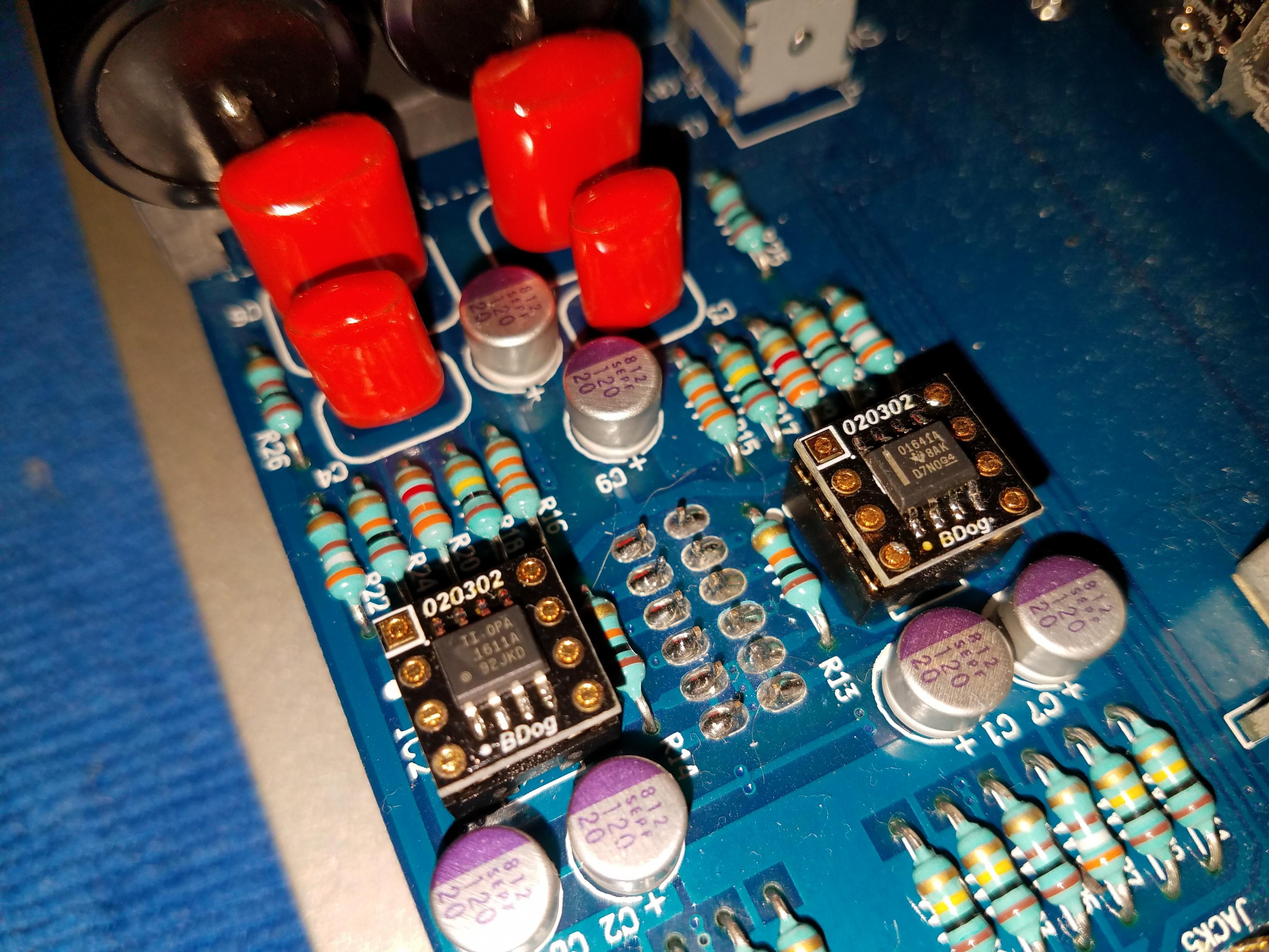

I absolutely love this Pre-amp. For the price and performance It's unbeatable. I bought mine with all the upgrades offered by Victor, like the Mundorf caps, Amtrans AMRT resistors. I decided to with bought a pair of NOS Mullard Backburn 12AT7's in the tube section.
As for Opamp. Hybrid Opamp give the best performance when it comes to a Phonostage. And the best combination ssddi far had been OPA1641 JFET For the input, and OPA1611 Bipolar for the second stage. By far the best sounding out of all the combinations I had tried. It has great noise performance and it has brought my records alive.
I recently posted on here about upgrading the Voltage regulators with great results in my 8500 here. TU-8500 with Sparkos Labs Discreet Voltages Regulators
Im going to try a new set pig hybrids. OPA827 Jfet for the inputs, and Sparkos labs SS3601 discreet opamp for the second stage, should be coming in the mail any day now.
I did try Sparkos SS3602 for both stages and it sounded pretty bad. Very loud hum, hopefully Hybrid does better. The SS3602 are better left in my headphone amp.
By the way! if your going to try hybrid opamp the 8500, The opamp inputs are mixed up. Left channel uses Pins 1 through 4 for the first stage, while the right channel uses pins 5 through 8 for the for the first stage. This picture was taken from the back of the amp, Left channel opamp is on the right, and Right channel opamp is on the left.

I have always read that opamp burn in is a myth, But after rolling quite a few, noise is the first thing I notice that changes with time, sound not so much. I even came across a thread of people literally baking them to accelerate break in. I couldn't tell if they were being sarcastic or serious.
