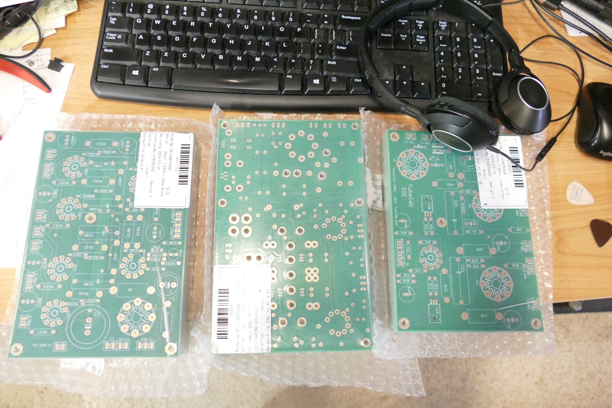

The mailman dropped a box on my front porch this morning. It had a lot of green and gold things in it.
Note that the actual color is the same as all of my previous boards. The ambient LED lighting and plastic overwrap make them look pale.

So why the extra expense for gold plating in THT? I order the default Sn/PB even for smt. I hand solder smt as it is.
I think sometimes I get Sn/Pb plate over Au, which to me is a loss for the fab, no gain for me but if everyone wants Au.
For something that gets hot like tube designs, I think I would spend the extra $ on higher Tg pcb material unless you did that as well.
When I solder gold pins I see the Au sputtering off, little specs cover the pcb area, its simply sparkly.

If I get boards made for personal projects, or test boards, and they will be populated within a few weeks or months of arrival I specify HASL, Hot Air Solder Leveling. This is just good old solder made flat with a hot air process. The original TSE board and the first batch of SSE's (25 or 50 boards) were the only HASL boards I sold. There are two reasons that I pay the ($1 to $2 per board) cost adder for ENIG, the Electroless Nickel Immersion Gold coating on the boards I sell.
Even a good quality HASL board will grow a thin oxide layer on the shiny parts over time. It may take a year or more, but I know that I have seen issues when trying to solder a 5+ year old board or repair a dead board that was built 10+ years ago. This makes the board harder to solder and increases the likelihood of a cold or "dry" solder joint that will become brittle over time. It's one of the main reasons that guitar amp guys hate PC boards.
Gold has an affinity for solder, just ask any of the operators that ran the wave solder machines at Motorola (or anywhere else) in the 70's what happened to their shiny gold jewelry. Just from working near a running machine lots of those fancy disco era gold chains turned grey over time. Eventually a row of lockers were installed near the machines. Many builders of my boards have not ever soldered on a PC board before, ENIG on oversized pads makes them easier to build.
