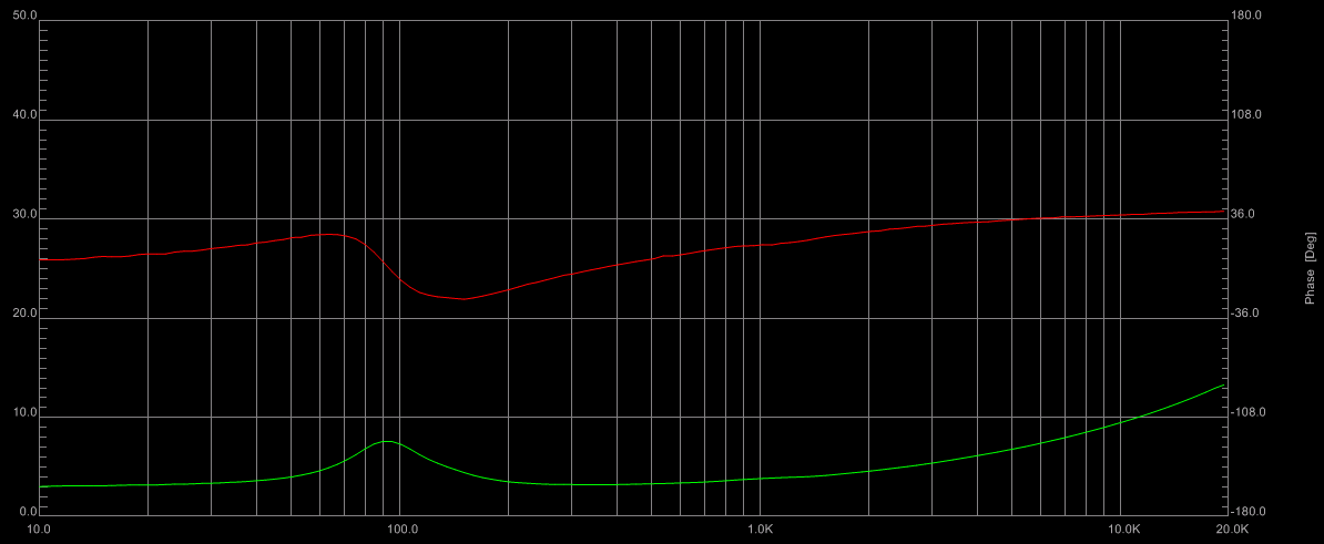

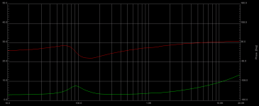

I have now finished building the aperiodic enclosures and have taken an initial impedance sweep with the vent filled with absorbent material. Attached is the impedance which is near enough identical to the vent completely open with no absorbent material. I think I need to increase vent filling density if I am to see any change in the impedance but as the output from the vent is already attenuated a lot compared with an open vent I'm wondering if there's much need for this.
The enclosure is around 28L, has four 5.25" woofers in a 2.5-way MMTMM arrangement. Total vent area for each enclosure is around 10 square inches.
I half expected to see a double peak with the vent open, but this didn't happen.
