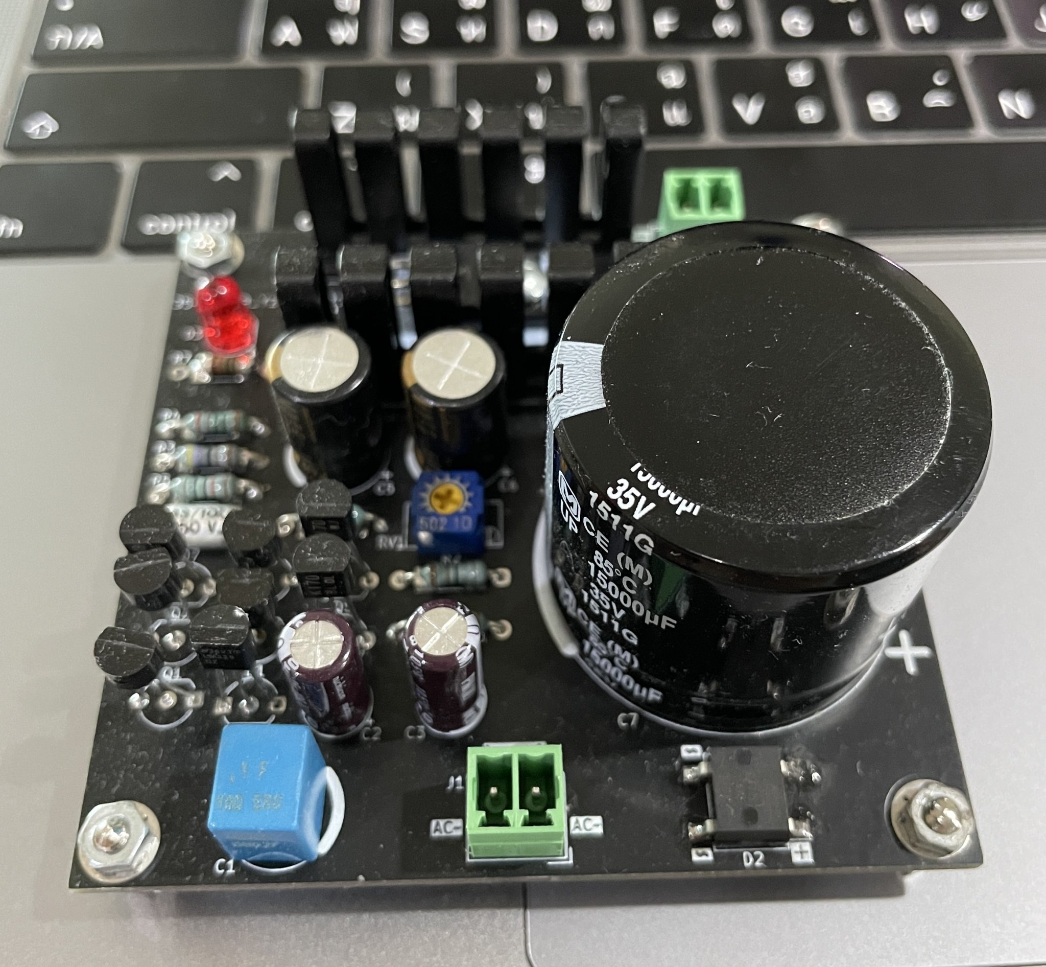

I have a Feickert turntable that utilizes a 24v Meanwell brick power supply. I would like to build a linear power supply for it. I'm searching for a kit, which I assume would be a scaled-down version of the Pass amplifer power supply, for those amp kits. A complete kit with the PC board and components would be optimal, but if I can get a PC board with a component list, I can certainly handle that after building an F5, F5T, Amp Camp, Korg Pre and a couple of other great components offered on this site. I don't see anything in the DIY Store that seems to fit this application. I would like to go a level above using the Meanwell with the filter kit in the DIY store. But may settle for that.
Any guidance or links to kits would be greatly appreciated!

From a practical standpoint, I'd buy a "24v linear power supply audio" (search terms on Aliexpress). At USD 50-100 a piece shipped, the ready built items are probably cheaper than buying the parts. I've bought a couple of 5V versions to power my COSMOS stack, they're alright.
