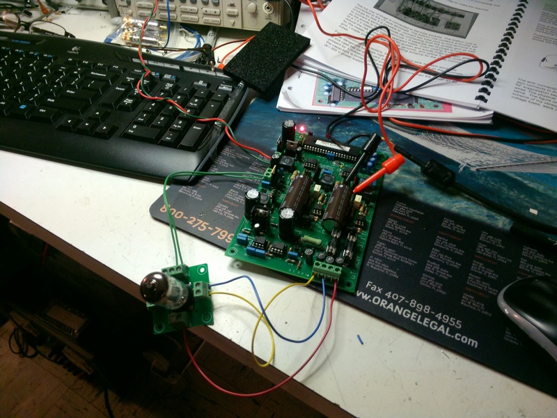

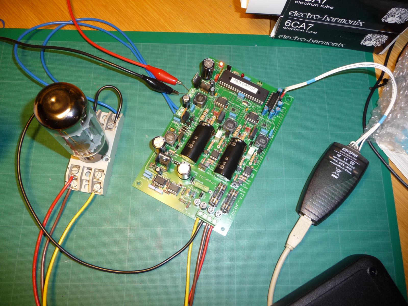

To cut a long story short, I bought myself the kit as a "me" Christmas present - took a day to build and test. The kit is of excellent quality - the design is very sound - e.g. short circuit & overload protected etc. - you would hope this was the case given the author's profession! The component quality was also very good and the supporting documentation very clear. Layout is good and the build process modular with continual testing. Its very professional.
Now been playing with the results for a few hours - very pleased indeed. All the PSUs (heater, anode & screen) are well-designed SMPS supplies and run cool - I've had the board running non-stop for several hours and it just gets slightly warm.

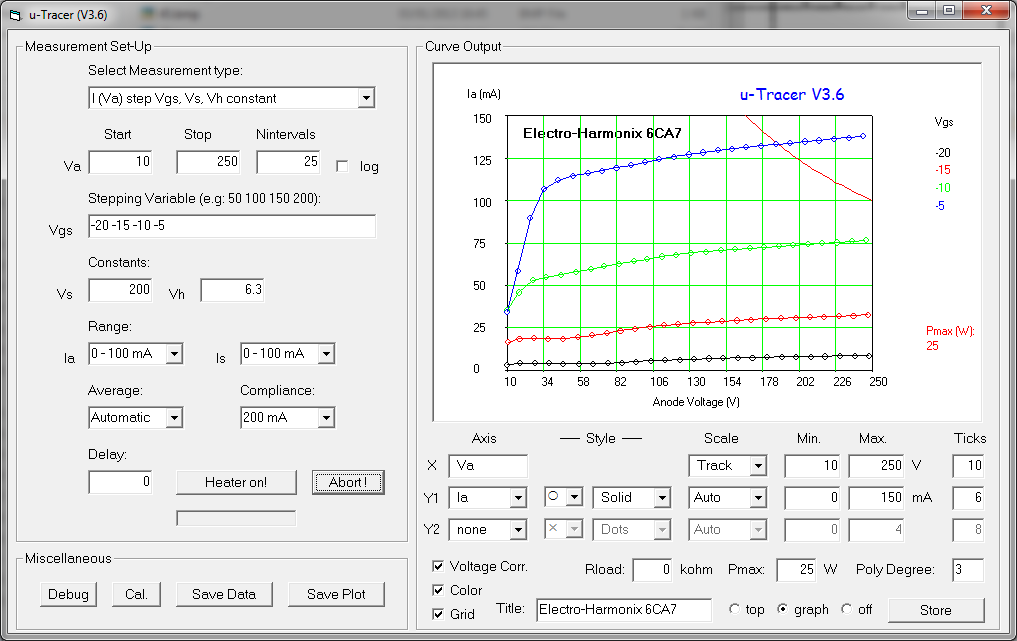

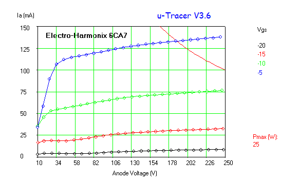

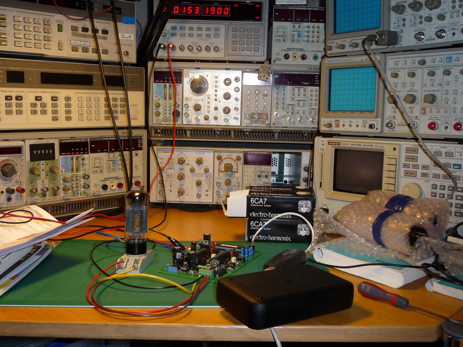

All running happily. Examples below of two plots - just playing to learn how to run different classes of tubes... to start with I chose a typical audio triode and pentode.
The attached photos show:
  • Setup screen for the 6CA7 tetrode test
  • On the test bench being intimidated:
  • Electro-Harmonix 6CA7 - Supressor connected to Cathode, 200V on screen, Grid stepped, Va varied and Ia plotted. 25W SOA is also shown. You can clearly see the "tetrode kink" on the graph

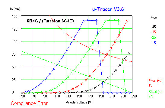

  • Svetlana 6C4C (aka 6B4G) - Here, I've overdriven a Russian 6C4C to check that the Iamax limit works (when I hit it the uTester give a "compliance error"). This graph has a 15W SOA curve and a 2.5K Ra load-line as well...
  • Completed controller board

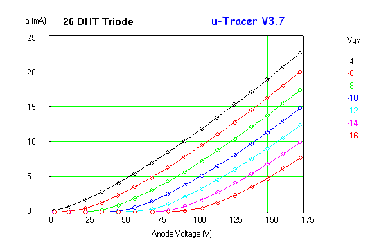

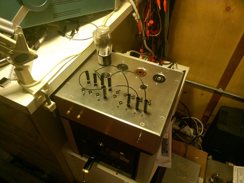

Here's mine. The kit went together without a hitch, the only hitch was when I ruined the top chassis plate by overzealous milling of the back surface of the top. Long story I don't want to relate, suffice it to say JB Weld works wonders but is ugly. This is a piece of test equipment so I will not be making it prettier.
Note that certain tubes with low voltage filaments need a little finagling to get the filament voltages right.

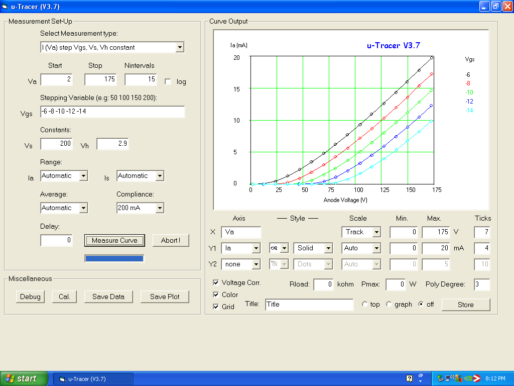

I found using my Keithley 2002 lab DVM that a setting of 2.8 - 2.9V delivered around 1.5 - 1.6V at the tube sockets with a 26 installed. (1.05A filament current)
For the 27 a setting of 3.7V was necessary to achieve 2.5V at the socket. (1.75A filament current) Note that technically the 27 filament current exceeds Ronald's current rating of 1.5A for the filament supply, but I've had no problems. I've fused the filament circuit at 2A.
Tubes with higher voltage, and/or lower current filaments will not have this issue. An external filament supply can always be used.
The voltage setting in the interface panel corresponds to a theoretical PWM duty cycle which when integrated in the filament corresponds to the value set, however the PWM based filament supply operates open loop so various losses conspire to require a higher than expected duty cycle at high load currents and low voltages. (The losses are due to finite on resistance in the mosfet, IR losses in the inductor, and attenuation of the pulses by the ferrites.)
Note on the Keithley 2002 and why direct measurements with many DVM may not work.. This meter has a true rms converter that is flat out to beyond 2.2MHz and can be AC coupled as well, most meters would probably struggle with the 19.5kHz square wave PWM waveform.

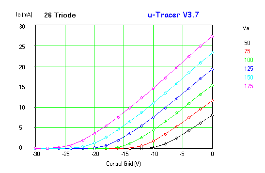

The uTracer will plot dIa/dV (first differential of anode current vs. grid voltage for different anode voltages) and the reciprocal of that, i.e. transconductance and gm - you can have two Y axis active at any time.
This video explains how to do it:
uTracer 3, Measuring the Transconductance - YouTube
