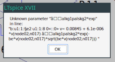

The 6E6P model returns the error message below. Is anyone aware of an alternate pentode mode version? Thanks.
The 6e6p_e model which Koonw posted has many syntax errors:
  • missing * signs for comment lines
  • missing + signs for continuation lines
  • mising multiplication * signs in formulas
I tried to fix the inconsistencies without changing any formula or numbers:
  • 6e6p.inc.txt
  • 6e6p.zip

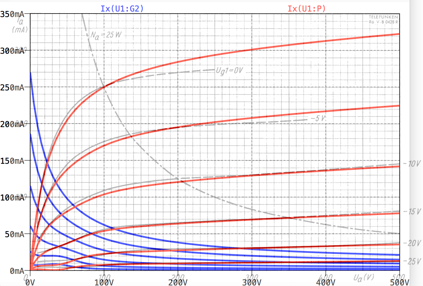

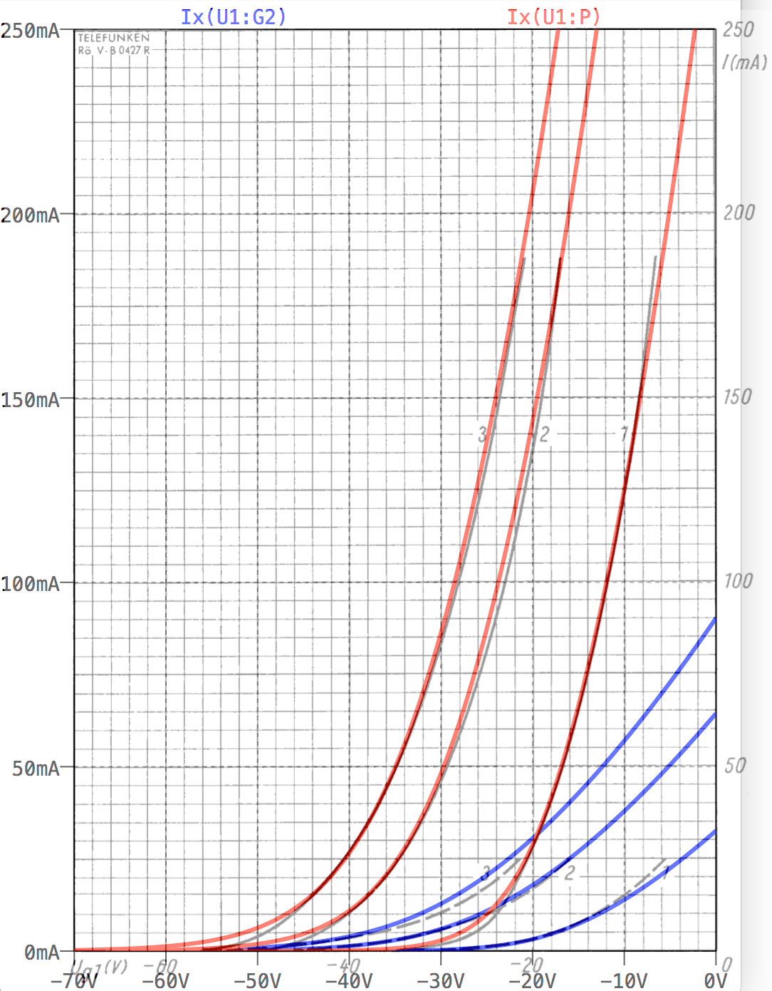

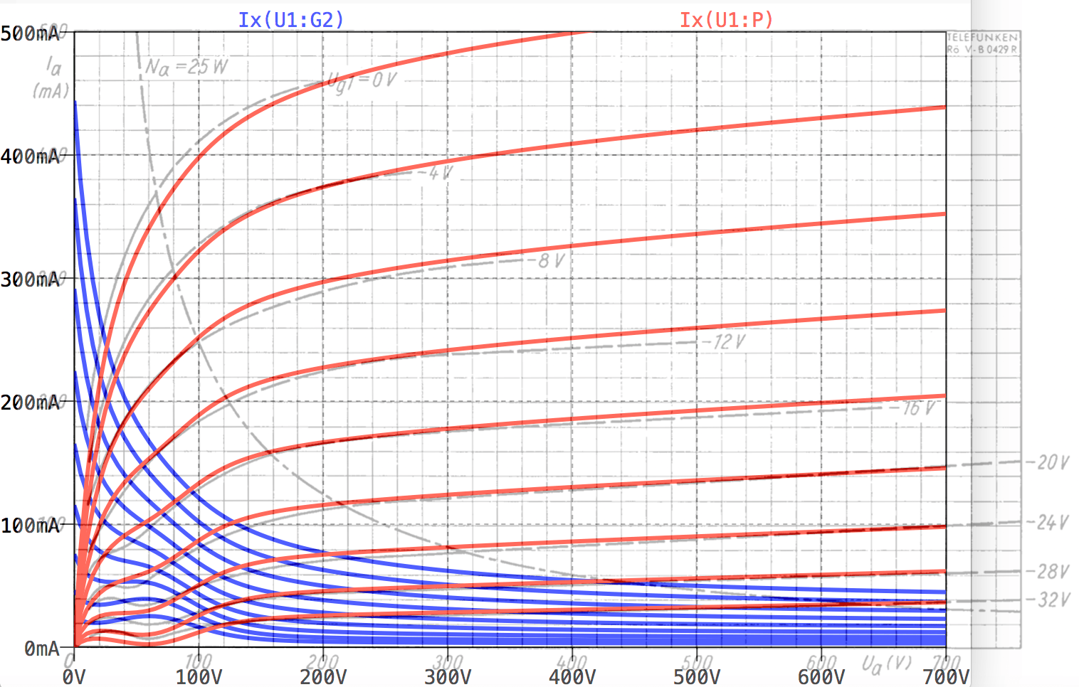

I did a EL34 model some years ago, with the following approach:
1) Ia and Ig2 curves are fitted to the Telefunken data sheet.
2) I tried also to mimic the secondary emission effect, which was hard to precisely fit. However, my thing is for sure more accurate in this aspect than all the other models which ignore secondary emission.
3) Grid model: I missed any data here, so I derived those from the next similar tube with reliable Ig1 data, which is the 6L6. the Ig1 gain factor was first unified for an exponent of 1.5 (as the 6L6 g1 model's exponent deviated from the 1.5), and then scaled linearly by the heating power of 6L6 & EL34.
Hence, please note that my EL34 g1 model provides "the right order of magnitude", say +70% / -40% or so, according to my stomach.
It is up to you whether this is sufficient for your needs.
BR Adrian

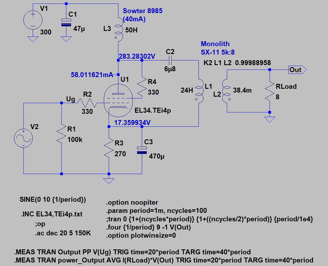

Specifically, i have setup a spice simulation of the power stage of the Dynacord Eminent 2. I observed a strong dependency of the available bias voltage on the grid leak resistors. Same effect in a G-2000 which is 10 years younger. Which can be caused by (a) significantly leaking coupling caps and (b) the G1 current caused by G1 collecting electrons. Or both, but at least in the G2000 i tested the caps ok when i restored the amp (put another one in series, no measurable effect on the potentials)
I would like to decrease those resistors - they are a bit out of spec even for the EL34 - and ran into trouble attempting this.
BTW: the 6L6 requires for much smaller grid leak resistances than the EL34, and also the KT77 has slightly stronger demands on the grid leaks, according to the data sheet. It looks to me as if that might be a property of beam power tetrodes in general, although i do not see the reason).
I get similar msg when I copy / paste from the web site into LTspice.
Copy / paste from web pages seems to introduce some garbage characters.
Here's the version I used (and tested just a couple of minutes ago w/o problems).
Unpack the .inc file as is directly from the zip ...
  • 6e5p.zip
My LTSPICE installation (ltspice4, linux, wine) provides pentode, tetrode and xpentode4 symbols.
xpentode4 describes a pentode with internally connected suppressor grid and hence has the same pins as the tetrode. Accordingly, both symbols lead to the identical problem, an undefined subcircuit without further specification. Both symbols run without technical problems with all the other EL34/KT77 models i have tested (Koren, Ayumi) and also give identical results for a given other model.
Which means the problem must be somewhere in Adrian's model. Maybe a cut and paste error. Unfortunately the download link on Adrian's website is gone

EDIT: sometimes it might help to check the error log:
Questionable use of curly braces in "bsee g2 p i=min(((pow(pow((uramp(((ise0)exp((d)(v(g2,k)-(vg2ref))))-((b)+(e)((v(g2,k)-(vg2ref))))*v(g1,k)))+1f,-(2))+pow((0.98*i(rp))+1f,-(2)),-1/(2))))(609m/((pow((co),2)))+293m+107m*((pow((co),2)))-5.71m*((pow((co),2)))((pow((co),2))))(v(p,k)/(1m+uramp((vse)-((a)+(c)(v(g2,k)-(vg2ref)))*v(g1,k))))(1-tanh((pow((co),2))((609m/((pow((co),2)))+293m+107m((pow((co),2)))-5.71m*((pow((co),2)))((pow((co),2))))(v(p,k)/(1m+uramp((vse)-((a)+(c)(v(g2,k)-(vg2ref)))*v(g1,k))))-1)))/((609m/((pow((co),2)))+293m+107m((pow((co),2)))-5.71m*((pow((co),2)))((pow((co),2))))(1-tanh((pow((co),2))((609m/((pow((co),2)))+293m+107m((pow((co),2)))-5.71m*((pow((co),2)))*((pow({co},2))))-1)))),i(rp)-i(bpl))"
Error: undefined symbol in: "[co]"
Fatal Error: Undefined subcircuit:
occurs repeatedly.

Code:
*Parameters to mimic the secondary emission (inspired from Derk Reefmans approach)
+ co = 1.4      ;decribes the crossover region (Ise drop when Va increase). between 0 and 9
.func sh() {pow(co,2)} ;results in a more linear control of the cross over region with the param co
Bsee G2 P I=min(Ise()nf(sh())*xf()(1-tanh(sh()(nf(sh())*xf()-1))) / (nf(sh())(1-tanh(sh()*(nf(sh())-1)))),i(Rp)-i(Bpl))
Unfortunately i am not sufficiently familiar with the syntax of spice code and feel unable to fix that. Please remember: i am still running ltspice4/wine, mostly because of the annoing changes of the paths with ltspice17 which makes it really laborious to move from my initial spice/mac installation.
After transferring the model text again, everything is working for me as well. Technically - everything beyond would be OT for this thread.
diff -c even showed me the error (a stray x two lines above my quote)

So thank You for the model, dear Adrian, and all for the help.
Odd because I'm pasting into a plain text editor that worked for the 6ag5. That last attempt was closer. No errors this time, the sim just refused start. It doesn't seem to like the cascade mosfet load.
Not a big concern, the 6AG5 promises such performance in my application as to warrant bench investigation. Thanks for the assistance.
