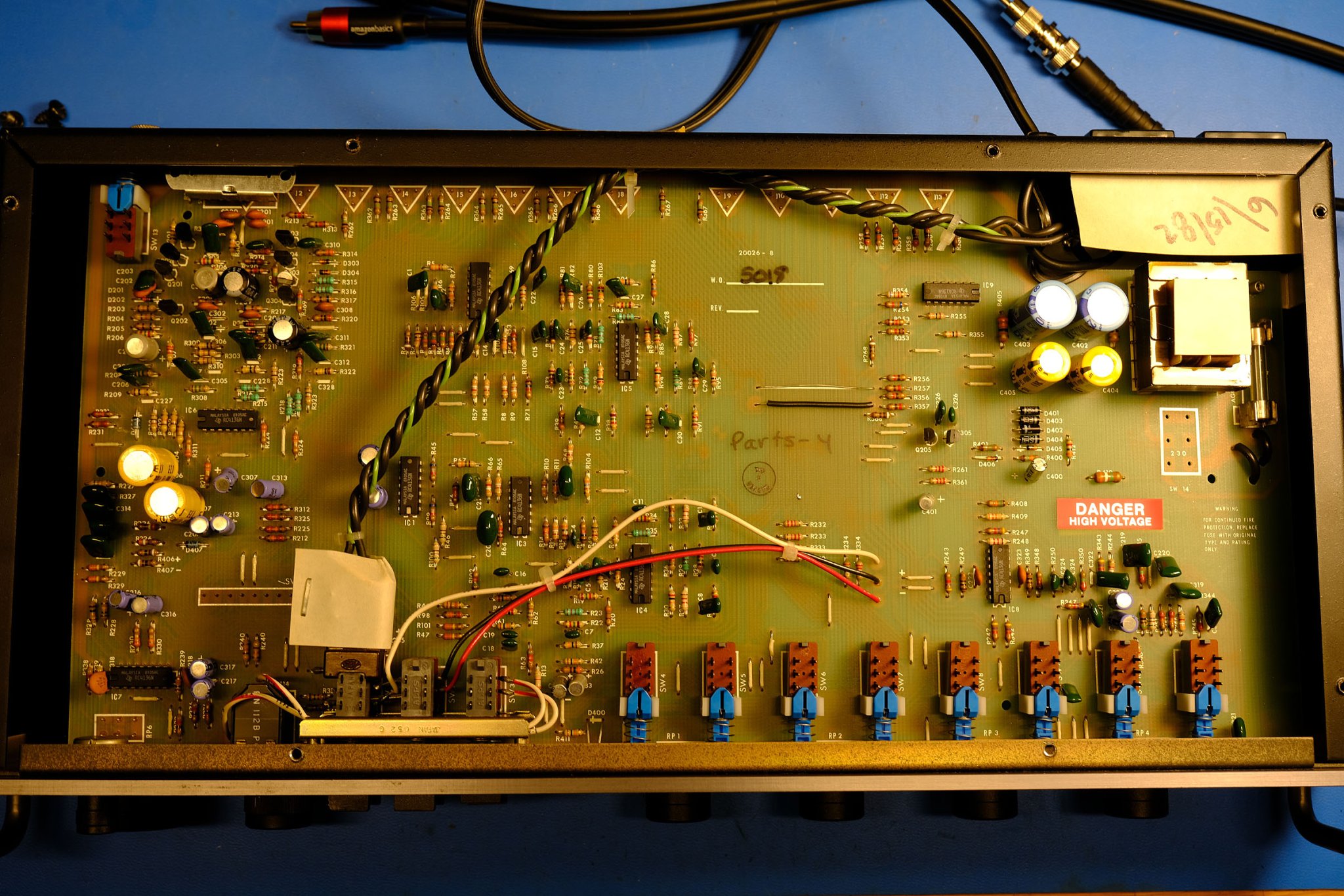

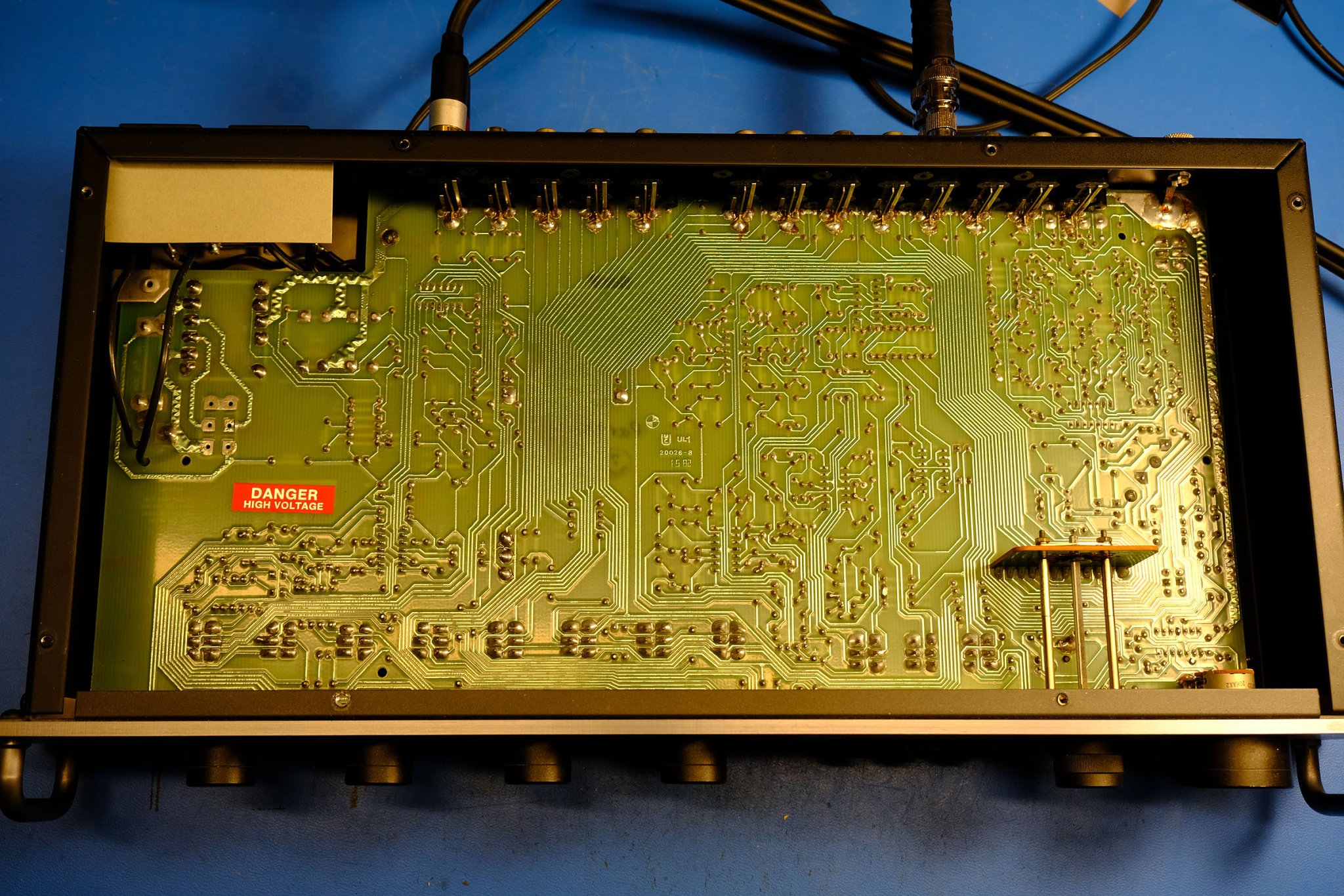

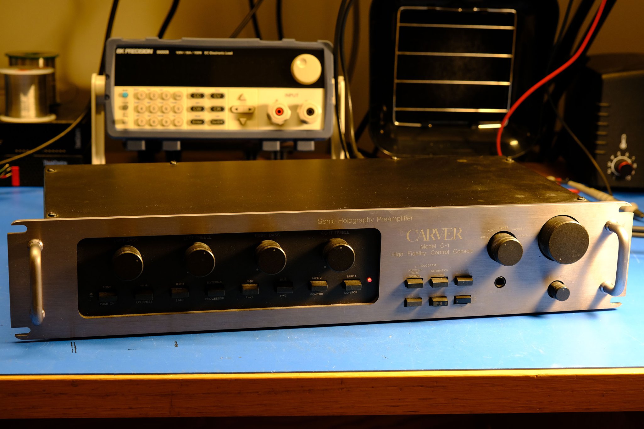

But getting back on topic. The last thing I repaired was a Carver C-1 preamp with a scratchy pot.

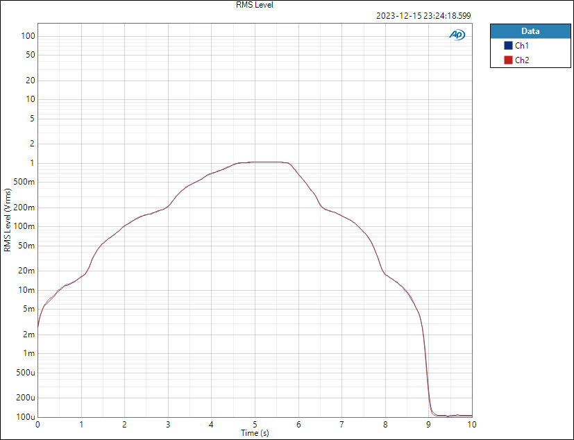

The graph below shows the output voltage with 1 V RMS applied at the input as the volume is turned all the way up then all the way down. It's pretty obvious what the issue is here.
This is the same measurement after the repair.
Much better.

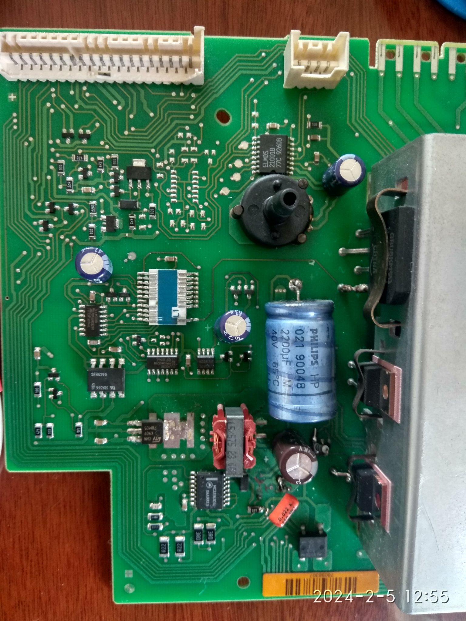

I hope that i have repair my washing machine again!
Miele novotronic W149.
No start,flashing "start led".
Pushing start nothing start 😞

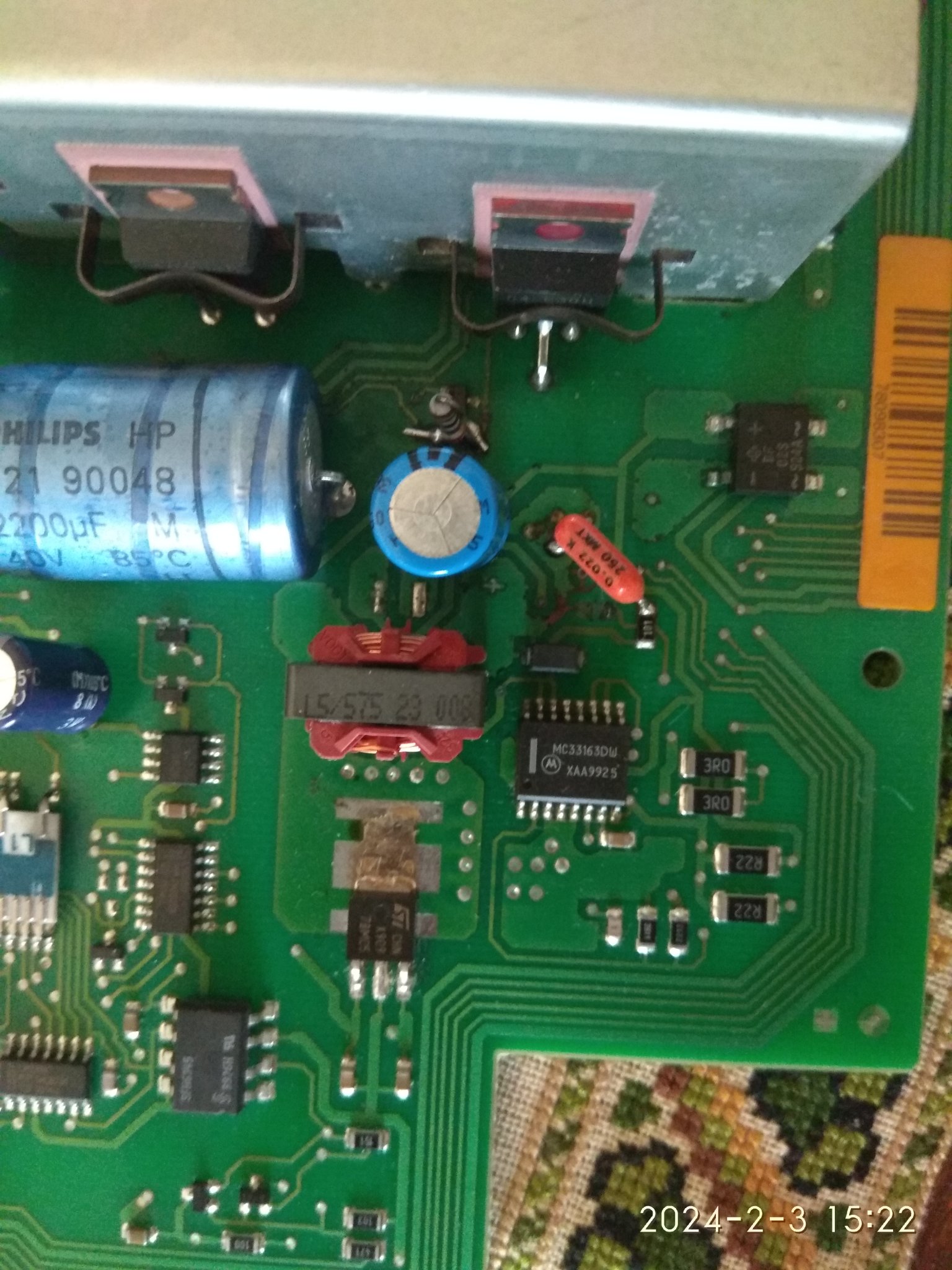

Looking at the main board i found a leakege capacitor 220uf close to the step down converter.
Input to the step down is 20V and output must be 12V.
It was 5V.
Replacing the capacitor voltage is 11,87V
Unfortunately,no start again.

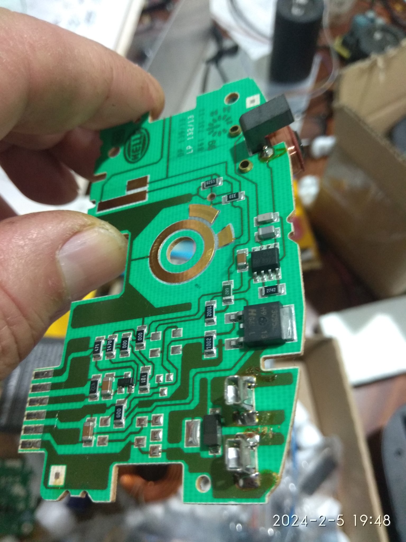

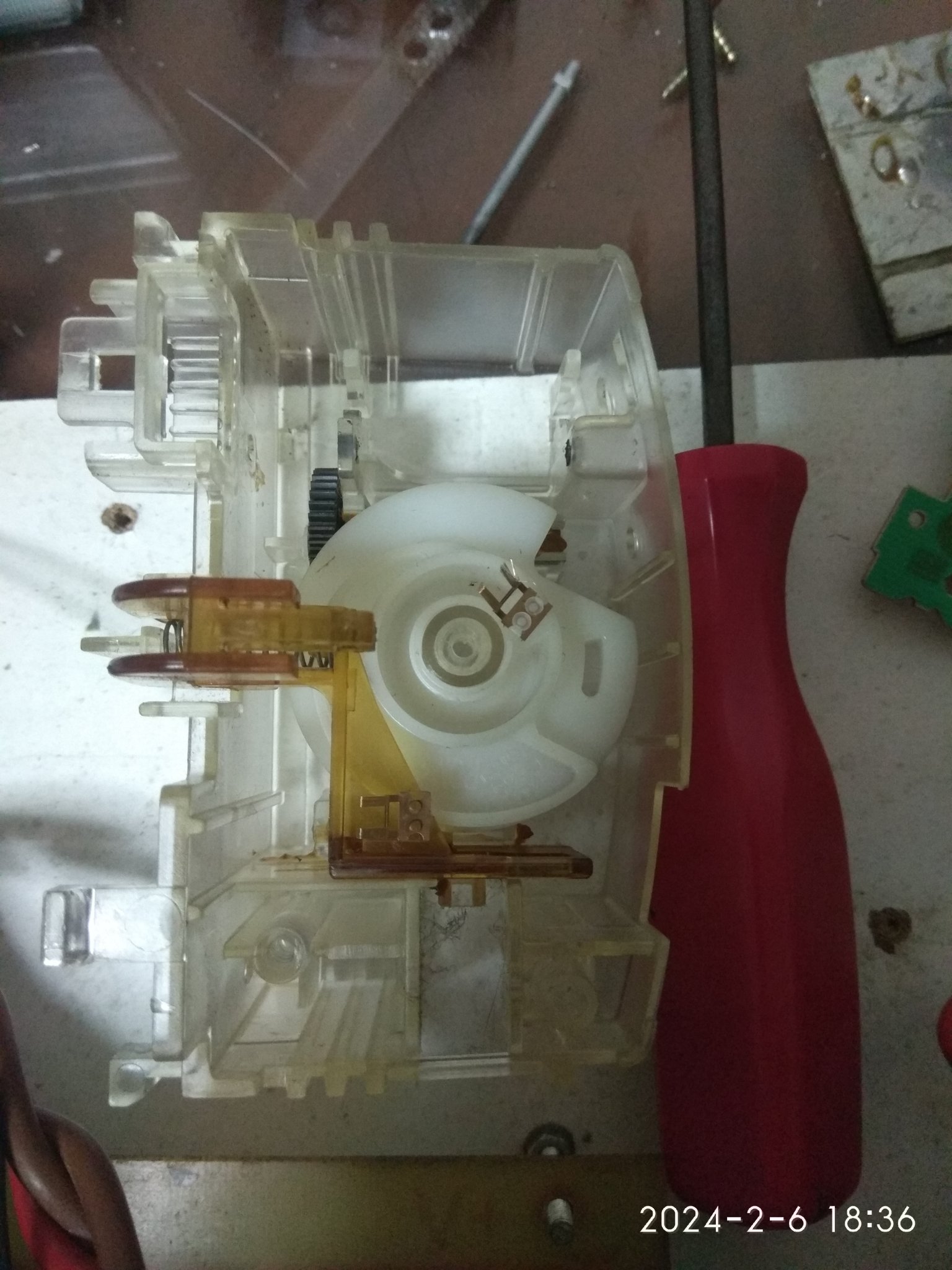

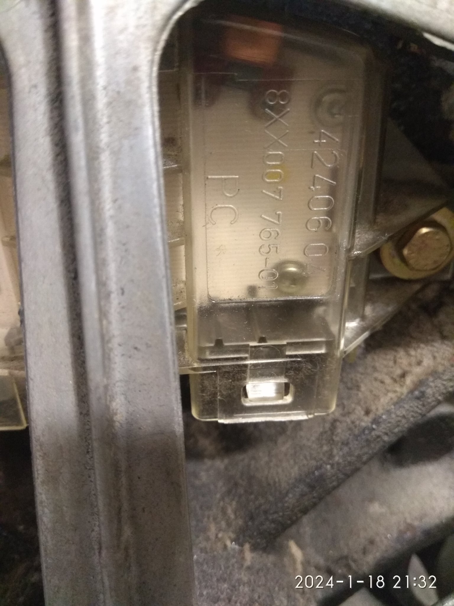

Behind the drum it is a mechanism for drum parking.Inside this, apart from others, it is a small toy motor.This motor is faulty.The faulty motor is a short circuit(this appears to eat 2A).
The rest of circuit is a promixity sensor TDA0161 and two platine position switches.
This mechanism is for the drum parking with the door in the up position.
As soon as this 12V voltage power all the relays, nothing happen when press start because the faulty motor short the voltage.
I have disconnect the voltage from this toy motor and power this via a bench power supply.
Pressing start ,all good now!
All? Not exactly,you need to open the external door by hand using the emergency cord and to rotate the drum manually but at least you can wash now!

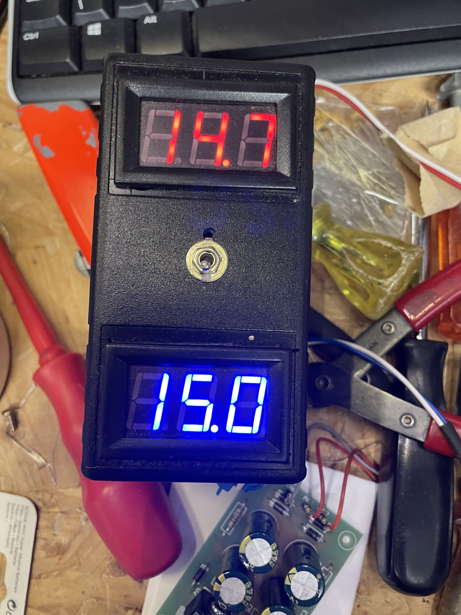

My home made voltage tester made from 2 digital displays like those in a bench psu. Only one lit when I turned it on so I suspected a flat battery.
Sure enough, one of the batteries had died, the blue display draws more current than the red one, so fair enough I replaced the battery. I gave it a final test before screwing the case back together. All good.
Tried to switch it on after reassembly… the power switch had broken, it was one of those tiny dpdt toggle switches from China rated at 125Vac at 3A. I have a few spares so no problem. I took it apart to see where it had failed and it was just the little plastic toggle that operates the leaf in the switch had come loose.
Having seen the internals, i dont think i’d ever use one of those above about 15V!
