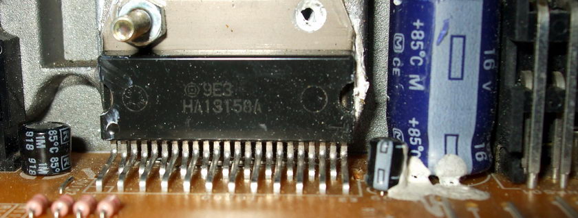

This one i am "burning"... playing with this toy
Sounds very good....but it is funny, can pump 25 watts into 4 outputs ... 25 RMS each output (Automobile CD player from Sony).... nice sound...but it has small size..imagine to dissipate 160 watts (all channels pumping maximum power... this may be the consumption) using the small metal tab?
The result was controled...power was controled by heat sensors...automatic control...when your car is 35 degrees celsius, when under the sunligth, hot weather..power goes to 3 watts each channel..ahahahahah!
I am trying to burn it...it is beeing hard to do that...protection works fine.
The designer was clever..you switch on when cold and pumps delicious sound..tigth bass.... a good "demonstration"..and when you start to feel happy the power was already reduced slowly and you do not perceive that...so..you continue happy!
Carlos

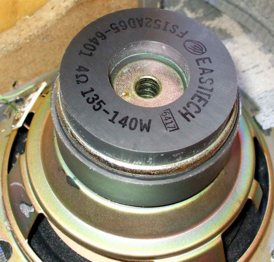

I would not be arrogant to say Philips International does not know
The Speaker came from Philips International imported parts joined together into Philips Brazil systems...the same speaker are use worldwide.... Philips are competent folks... the speaker was selected because of performance and price for their Class D systems.... the speaker was the choice to hold the power and to reproduce audio quality considering the price range.
I am sorry very much dear Eva, if Philips has decided to use and this means "testimony of quality" i will have preference to believe on them when you offer opposite point of view.
Also i had many imported units and have used them and they were not superior anyway!
The speaker seems made in China...but what is the problem to be made in China?.... they had evoluted a lot and have superated many other countries technology... alike Japan did when i was young..and people had that idea about Japanese speakers..considering junk..... maybe the first ones.... fast they became the better ones.
Expensive does not means good.... this speaker has high complicance, does not produce noises when reproducing music.... the infrasonic is silent, not noise...SO... audio also will not have the noise together... the moving coil does not touch the iron core... ressonance is very low... does not reproduce high frequencies (good that) because it is not a full range... there's absolutelly nothing wrong with the speaker i use unless people is thinking about unobtanium.
Having noises when reproducing low frequencies, also bellow the audible spectrum is better than have amplifiers producing clicks and pops because of crossover and protection.... what happens into infrasonic will happens also into musical reproduction when you play loud... this turns noisy and dirty reproduction into peaks.
Those chips, that has protections inside are unable to reproduce peaks without noises...and i have proved you that.... reality is reality, what folks thinks is what folks thinks.
Lineup...if you make a good effort, maybe before your death as you are old as i am... we have more 20 or 30 healthy years ahead... i think you will be able to build more tree or four amplifiers..sorry, i will build more 2 thousands, as i love to listen music and not to delirate into theories or simulators.... also i love to learn real things... differences into comparison... sorry not to be lazy about build things.
In my mind the clicks i have listened are definitive...not theories can dennie the real thing.
