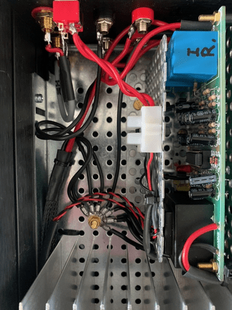

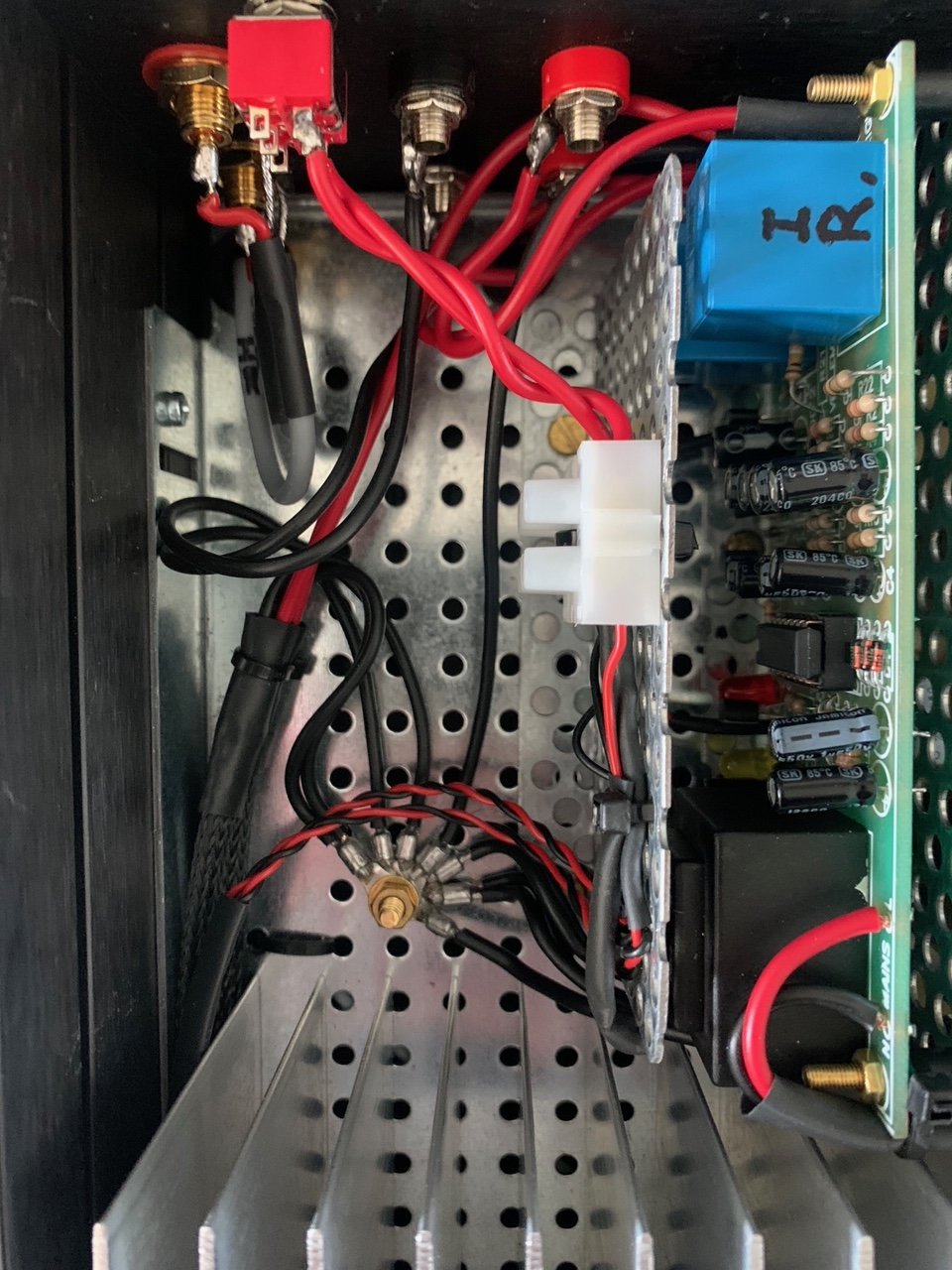

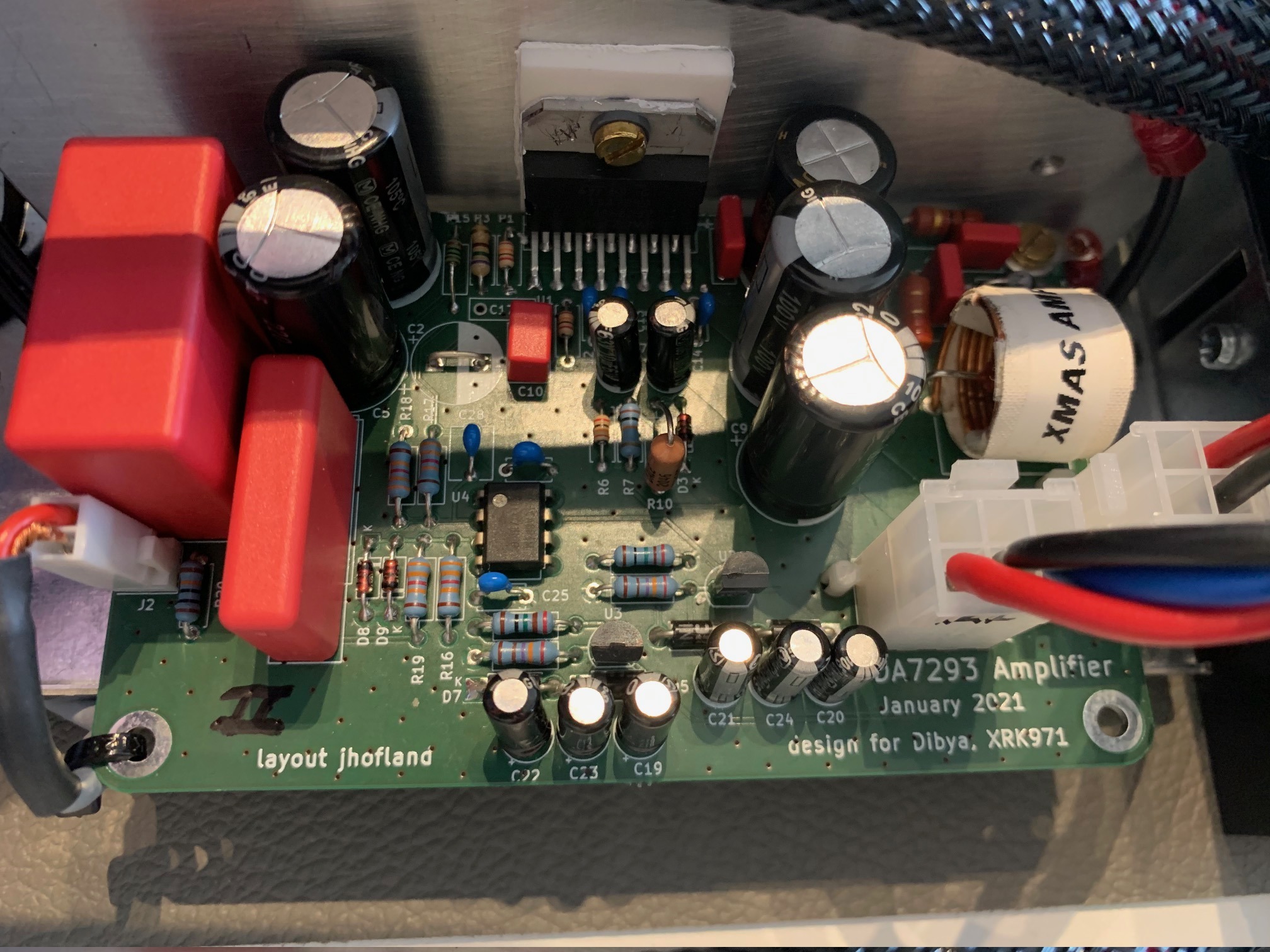

Just a little build update...
Slooooovly
I'am trying to follow some "correct" grounding schem. (Seen in this thread by @xrk971 at one of the first pages)
I connected the 2 GND points on the PCB corner's, and the heatsinks --- >Star-GND. Star-GND is connected through CL60||Wima 22nF to PSU-GND
I catched some nice ceramic 3mm. isolator's for the TDA, right now testing it.
The 3. picture shows the connection from PSU-GND through CL60 NTC || Wima 22nF

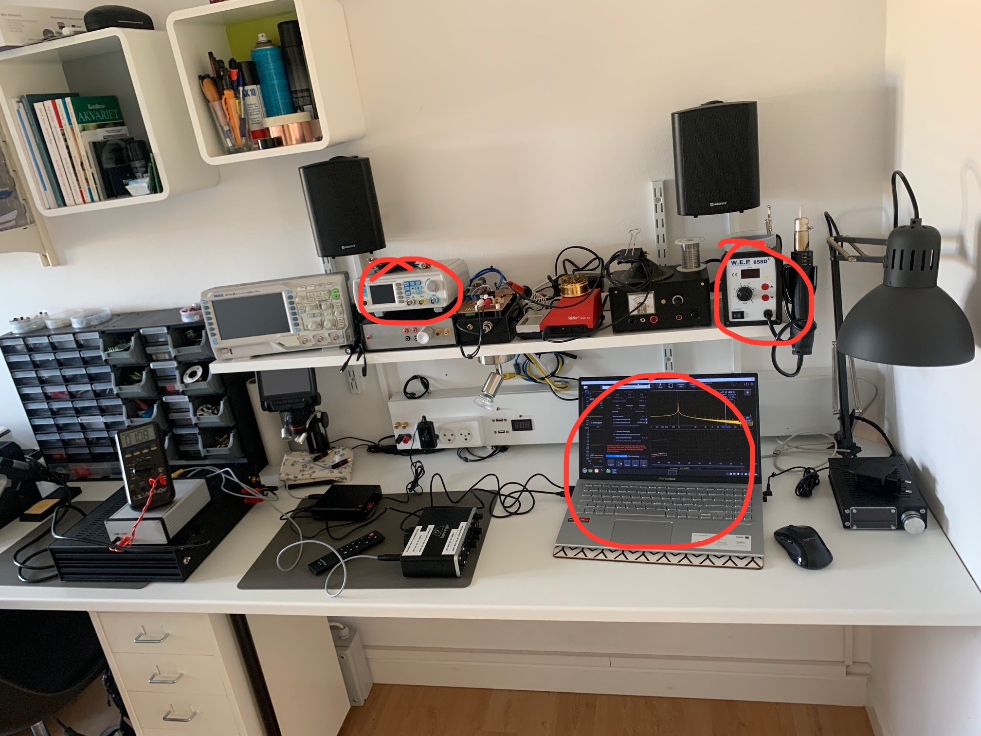

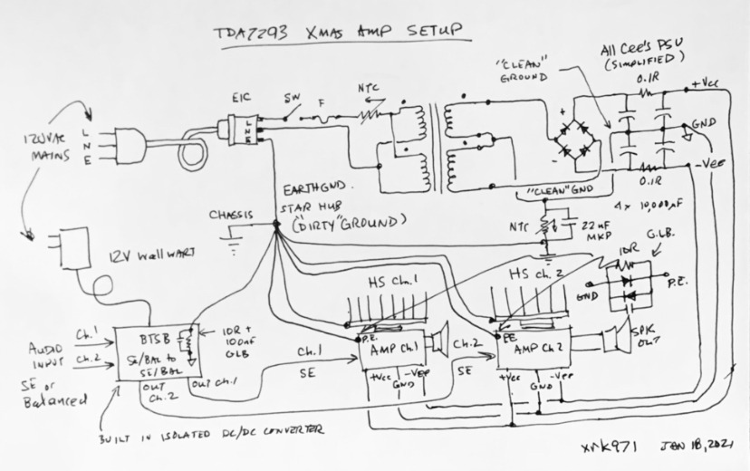

While assambly it all together, I do test the setup with my THD rig.
I'am struggling some gnd-loop's problems.
I have tried to follow the attached schematic, and as i showed in my previous post I have attached an CL60+mkt at the PSU-gnd connection to the chassis.
Quistion is... Do I best attach the speaker cables from the plugs on the PCB directly to bindingpost's
Also do I do the same with the input plug's directly to the RCA's.
E.G. not involving any "star"-gnd to those connection's ?
Any tips? -Hint's...

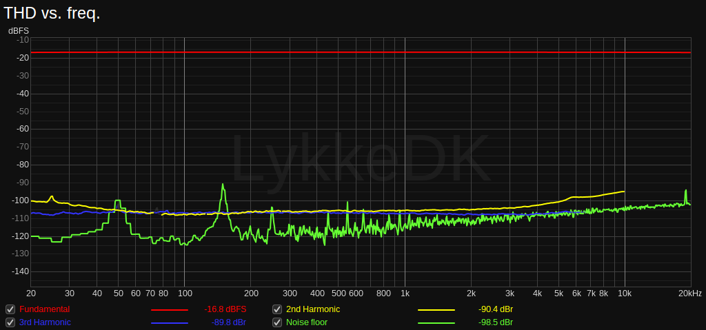

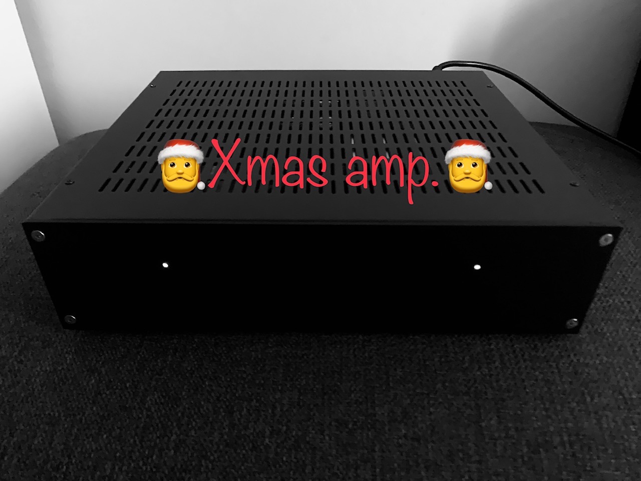

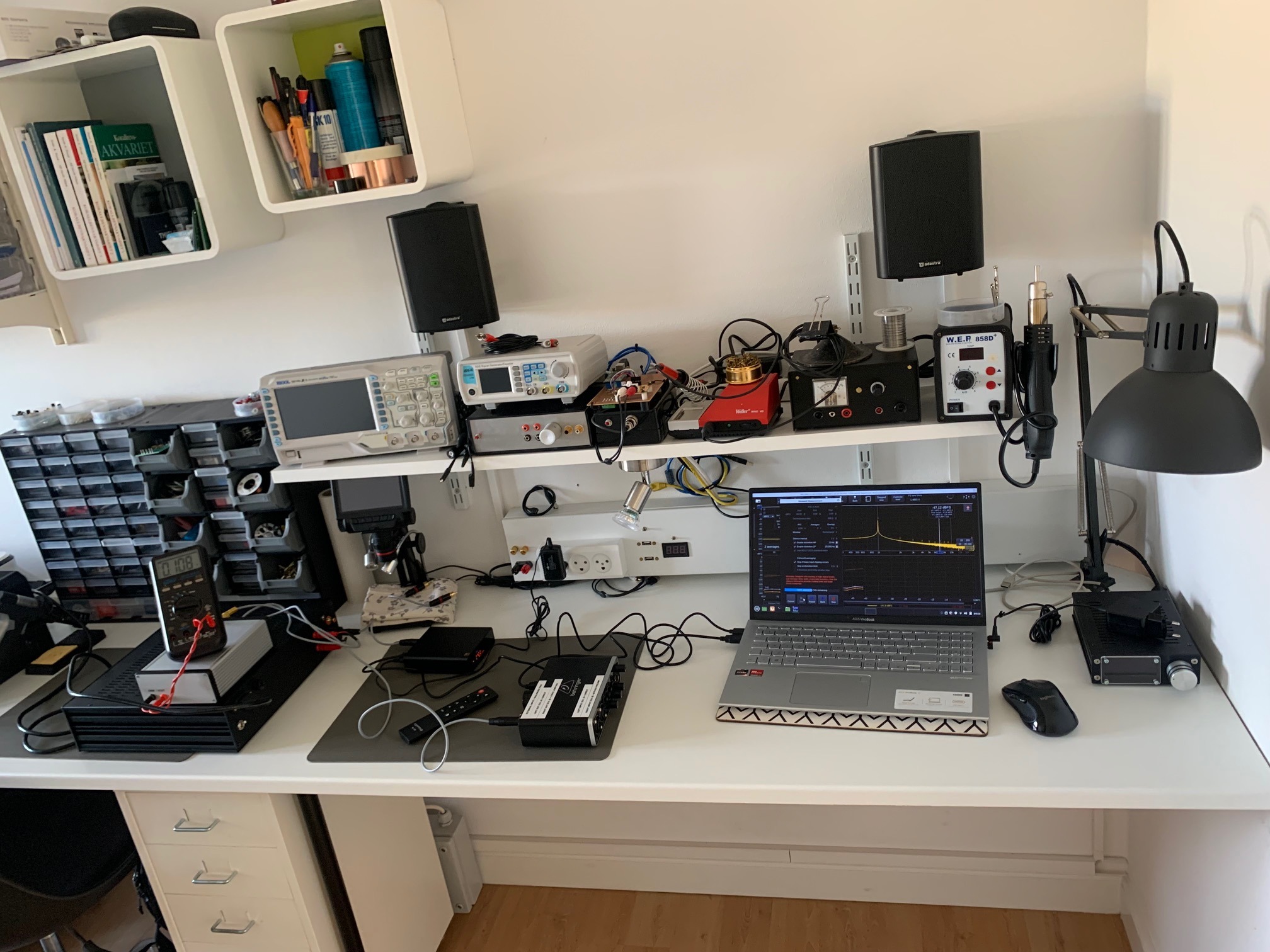

So i did a lot of stuff, ending up with some "GoodOld" plain "Y"-GND
Nothing was better than that, so I decided to stop here, having a very nice amplifier, absolutely quietly amp...
Sry... a' little showoff here :
The pcb, rightside of the "Y"-GND is the speaker protection.
The little switch is on/off for the frontpanel led's.

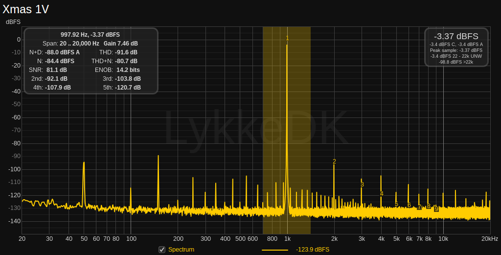

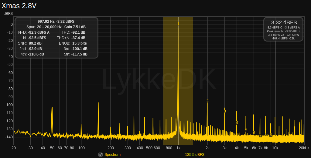

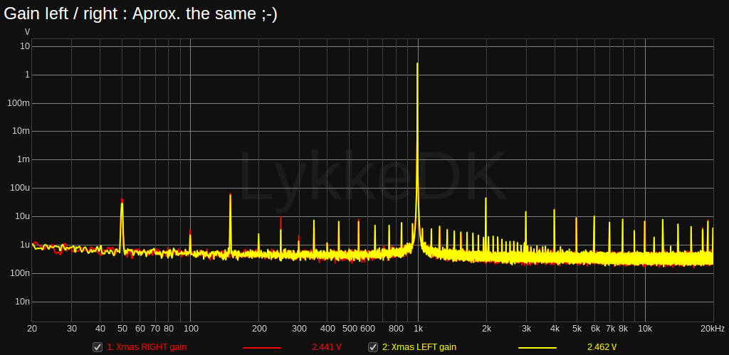

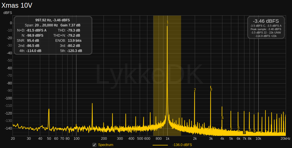

Left & Right channel's are more or less identical, measurement wise, so only showing most Left channel here:

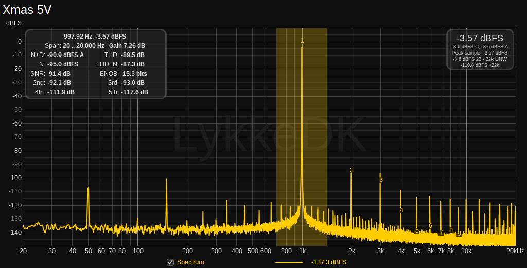

Plain 1V sine into Xmas Amp. ---> NonInductive 8ohm ---> Behringer soundcard.

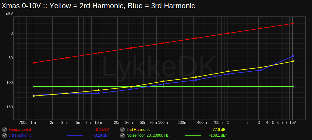

2.8V sine.
Now 5V sine.
And 10V sine.

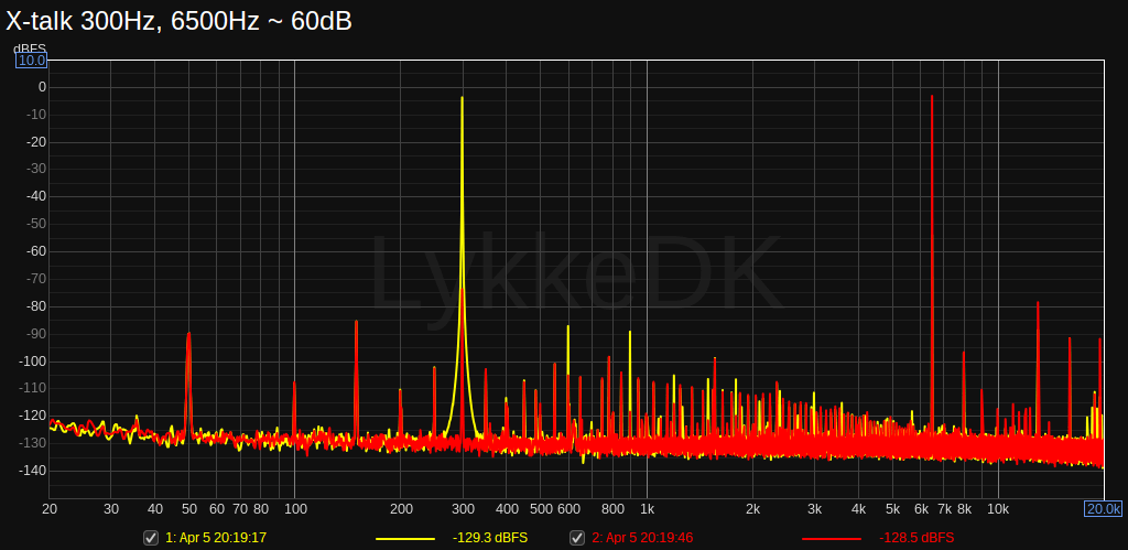

Average crosstalk (Sine's created in Audacity into both channel's).
Again non audible!
THD vs. Voltage show's what the other measurement's also show's... rising Harmonics with voltage.
Gain is very nice I must say the same on both channels... Cool.
2.8V sine.
Now 5V sine.
And 10V sine.
Again non audible!

Hi Jesper,
Nice build and super looking bench! Please share more bench photos in my What’s on the Bench Tonight thread.
We have some identical items in common on our benches. But mine is absolutely messy compared to yours.

Nice build, congratulations (although minus infinity squared for the tidiness of your bench).
I'm also de-bugging ground loops at the moment, trying to use X's diagram.
Please can you describe, or point me to, the Y-GND schema you landed on?
This is my first build, and that's not an approach I've come across yet. I decided on a dual mono build, which is double the fun to learn on.
Regards, Haden
HI @Hadox
I'am using a testrig as you can see in my post to measure the amplifier, where groundloops also can be seen.
I was never really able to actually hear it with my ear's.
I use as I wrote a plain old GND "Y" connection, where all GND's are connected in a single point. This setup was giving me the best result's measurement wise that is.
(All input ground (RCA's) + output ground (loudspeaker) + PSU ground's + Heatsink ground + chassis ground etc...)
