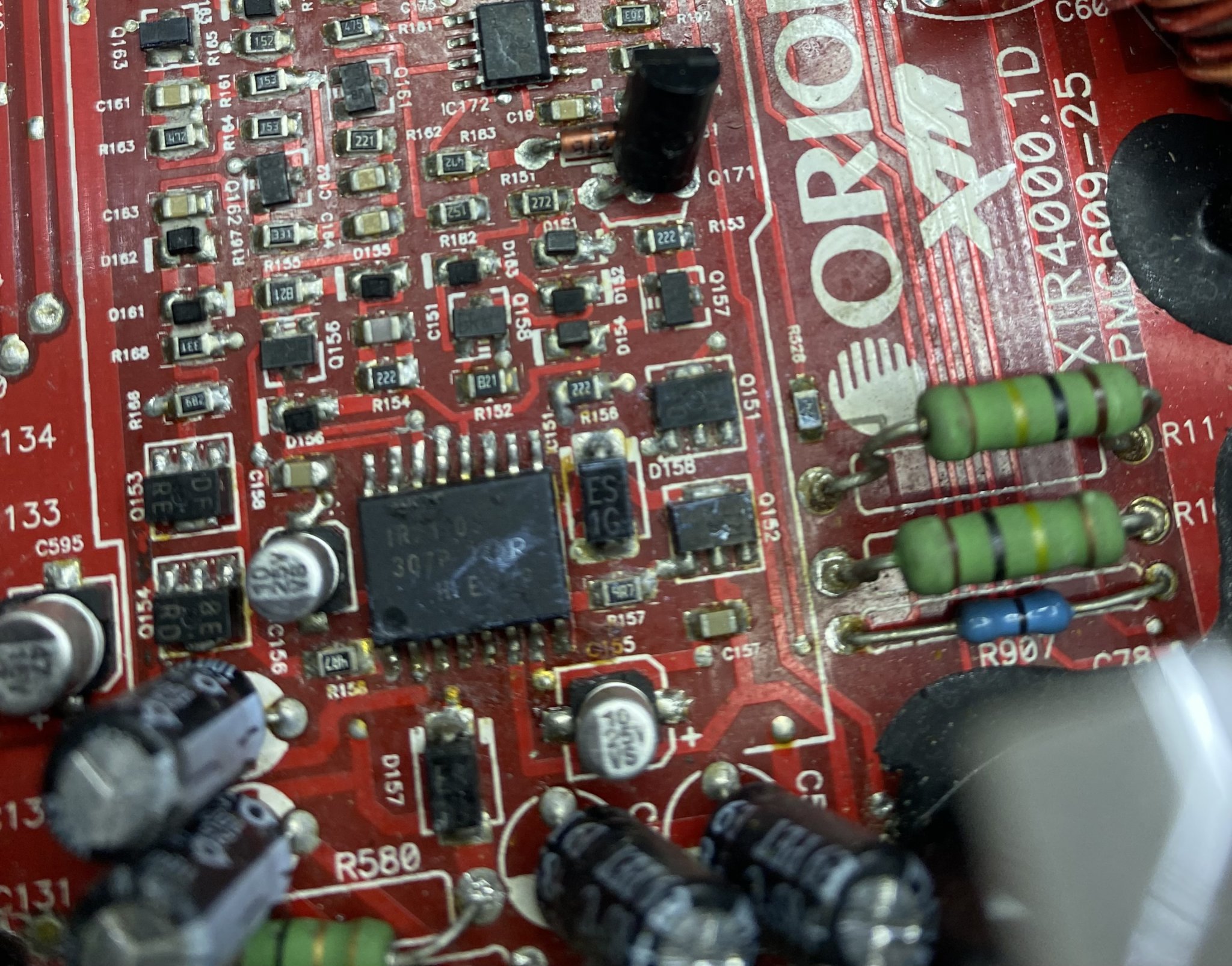

XTR 4000.1D
R580 feeds that transistor. You need to follow back from the terminal of R580 that is not connected to that transistor.
Is there a Q71 anywhere in the amp?
The attached is much smaller but has similarities up to the output driver IC. The supply for the output driver should be the same.
  • hertz_ep1d - IR2184.pdf
I did not see a Q71 but there is a Q171 but it is not directly connected to the IC.
Pin 11 is directly connected to Q153 (DF) center leg and Q157 (BR) center leg
