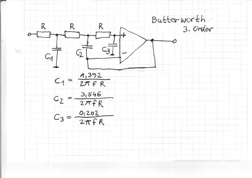

i presume you want to use it in a preamp or so.......
there is a schematic of an active third order butterworth filter.
you can use two filters in series if one is not sharp enough.......
example: with r= 10k and f= 1800hz
you will get around 12nf, 33nf and 2nf for c1,c2,c3..........
greetings............

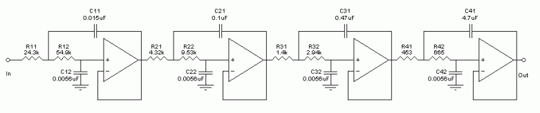

Yes, it is for audio use in preamplifier levels.
It is basically used in a direct down conversion ssb receivers, to cut off the unwanted sideband of the downconverted (to audio) rf signal.

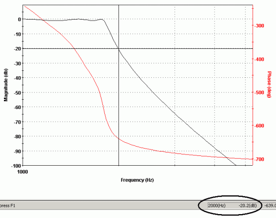

So this has to be as sharp as possible, to ensure that the higher audio frequencies will be attenuated as much as possible.
I did an extended search in the internet for a program to design such filters and I found FilterLab from Microchip company (the one that produces the PC microcontrollers).
I believe it is very nice program but I need your opinion.
I managed to design a filter using this software and I present you the results here to notify me if it is a sharp filter I have designed or not.
Note, I have no idea what phase slope means, but the responce slope seems sharp enough?
yes it is a Chebychev filter indeed. I found it to have sharper cut off and the price you pay is about 1db ripple in the passband (with my attatched design).
I really cannot believe how simple it is to design an audio filter using filterlab, is it really so simple or have I done something wrong?
