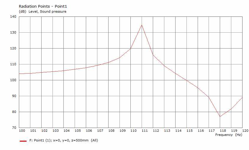

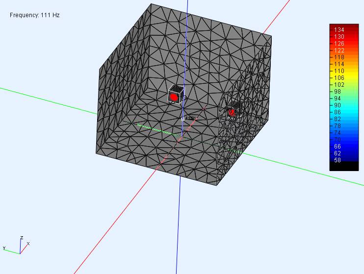

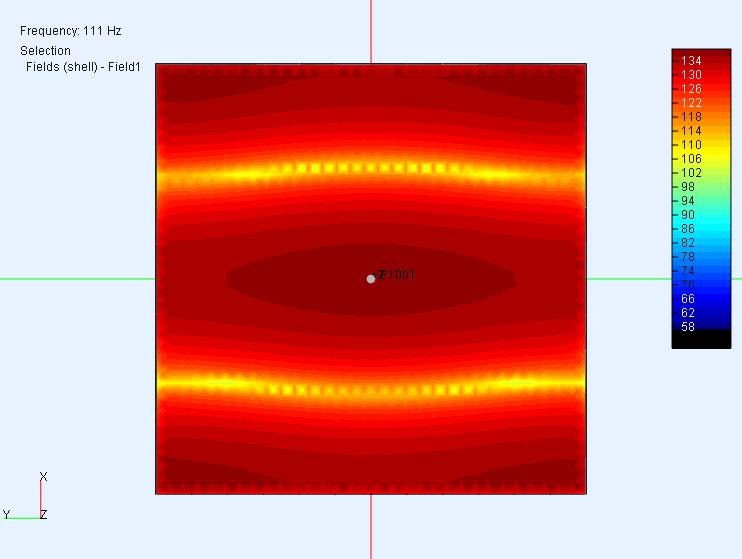

However, if you have a penchant for resonant rooms, L3.055m x W3.055m x H2.4 is tuned to 111Hz. The standing waves will of course have nulls as shown in the pics. I assumed the listening position is 0.5m-1m of the ground. I used 2 speakers on the floor against one wall, however another 2 speakers on the opposite wall could eliminate the nulls.
