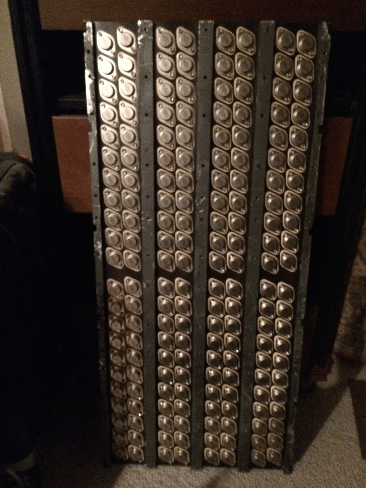

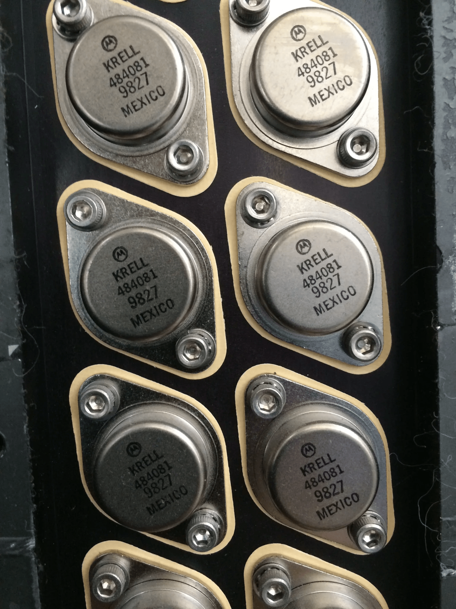

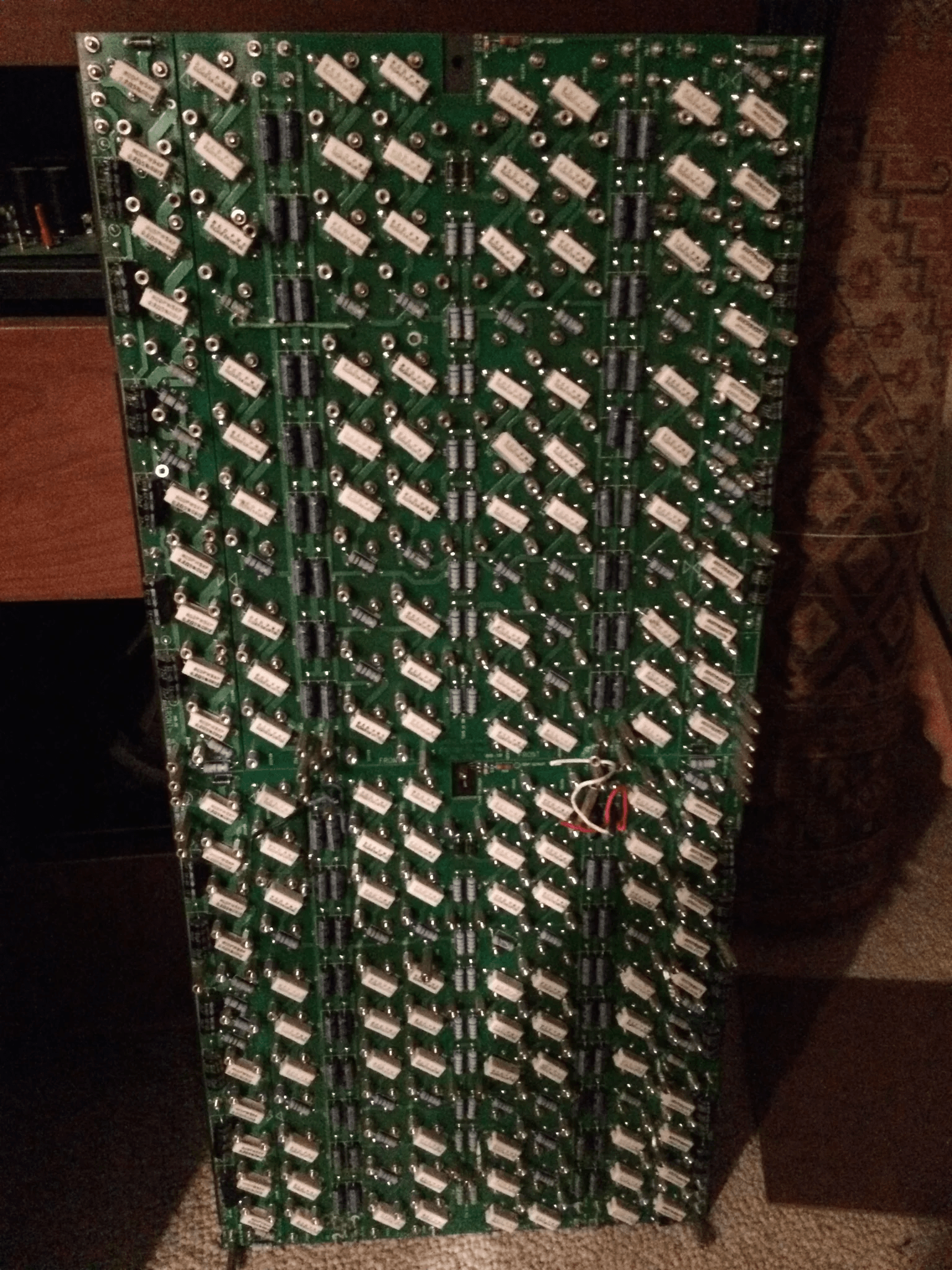

According the attached images from heatsinks of Krell's MRA (master reference amplifier) there are significantly more pairs operate in parallel mode (88 pairs for each channel).
Currently datasheet obviously now for both types:
https://www.mouser.de/datasheet/2/308/2N3055A_D-2309305.pdf

Over here in Canada, we mostly saw English kits and projects. The ETI amplifiers were unfortunately popular - because they were cheap. I can't tell you how many i had to fix. We always had designers using a ton of cheap power transistors in parallel for high power. Stupid. Always "PA amplifiers that never failed", sure.
One reason Krell and others used many power transistors in parallel was to distribute the heat from the high total bias current. To my mind, there is little point in running everything hot when you can get the same or better performance from enough devices for the power and load impedance without the high bias. All they are really doing is trying to get the delta I lower so it is more linear. Brute force and ignorance. I guess if you restrict yourself to a low overall transconductance amplifier you haven't got a choice. My response it that they choose the wrong path to follow. A ton of outputs is expensive and looks very impressive, you can spin a great story and charge more for it. So really we are talking about market differentiation. Not true performance or engineering skill.
Ever work on a Krell? Not fun. Soaks up bench time (= high labour charges), plus they are so hot, capacitors need replacement. Every 10 years is what is quoted around here. That's expensive man! Plus your running power costs, let's not go there.
