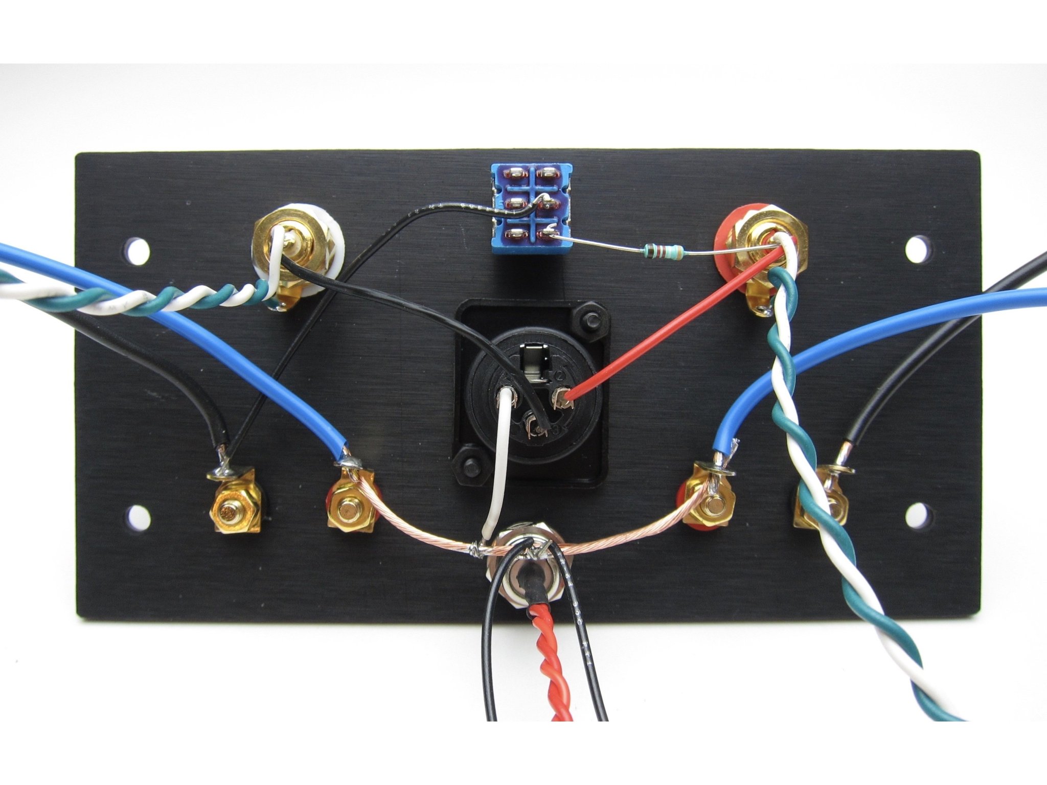

Hello again,
I bought a 3 way 6pin toggle switch and wired it according to v1.8 instructions.
All the setting work in stereo - no mono (considering I will use 2 monos this is a problem)
Short of getting another switch does anybody have a suggestion.
Thanks for your help
(btw Parts Express charges 53$, yes 53$ to ship 2 little tiny switches to essentially Montreal Canada so I will not order from them)
Joined 2019
^ Post a link to the switch you bought.
Then, please post clear photos of all your wiring similar to those shown in the build guide. When possible / practical show your comparison photo next to the photo from the guide.
If you wired it like in the guide... and there are no component issues... or solder issues... then it works.
Thanks for your reply - I will recheck all (I know my wiring is correct - I checked just about 10 times against the pictures). So I will redo the soldering (I am a newbie and my soldering job of the back plate is not, let's say, the best) and use a new 3 position switch. Actually I bought it in store and there is no spec on their website. I may have been sold an SPDT. So I will make certain to get a DPDT.
Thanks again

If you got the wrong switch, check amazon for switches.
Look for "On/Off/On" functionality in a 6 pin DPDT switch.
Here's an example in the USA. I'm not sure what your local Amazon MTL warehouse has, but I imagine they have something similar. This is kindof a "jellybean" part.
