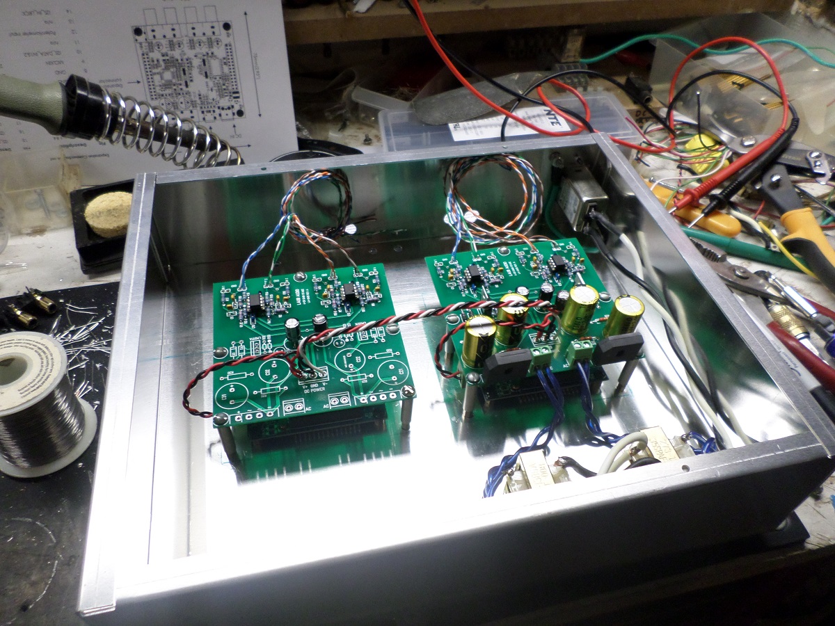

Getting ready for power up and testing. Just wanted to make sure you didn't spot any glaring errors before I do so...specifically, the orientation of the OP amps, I have them with the dot next to R13/R15. Is that right?

The build looks fine to me. Thanks for catching the error on the BOM. You are correct, those are the 68R resistors R13-R16. I must have typed the wrong letter. I will update my BOM list.

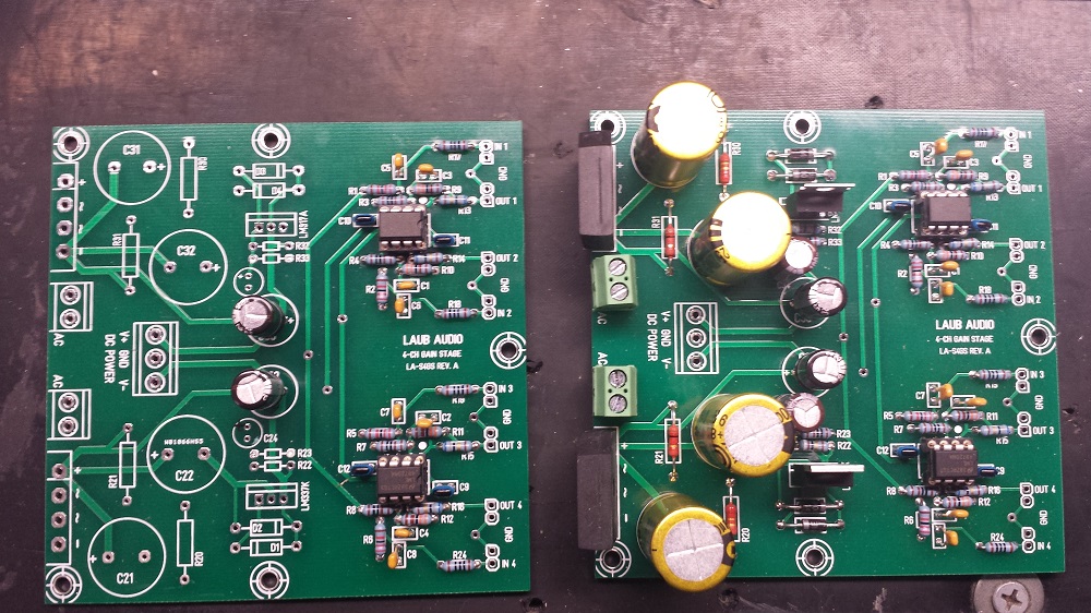

Oh, I think I found an oops, I might have C24 reversed. While I was on autopilot, I mounted it opposite after placing it's brother, but I just noticed you had marked a + with black marker and they should both be placed positive to the left (or up in my picture).

Follow the mark I made for polarity for C24. I corrected an error on the silkscreen using a sharpie to show the correct orientation. You can see it marked on the left board in the image below:
If you powered it up already, don't worry the cap it still OK but you might destroy it taking it out.
Always, always, always double check the polarity when inserting a polarized (e.g. electrolytic) cap.
I haven't powered it up yet. I'll flip that cap around before I do. Luckily, I ordered two complete boms, so I've got two more of those caps should one of the leads pull out.

First power on test, no smoke! I think I might need larger trafos after all, I get +15.06v, -14.89v with just the gain boards (both powered up), plugging in the MiniDSPs drops the positive to +13.89v
Do you think that's ok, or is that a sign that I'm trying to squeeze too much out of these little trafos?
Edit: Oh, I forgot to mention..yes, I did destroy that cap getting it out. Part of the issue is the legs on those caps just baaaaarely fit through the eyelets on the board. It looks as though they're a bit bigger than the silkscreen on the board suggests it's expecting, so even after being vacuum desoldered, it still took pliers to liberate the legs from the board. Even the first time, they took lots of wiggle wiggle wiggle to get them seated down into their spot.
Oh, and that board was missing the correction, so I feel a little better, haha!

Nice little build coming along there. Here are a couple of thoughts:
The two small transformers are fine for powering the op-amps on the gain stage boards. These don't require much current. On the other hand, the miniDSP does need a hundred milliamps of current or so, and as you discovered when you connect it to the PS the voltage falls. In fact, the positive rail is no longer being regulated when it dips below the 15v nominal level that the regulators are set to and this may induce some noise.
I don't think that you mentioned you would be powering your miniDSP from the PS before. Connecting the digital load may induce some noise into the gain circuit linear supply. Usually you would decouple the supply to the digital circuit to reduce this effect - you would need to insert the L and C components manually. See for info: Decoupling
This still would not solve the problem of the sagging positive rail, however, and a good solution would be to use a separate PS for the miniDSP and connect the grounds. It will be less expensive compared to buying two more transformers. You could fit a small wall wart type of supply next to the two transformers for instance. These are lots of options for around $10 plus or minus. For example, you can find lots of small switching wall warts like this one for $8:

I would stick with 9Vdc supplies or maybe 12Vdc. The miniDSP has on-board 3.3v regulators and the higher the input voltage the more heat they will dissipate. You may already have a regulated wall wart supply in your parts bin but you never know how much radiated noise these generate so try it and see before buying anything.
Sorry that I sent you one board without the C24 polarity correction. I tried to carefully mark each one but obviously I missed it. Also, some manufacturers use slightly different lead diameters and when I was doing the layout I probably happened to pick one with slightly thinner leads. I will open up the hole diameter on the next go-around. Thanks for mentioning it.
Good idea..there's plenty of room in there for another supply, so I'll probably do that. I could always just stick the one I was using in there.
Besides the now additional transformer, I'm almost ready to hook this up to an amplifier and a cheap speaker to make sure it's making music before I try it in my system.
On the 15v regulators, should I be concerned that my negative rail is -14.89v ?
