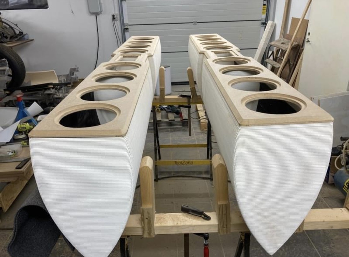

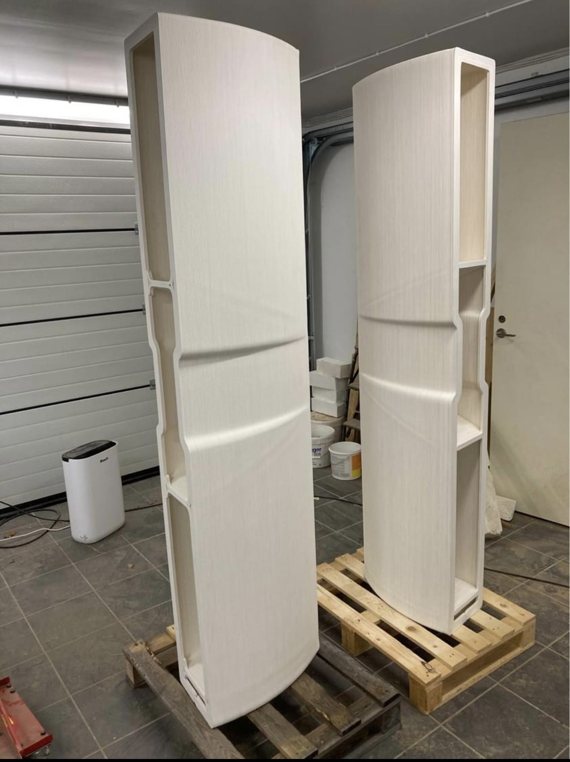

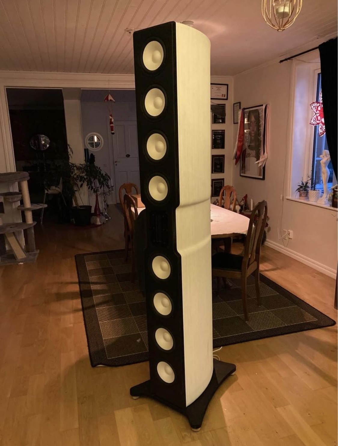

Thanks for all answers, I didnt had time to answer or give more information yesterday but here it comes.
The cabinets (not yet home but they are on their way) are 3D printed and 250mm wide. They have been tried with SB Satori 7,5" like on the picture but I dont have those drivers and I dont know to much about how they performed. My plan is to build new baffles and take care of the outer layer to make them look nice.
I have 4xHypex FA502 for the whole speakers so plenty of power availible.
In my first question I asked for 4x8" per side but I infact think its possible to have 6x8" but the box volume gets a bit small maybe...
Your ideas are very interesting and just throw them at me, when the cabinets arrive I can measure volume etc. more accurate.
Theo

Goregous enclosures, are they printed within 1 piece?!? How thick are the side panels, what material is it?
By looking at the picture, 6x 8" per side might barely fit, but getting really crowded then on the baffle.
4x8" or 6x6.5" seems ideal. 4x8" is the better deal. 6x6.5" may look nicer.
What do you plan for the mids and tweeter?
P.S.: It is not so well to see, but if the enclosures have no stiffening ribs and brackets internally I would add some to avoid panel resonances...

Yeah they look great I think.
They are printed in one piece yes, 16mm thick walls Bitumen maths on the inside. "Woodfilled granule-plastic" something. I might make them stiffer if needed yes, maybe by adding something to the outer layer to, we'll see.
They are build for 8x Satori 7,5" and a Mundorf AMT in the middle. As I wrote Im going to use Purifi 6,5" and Mundorf AMT29 in MTM so I think 6x8" also fits but with small volume behind so 4x8" might be better depending of what woofers I use ofcourse.
