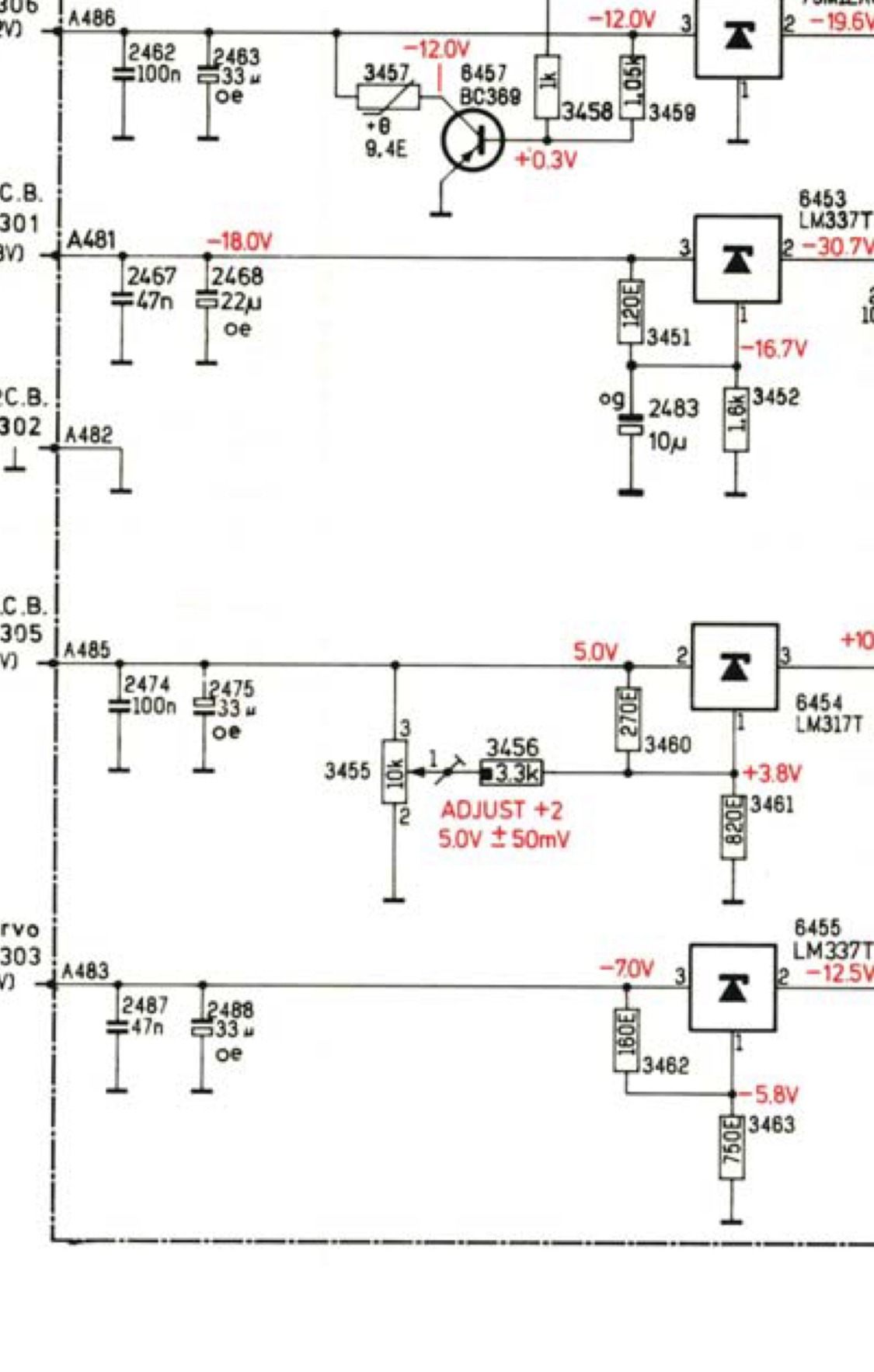

I have replacements for this pot, and in the service manual says that I have to adjust ir, but I dont know how exactly:
It says:
ADJUST +2
5.0V +- 50mv
But I dont understand…. 5V between what points??? Between R3456??

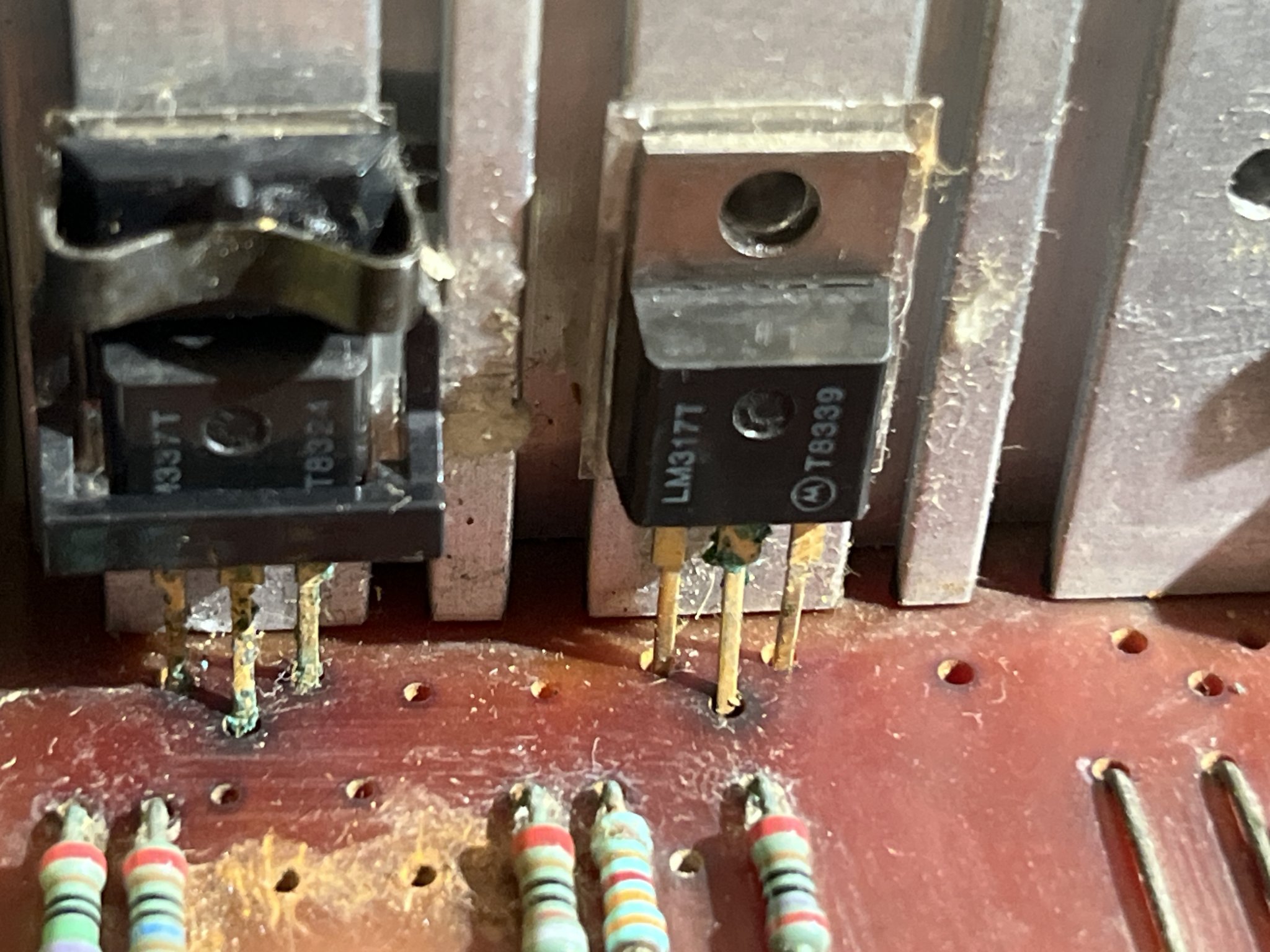

Also I found 4 voltage regulators in the PSU board. The legs of this regulators are oxidated just a little. One of them has the grip broken. May I suppose that the regulators are dead?

The picture of the board doesn't look good tbh. That kind of 'oxidation' and corrosion is typical of spillage and often can be cat pee and the like. It is something I've seen countless times as my time as a bench tech.
The preset simply sets the output of the LM317 regulator to 5 volts which is the voltage across C2475.

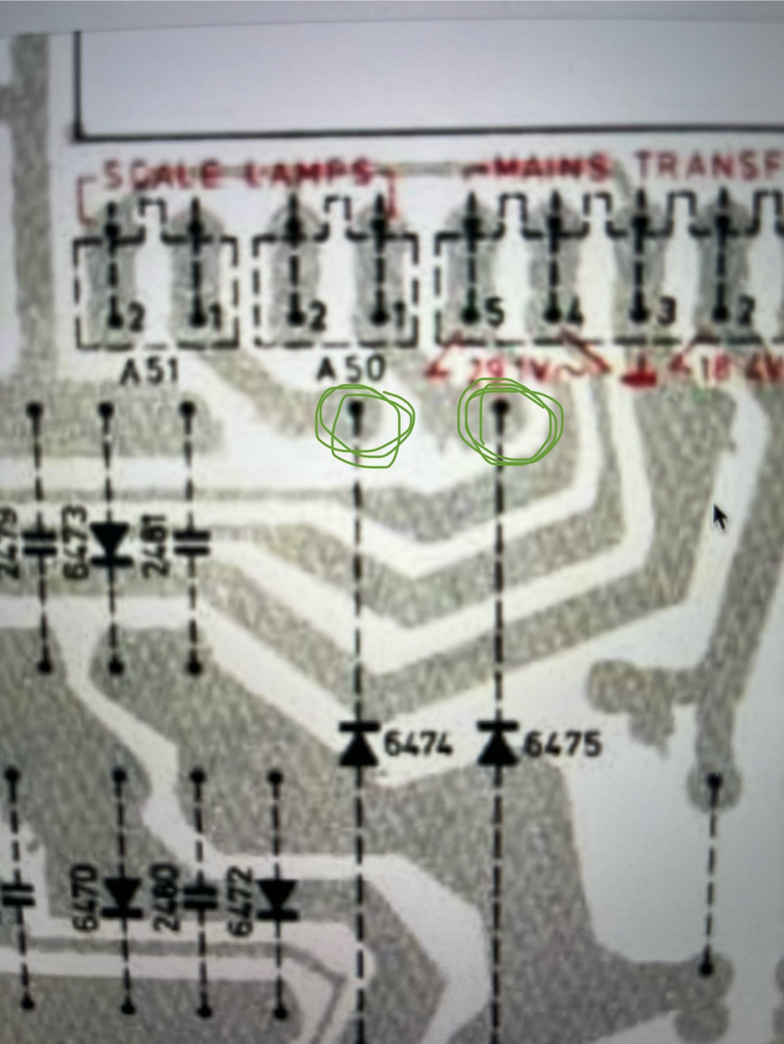

What is that white/silver thing connected to the diode and going to what looks like the mains transformer?
Its a cotton fiber. From the cloth I’m using to clean the board.

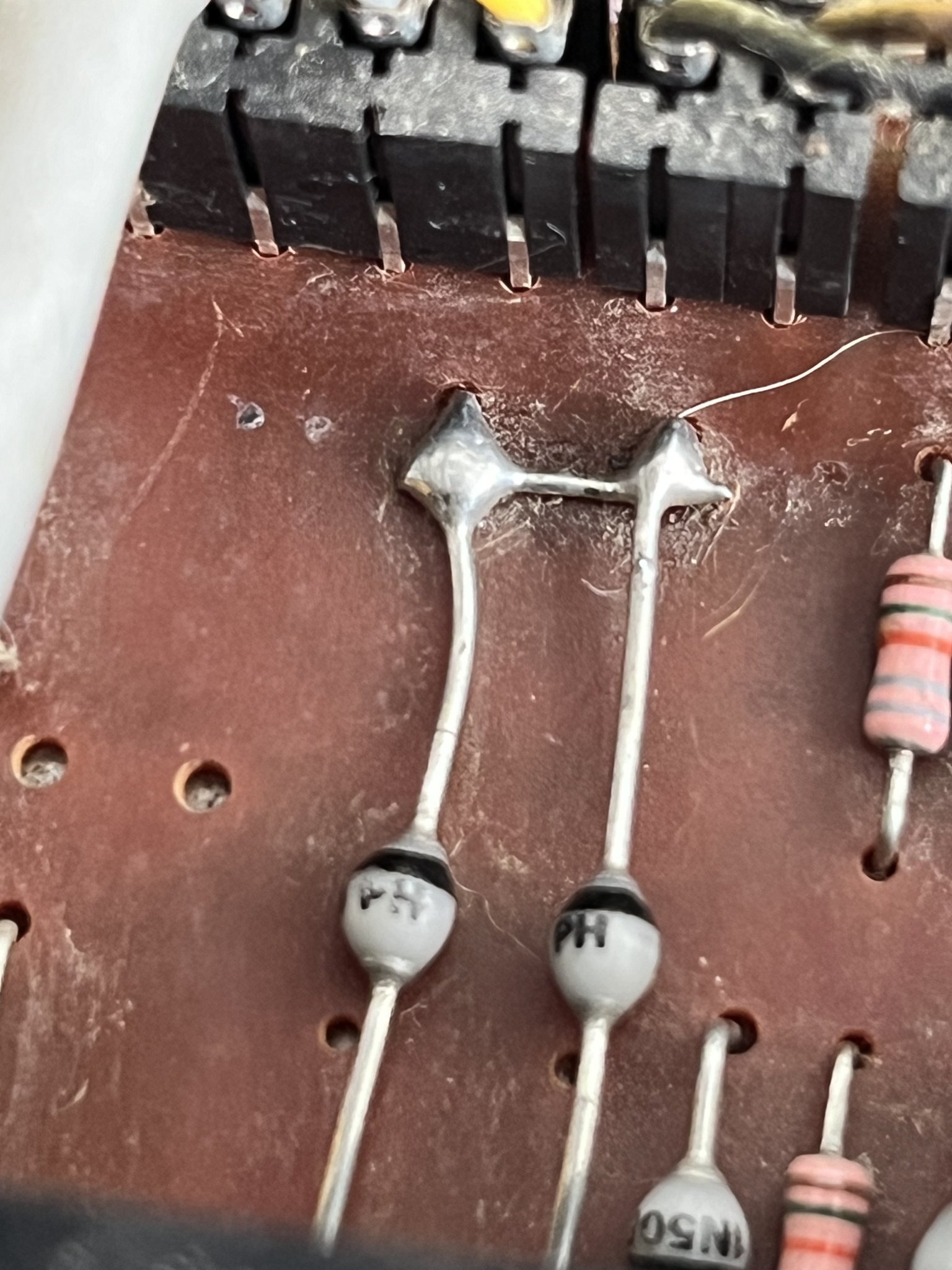

Changed the diode and seems that it's working well (the diode i mean).

Checked voltages and everything is ok EXCEPT two terminals: -7v and -18v
-7v is giving -1,3V
-18v is giving -16v
Cheched voltage on the voltage regulators and 2 of them are not working well (obvious). This 2 regulators are negative regulators (-7v)
That's why I bought all 5 regulators in the store. Next step is to change all the regulators, apply new thermal paste.

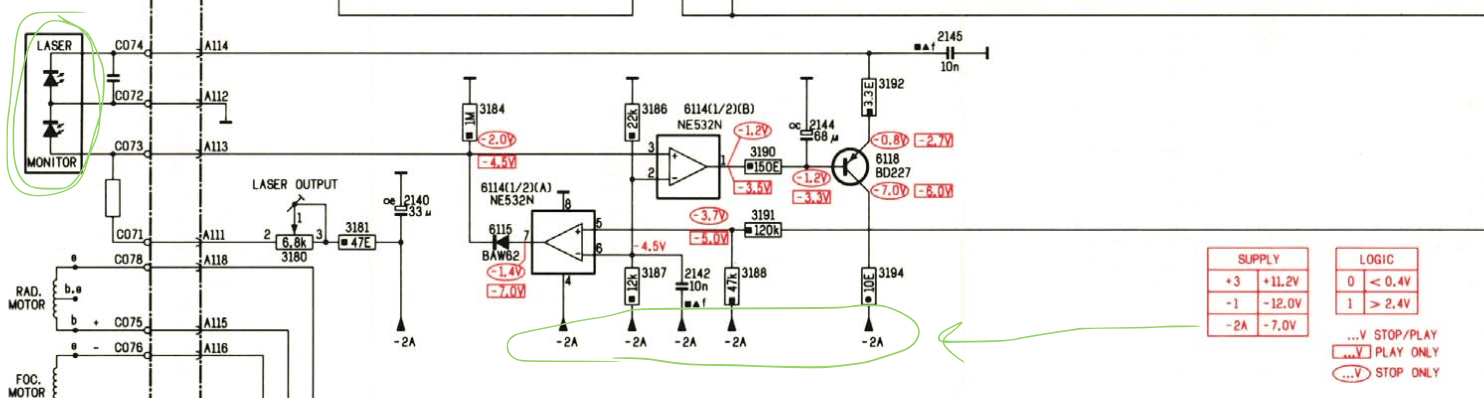

I followed the traces from -7v terminal on the PSU AAAAAAANDDDDDDDD this -7v is the voltage that goes to the Laser circuit:

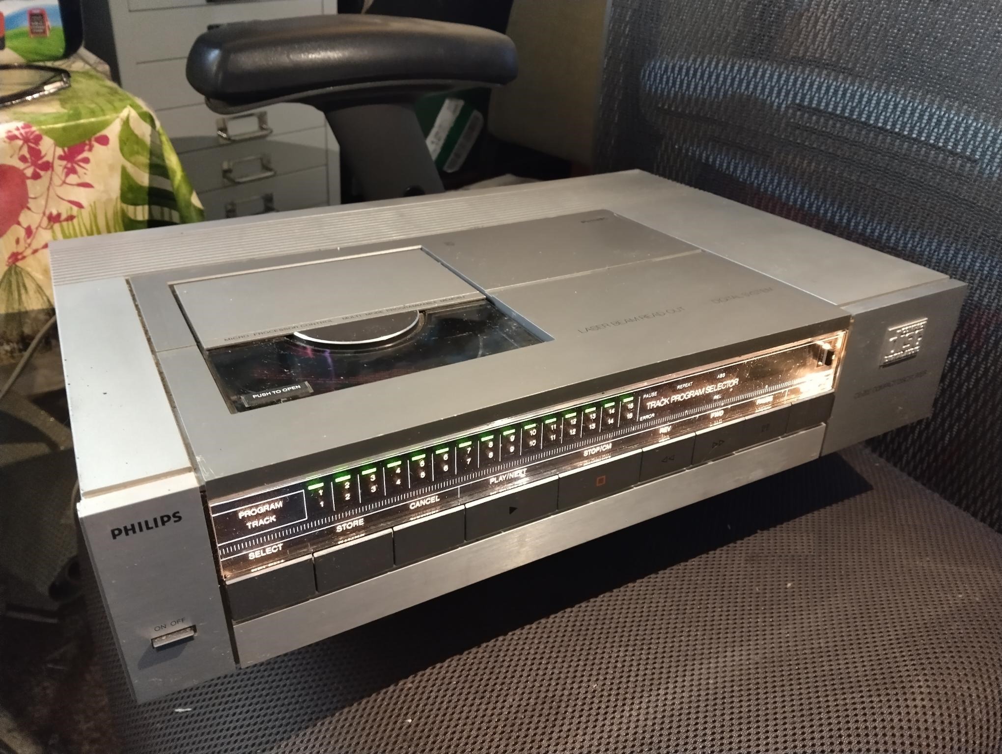

You have given my son (Joe) the enthusiasm to have a look at our CD 202. It seems to have a power on problem (it may have others once on). Here’s ours!

The diode I changed is in the same circuit of the -7v… so I dont know if the fault is the diode or de voltage regulator.

It sounds like you are having fun :) You just have to work through it all and of course getting all the supplies correct is the first step. The BY255 is an type used extensively in TV servicing many years ago. Plenty big enough for anything here.

Before working on this player, no light from laser and no motor spinning. Now the laser is emiting a beautiful red light and motor is spinning. Obviously its trying to read the cd but its not reading the TOC.
As Mooly said, first step is getting all the supplies correct. There is only one voltage to correct (-18v) cuz its giving only -14v

The normal routine at these players is the following:
Insert disc or push Play button, swing arm swings to the TOC area, focus lens moves up/down several times and laser emits light, if focus found on disc only then the turntable motor starts rotating and TOC is read, motor stops and display shows the total playing time and total number of tracks.
Don't worry if the motor does not rotate. It is the sign of focus not found.
