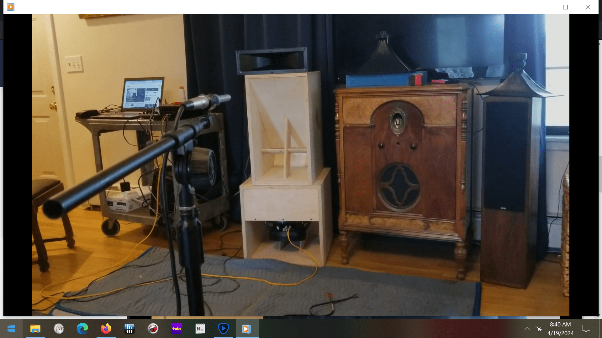

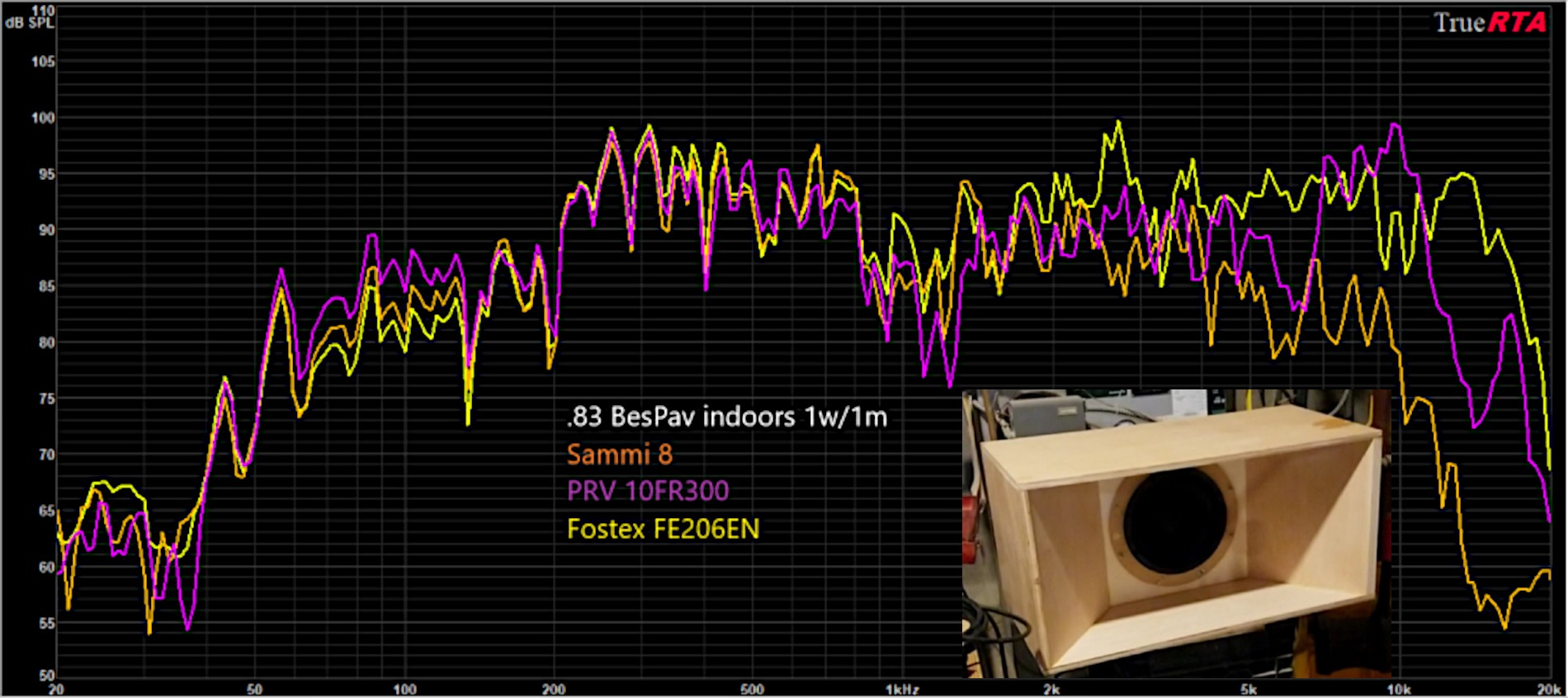

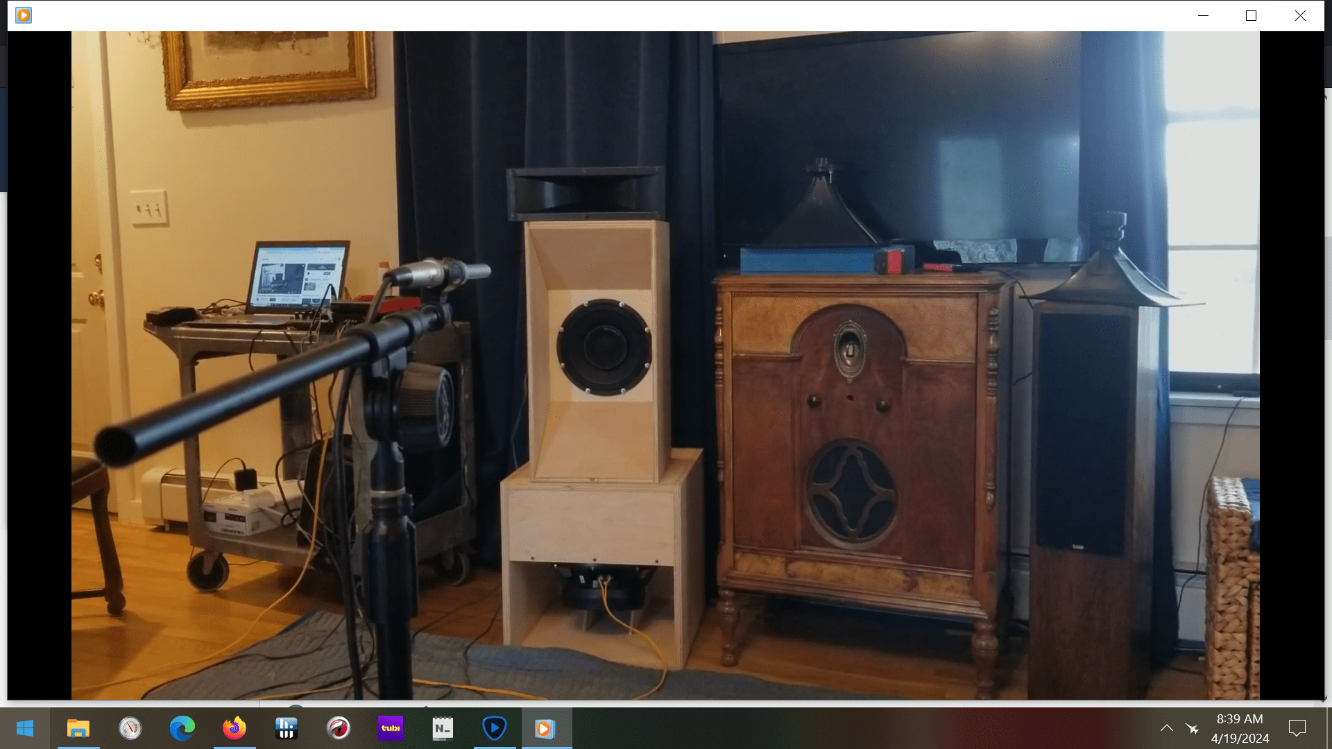

Tri-amped via a PRV DSP unit to Cubo12 and a small rectangular tweeter horn, it sounds in phone clips better integrated and balanced than the excellent smallhorn3 in the same setup. EQ or a better horn driver might make up for that perception. Also, the high xover was 2500Hz - an octave above the intended range of smallhorn3.
At $69. 10FR300 represents good value.
I would post the 30 sec clips but the builder/tester chose copyrighted material. (seems like "fair use" would allow such small snippets - ? (I might be able to do a limited amount via my Google drive w. permissions)
