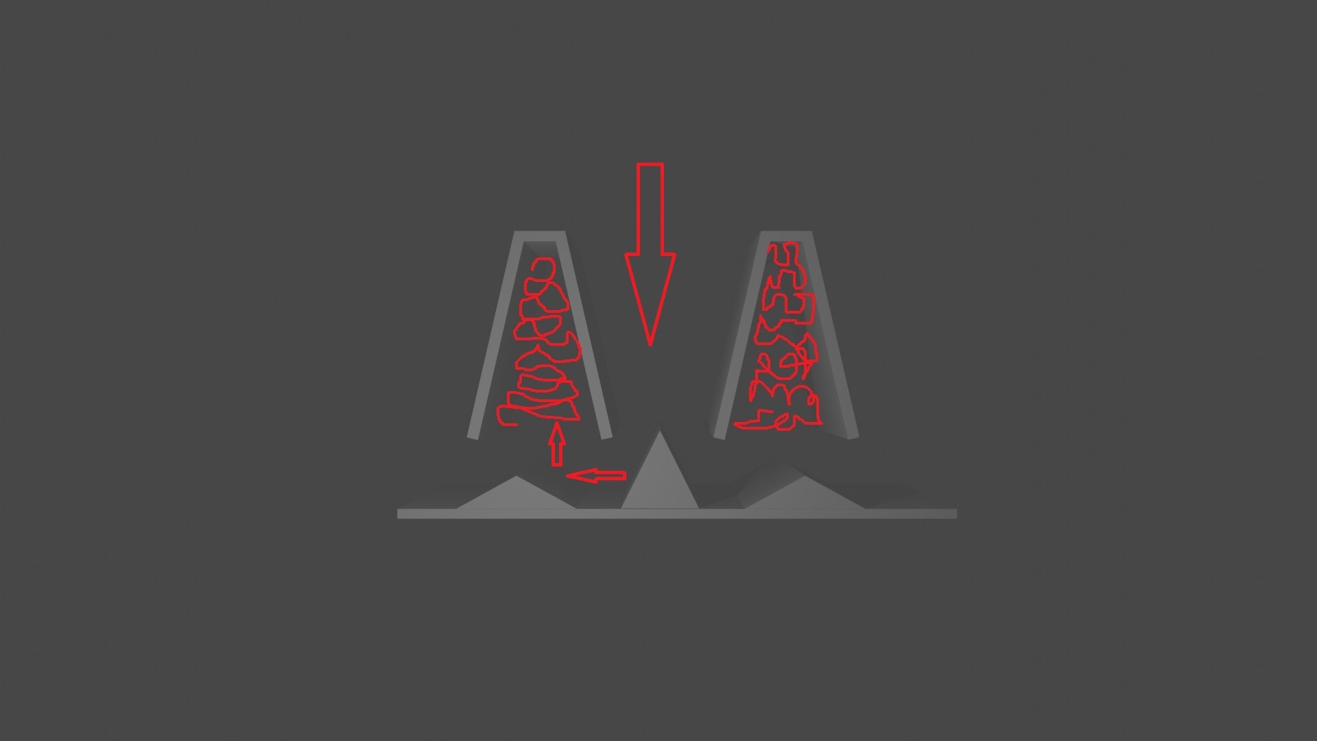

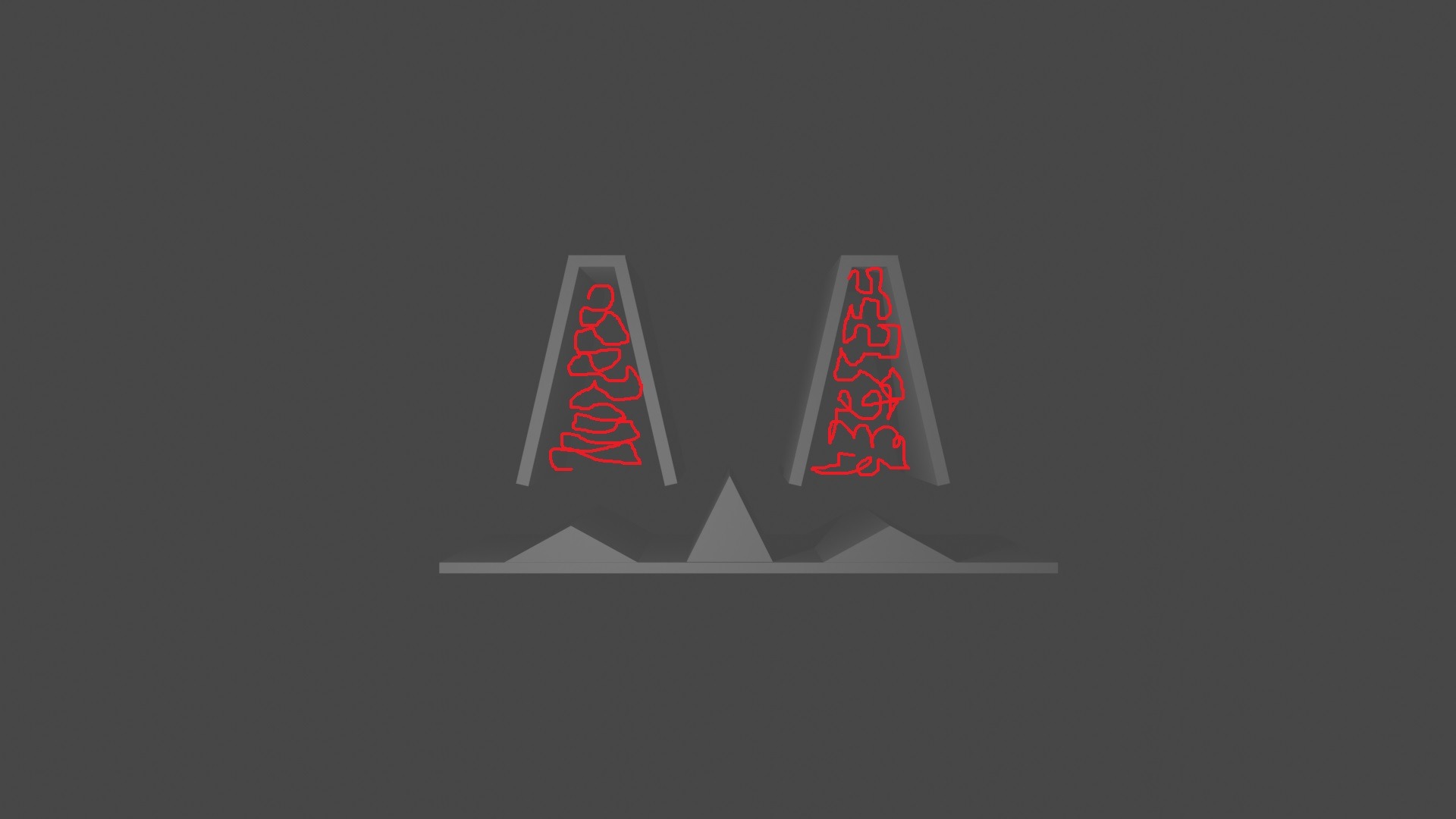

Hi, I would be interested in what you think about such a bass trap.
In my opinion, most bass traps are rather bass slower than real traps.
So I thought it would be possible to lead the bass into a chamber so that it remains there as long as possible.
The "good" thing about the approach would be, in my opinion, that you could also use the large openings as a diffuser through stiffeners.
If I have a big mistake in thinking, please forgive me.
The red lines should represent insulation

Making it slow down might not help since this type of absorption relies on movement.
I also notice that it has to go in and out, a double pass, which is good but it's the same as bouncing off a wall. When a wall is involved, the absorption should be away from the wall where it is moving. You don't want to stuff it somewhere the sound will become trapped.
Reactions: 1 user
Seems overly complicated and non-functional to me. Sound doesn’t get really reflected in the way your arrows point. Also, there are there widely accepted and well described ways of sound absorption: use of porous materials at spots the air movement (which is one dimension of sound) is big, use of sheet absorbers at spots pressure variation is big (the other dimension of sound) or use of (tuned) resonators. IOW your absorber probably works best if you remove the ‘chambers’ around the absorbing insulation. Or if you add some kind of tuned ports to these chambers. The latter gives best chances for a real bass trap if you tune them to the problematic regions of your room.
Reactions: 1 user

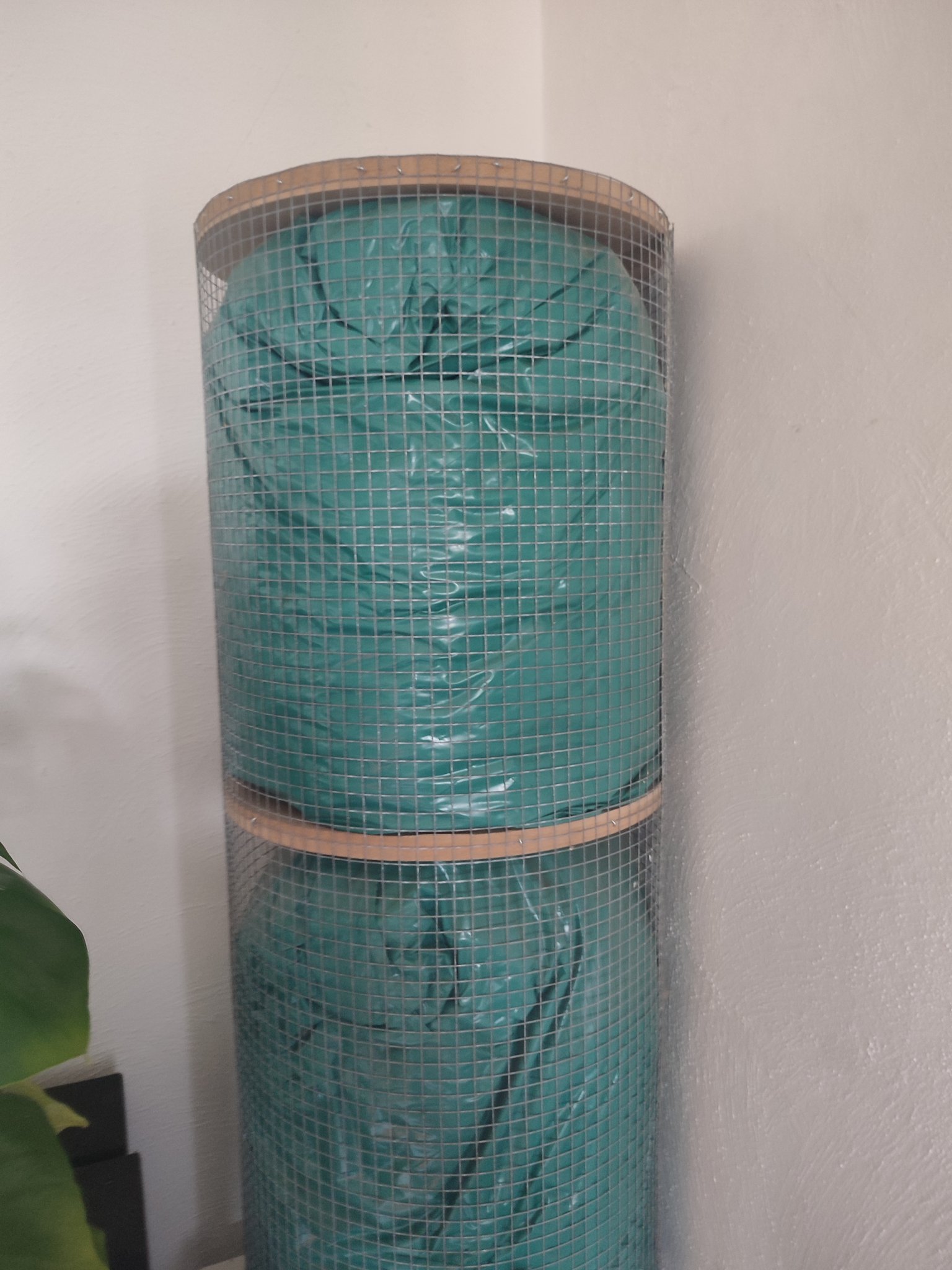

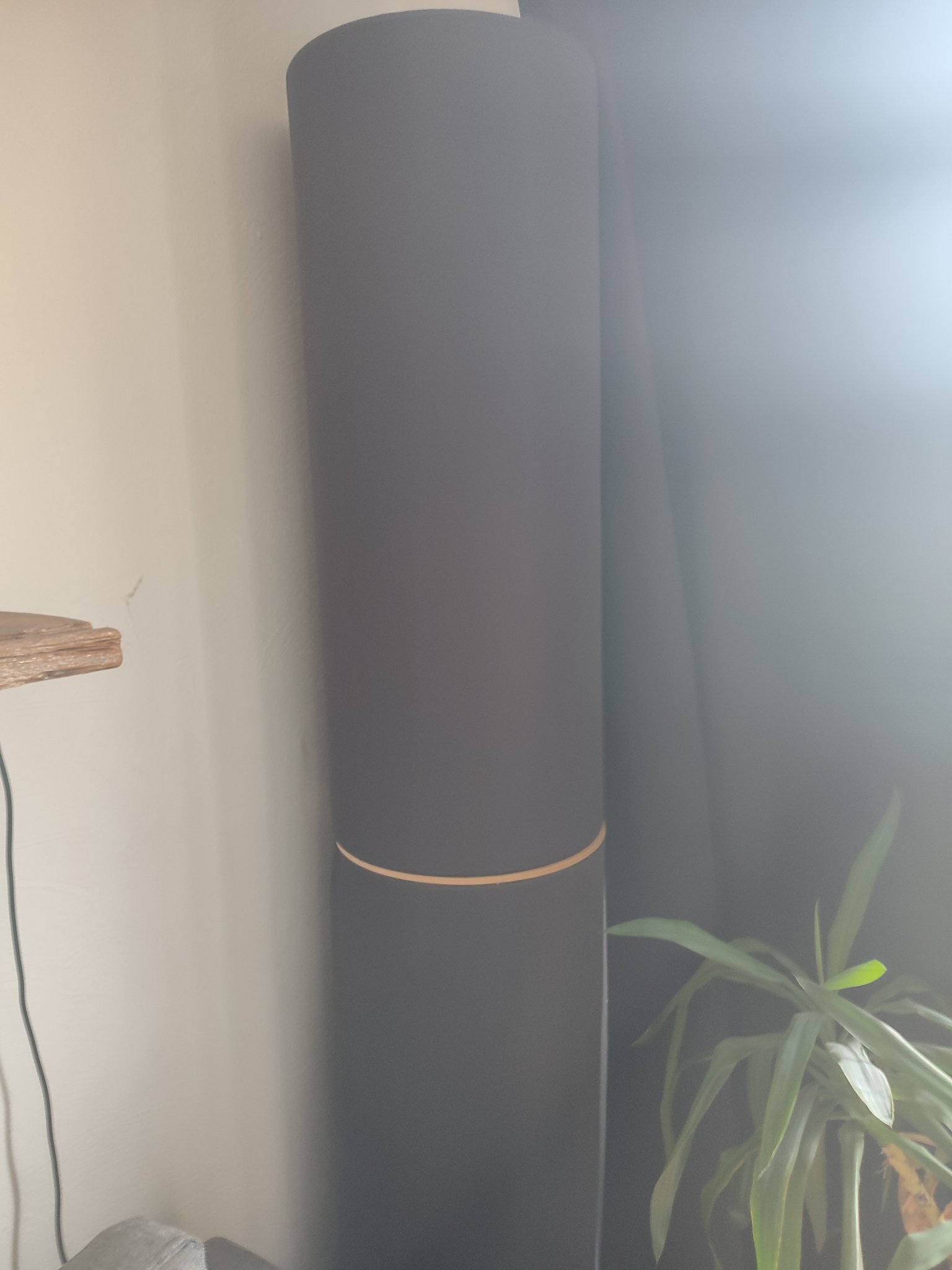

I don't want it to sound like I haven't taken any acoustic measures yet.
I know it might be a bit offtopic, but a long time ago I built some of my own.
Maybe I'll do a tutorial on how I built mine. they turned out well, too. the Last pic ist wip and never finished
Reactions: 1 user

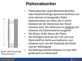

you mean Something Like this.
sorry for the German pic
a s
I read that they lose a lot of their effieciency if you don't do it right, and most of the time you don't do it right.
The plate must be suspended elastically and be the right size i guess
That's why I've never really tried it and why I've never dared to use helmholz resonators, too
