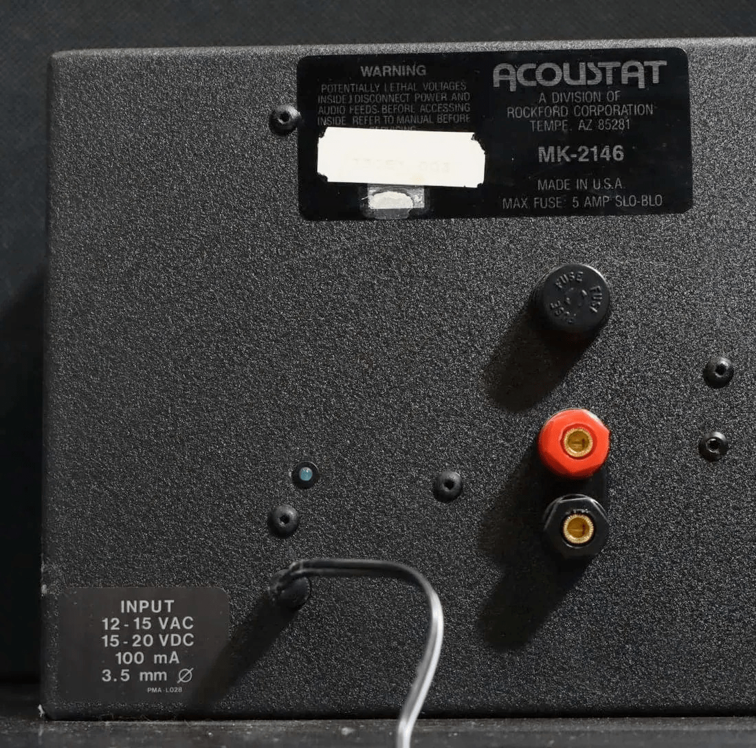

Curious as to why the serial number is blank on these??? How do I tell which is left and which is right?

On the top plates green or red holes with dots on mine I have also put the side designation by masking tape on each of the interfaces. Can also note a designation on the wood on the very bottom of each panel P.S. I will be having to downsize over the next year or two at which time they will be available for sale along with a model 1+1 pair and a single model 1. The interfaces for the 6600 have been updated with all new old stock circuit boards and transformers 2 years ago

I don't know why the serial numbers are blanked out - I'm quite sure it didn't leave the factory that way. My only thought...and it's not a good one, is that the speakers were stolen and the thief blanked out the SNs to avoid identification. Let's hope that's not the case! (And this makes one ponder how one would steal a pair of speakers that big...not impossible, but challenging!) I also note that the box below the serial number has also been blocked out - this field on the label indicates whether the transformers are wired for 4 panels or 6 panels. Also, what are the white squares on the top surface of the interface? And finally, the power-on indicator appears to be a green or blue LED with a bezel around it - Acoustat always used a red LED here, without the bezel. Perhaps this was part of the "recent service".
There are physical ways to tell left from right, but over time, the colored dots may have fallen off, or the top plates may have gotten reversed. The best way to tell is by listening. The high frequencies will seem to be coming from near the inner edge of each speaker. That is, from the right edge of the left speaker, and from the left edge of the right speaker. This is easy to hear with music, and with your ear close to the speaker. Only the panels are left/right oriented. The bases and interfaces are identical.

From my manual for the 6600 "Spectra arrays are MIRROR IMAGE. Each is identified by a small hole located in the TOP METAL CAPTURE PLATE, as well as a coloured dot on the bottom surface of the bottom surface of the array. Red for right and Green for left. The hole is on the LEFT side of the Left Array and the Right side of the array when viewed from the listening side"

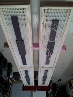

  • What are those gray felt crosses that I saw in a picture posted by Answerman? They would seem to limit highs to the left, right, top and bottom of each panel?

This gets me to those felt crosses (see picture lifted from MrAcoustat's flickr and link to post by AcoustatAnswerMan)
https://www.diyaudio.com/community/attachments/randall-02-jpg.388637/
I am not sure if those crosses live on the rear side, front side or both. If the felt is very dense and they live on the back only, I could imagine they serve as a reflector in the center region, maybe more so for highs if they have a foil or coating of glue where they are connected to the grit.
If so, this would result in a bit of comb filtering symmetrical to the border between the top and bottom panel, but again not what I heard.

The felt blocks are present on the rear of the panels only, so they do not affect the highs radiated from the front of the speaker. Their purpose is to damp unwanted resonances and are a feature of every model produced by Acoustat. Nearly all ESL panels use some form of resonance damping, this is just Acoustat's way of doing it. If the felt pads are coming loose (it does happen), they can be re-applied to the panels using a spray contact adhesive, applied to the felt (only). Once the adhesive becomes tacky, just press the felt back into place.
