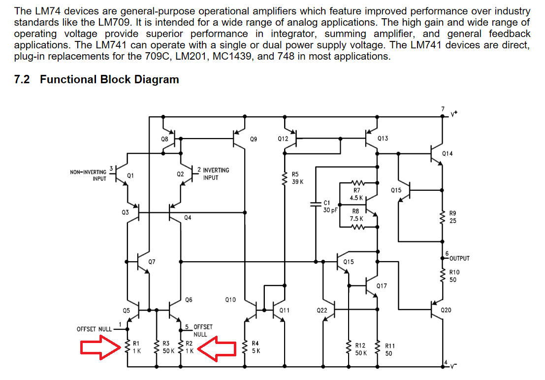

The 5534 nulls to V+ on pins 1 and 8. The 797 to V- on pins 1 and 5. There will be equal resistors if measured at the pins (make sure the voltage burden of your meter is <.5V or you might see an ESD diode).
To verify a genuine AD797 what is the approximate resistance that I should measure between pins 1 & 4 and between pins 4 & 5?
Is 1000 Ohms what we are looking for? (That was quoted above for AliExpress sourced parts in #134.)
The 5534 nulls to V+ on pins 1 and 8. The 797 to V- on pins 1 and 5. There will be equal resistors if measured at the pins (make sure the voltage burden of your meter is <.5V or you might see an ESD diode). Jan, the fakers can't do anything about the pin out.
A real LT1028 would have 130 Ohms rather than 12K on pins 1 and 8 if it was a rebranded 5534.
It would be helpful if you could mention the resistor values that should be measured on a genuine AD797. This is because the attached schematic shows that the LM741 null circuitry has 1k Ohm resistors from Pin 1 and Pin 5 to V-.
And I have pretty good reason to believe that there are fake AD797 that measure 1k Ohm from Pin 1 and Pin 5 to V-... ...and around 1mA quiescent current.
Thus probing with an ohm meter is not going to detect fakes if we don't know what resistance to look for.
Does anyone have a real AD797 that they can probe (between Pin 1 and V- and between Pin 5 and V-) and then post the result?

Thank you for quick tip. I just measured SOIC AD797BRZ's that I bought from Aliexpress couple years back then.
The nulling pins, Pin1 and Pin5 measure exactly 1000 Ohms each to the V- pin as you described. I don't know the original value of the resistance.
They were arrived in sealed reel sheet. But pressed numbers at bottom varies like 48D04, 48C50, 48C62 which looks fishy. Probably numbers must be same if they were really on same reel. I never used them to judge their performances btw.
1000 Ohms is the value shown on the LM741 schematic between those pins.
Can you measure your AD797BRZ and post the quiescent current? (Depending on your meter you use could possibly use something like a 1 Ohm sense resistor in between pin 7 and your positive supply.) I wonder if those AD797BRZ are fake.

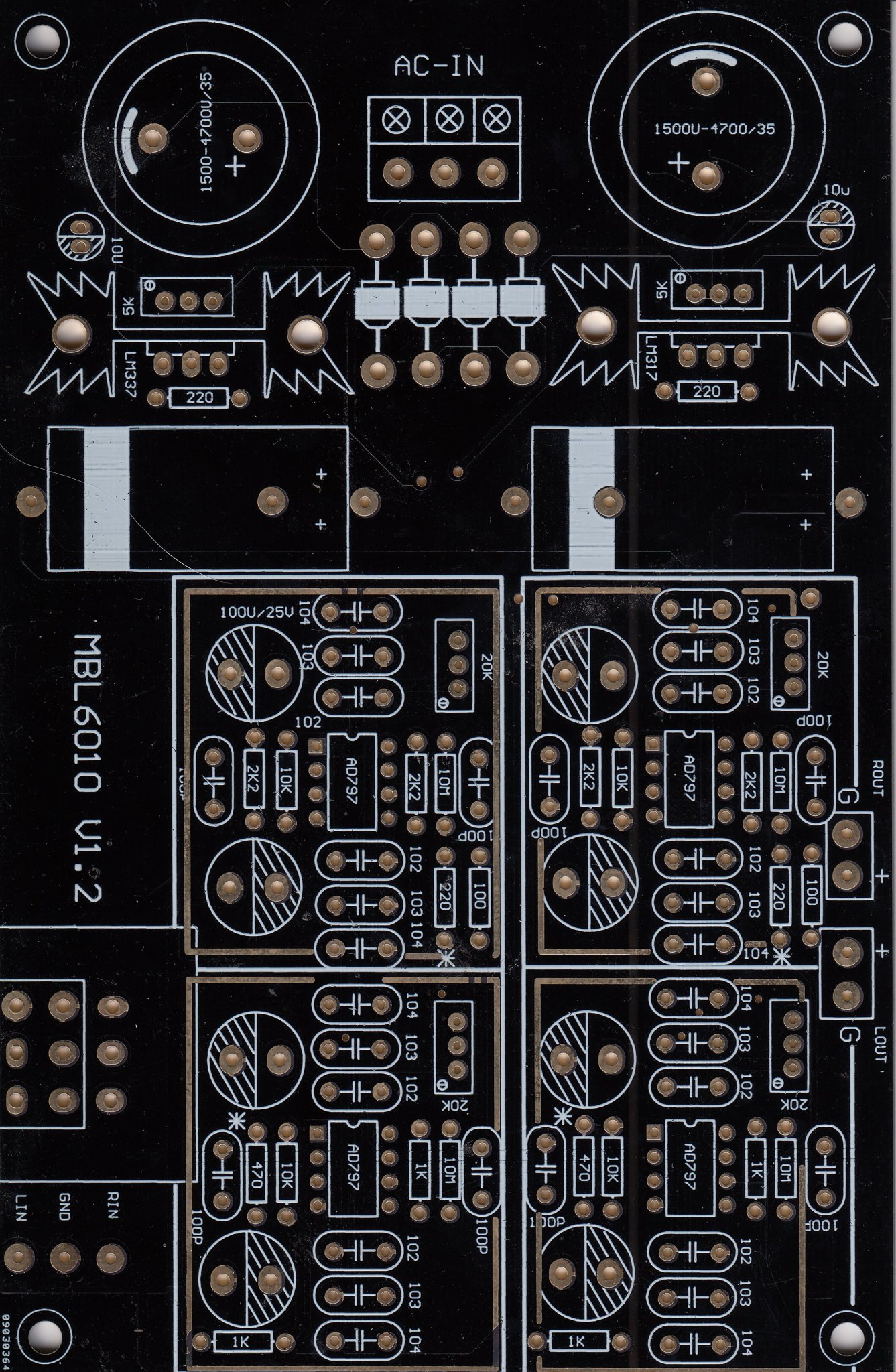

I haven't made partial replacements. I have changed everything, altogether: with components purchased from Farnell (reputable UK supplier from Leeds). Just the bare board was from China (Aliexpress).

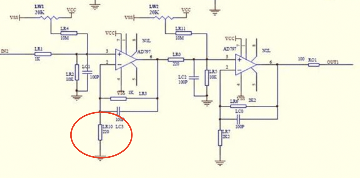

Dear @Berlusconi
Thanks for your posts on this project, helped me a lot.
I have a question though... Where did you take the parts values from? You used the PCB and values from there or from the schematics? I'm particularly interested in resistors - If I see correctly on your pictures, you used 470R instead of 220R in one place... Any reason for this change? Have you made also other changes?
Thanks!

Dear @Berlusconi
Thanks!
Hello Pawlok,
I have strictly used the values from the PCB. It is difficult to read from the photos at Aliexpress. Also, it is difficult to read color bands from photos because reproduction of colors on photos isn't accurate. Even if you read from the actual resistor directly, it is impossible to know with certainty which values they have.
Just look at the snapshot below. Values are on the silkscreen.
Please let us know about your experiences with this project.
Good luck

Hi guys, arrived really late to the party.
I've seen several diagrams for this preamp, some have 50K trimpots, others have 20k trimpots.
Looking at the PCBs online, some have 102, 103, 104 capacitors while others have 102, 103, 224.
Mine was prebuilt from supplier but I want to replace the components for new ones, bought from a respectable supplier.
I have AD797 chips bought from an electronics supplier so they should be the real deal. Thing is, they didn't sound good at all when I replaced the ones that came with the board.
Which diagram should I follow to get it working properly?
Thanks in advance for any help you may provide
