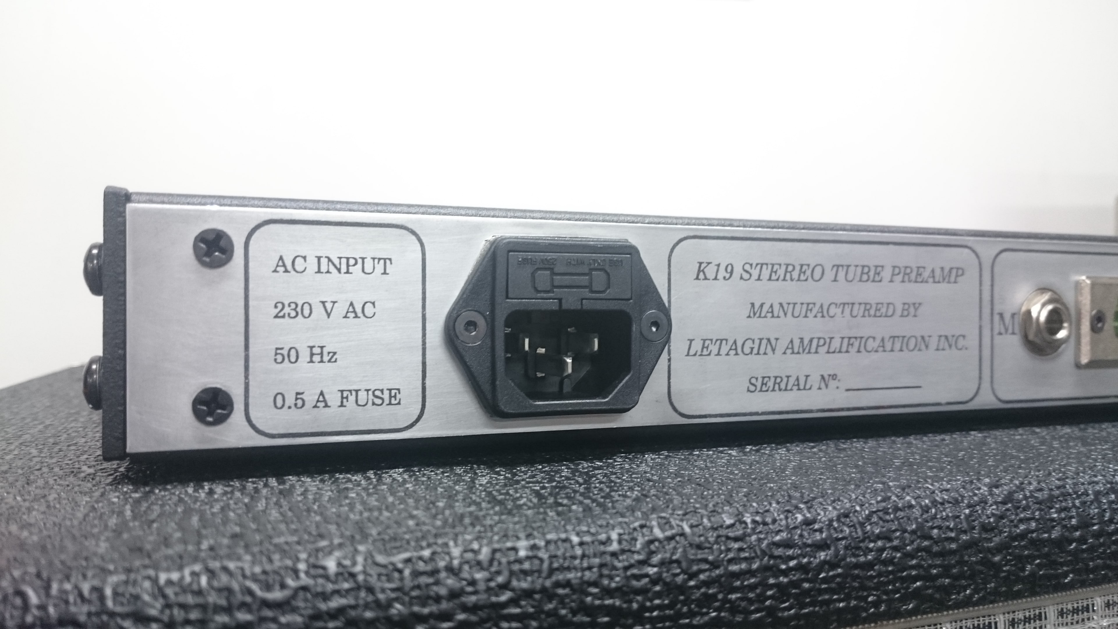

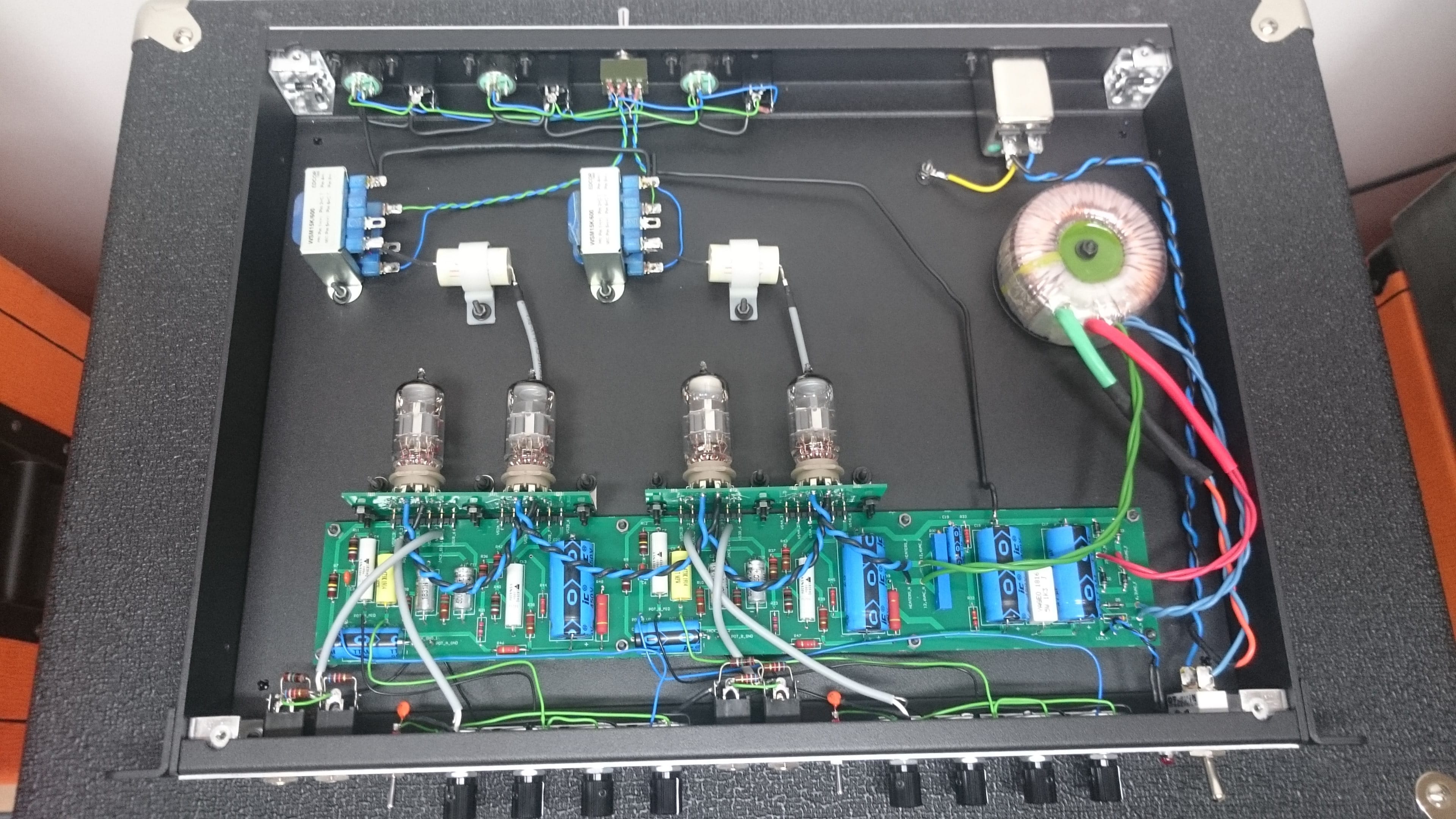

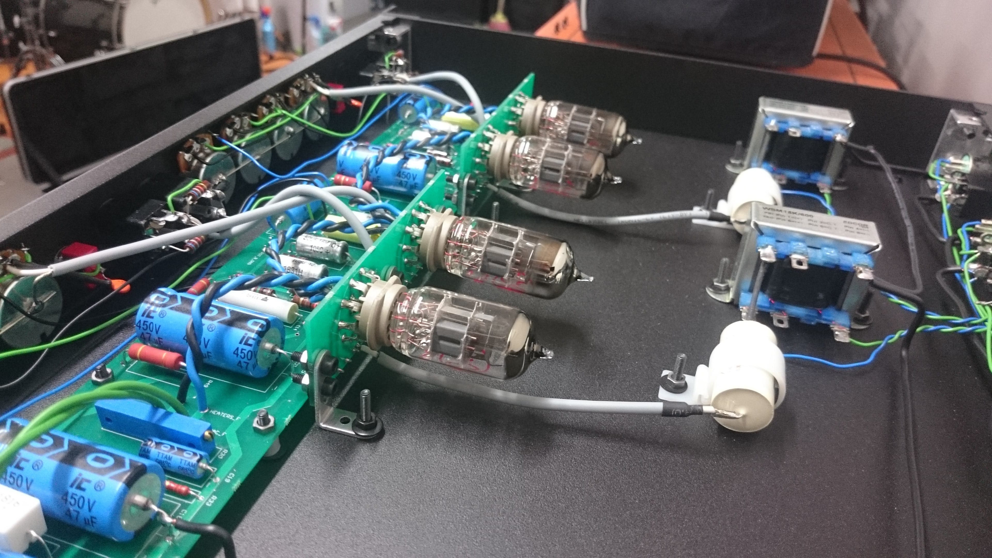

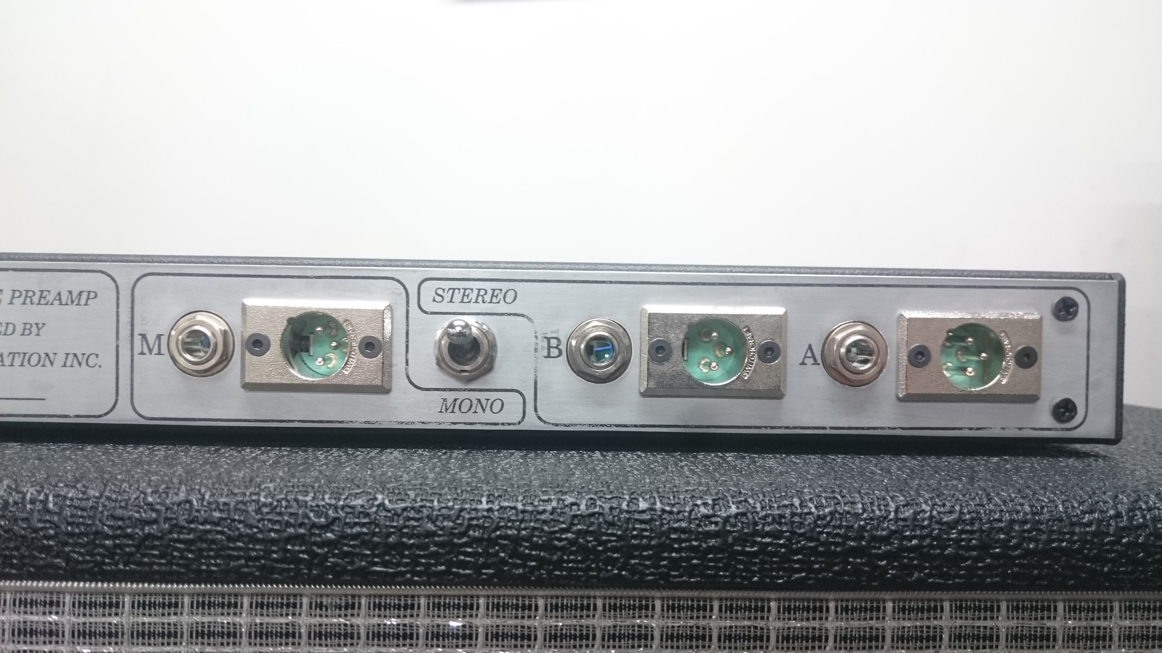

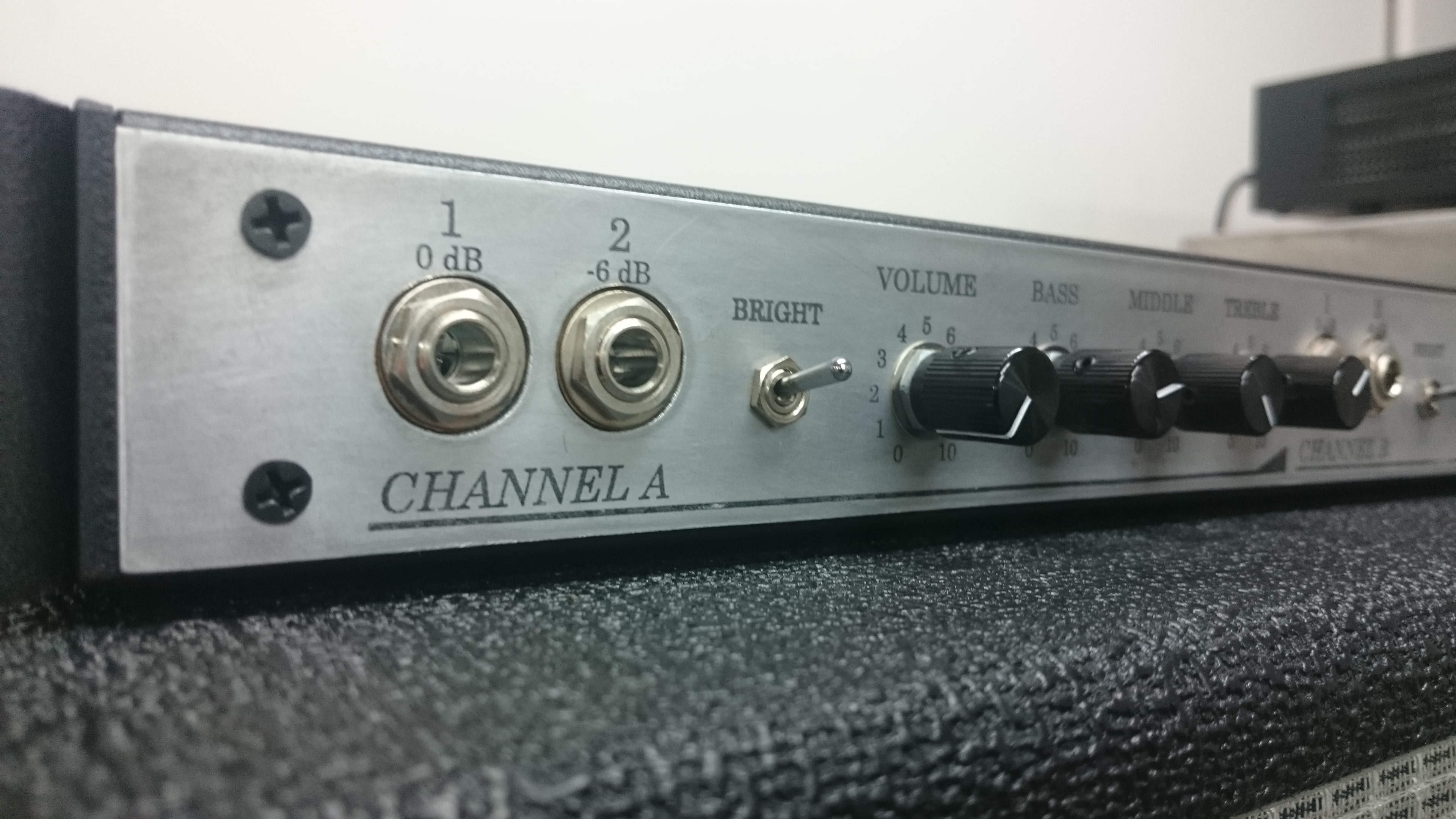

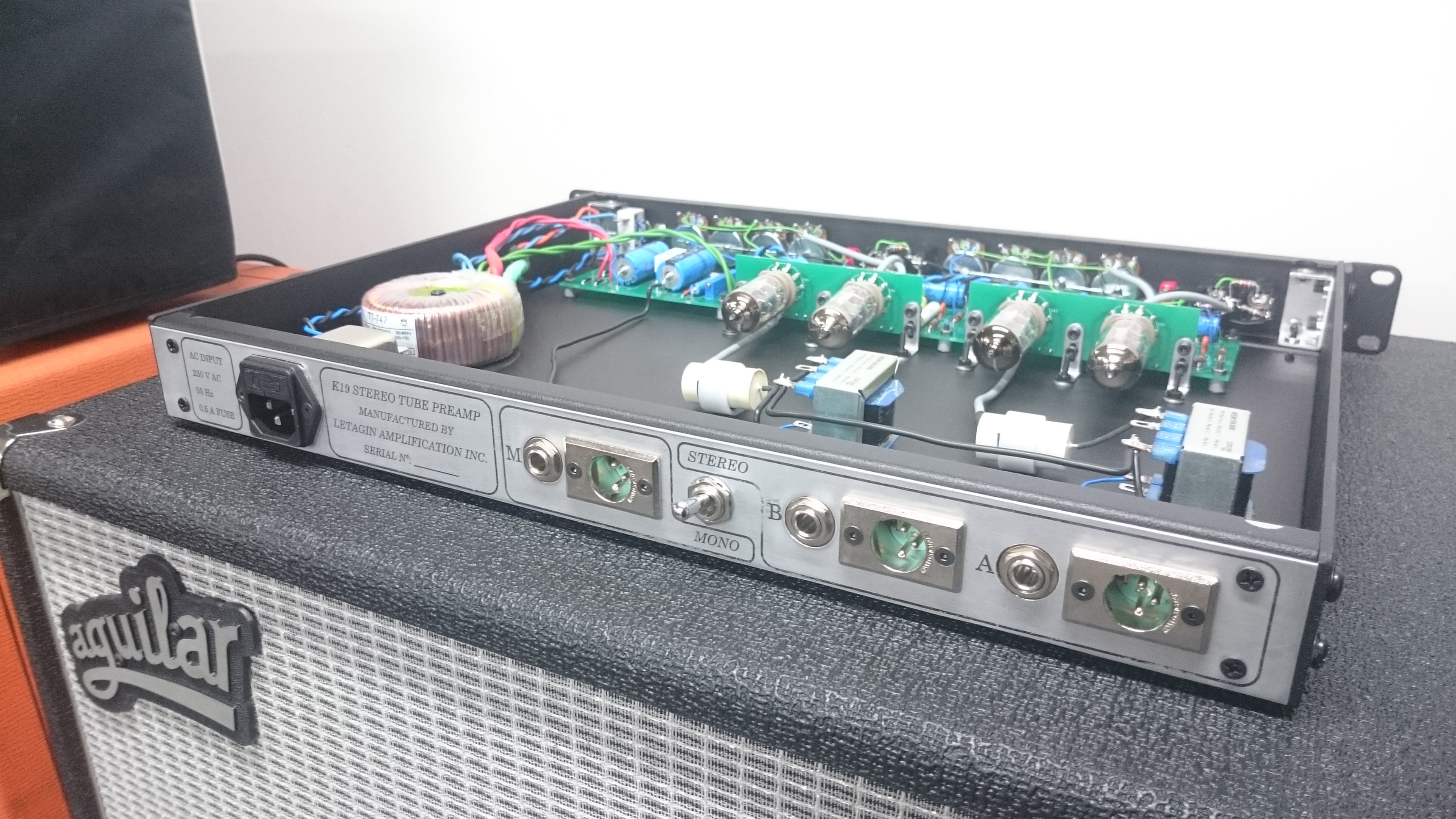

Hello again,
Here some photos of the preamp. A friend helped to design the pcb boards and we ordered them from China. The faceplates are made by me using a laser printer and nail polish remover.

Hello again,

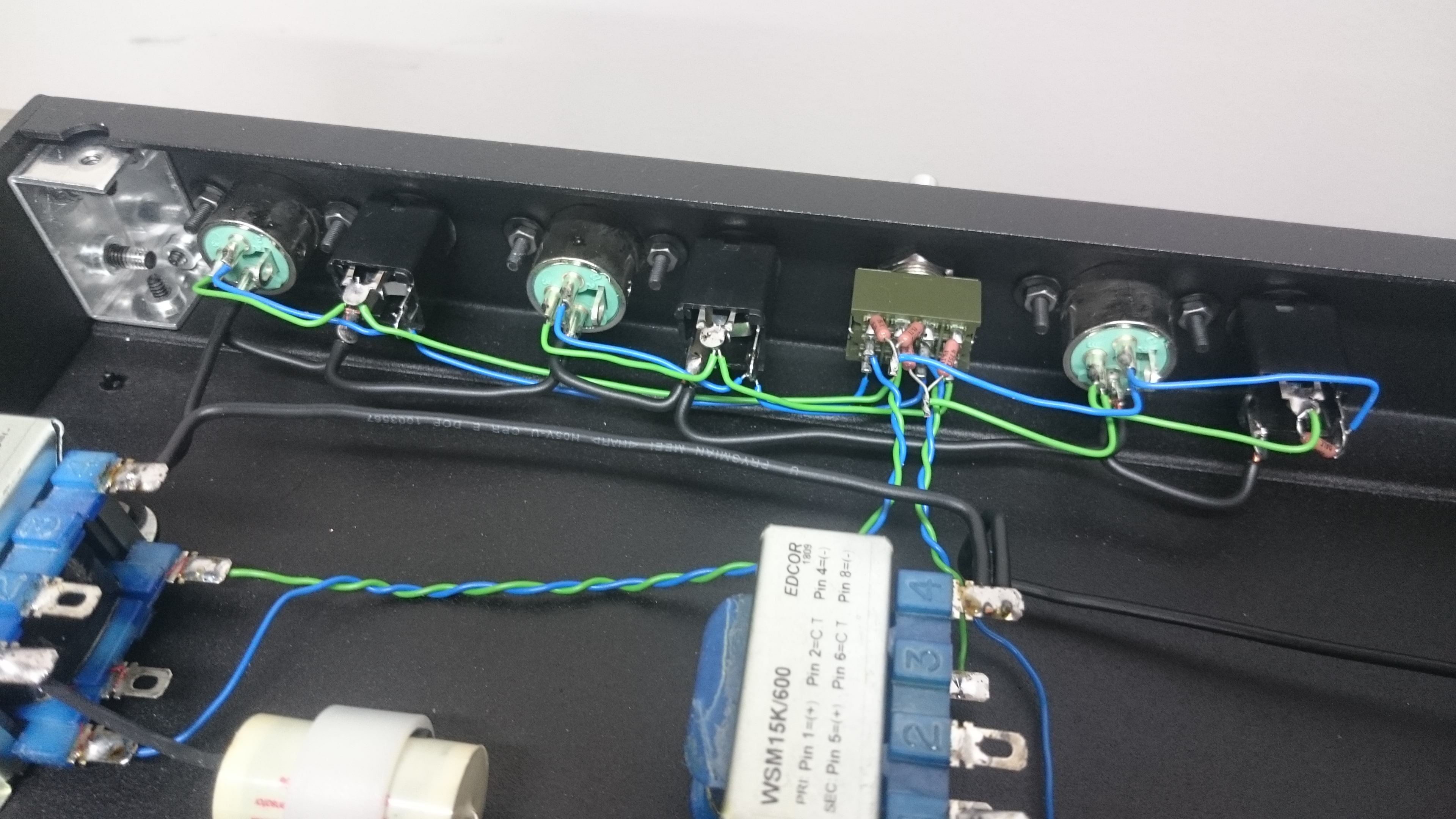

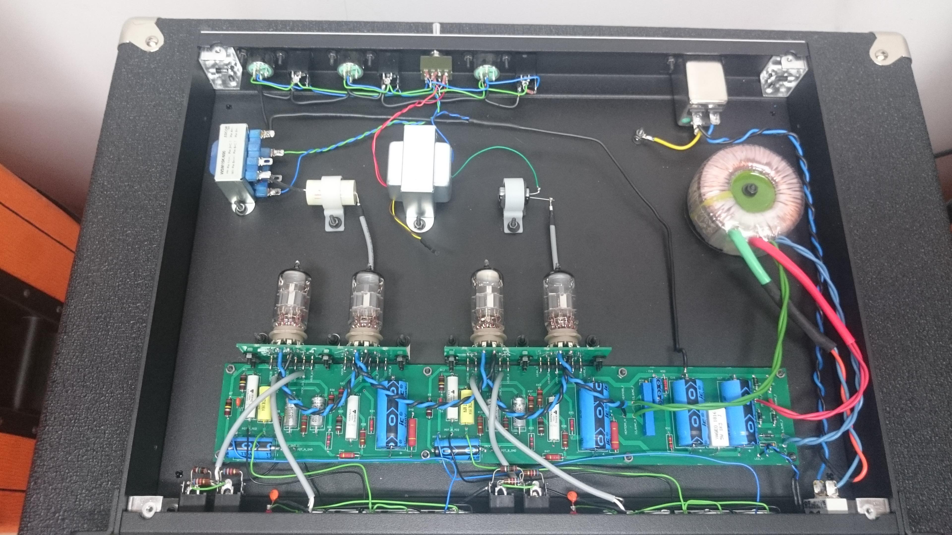

I considered the ones mentioned by Shanx but for the same price range I ordered the Jensen jt-10k61-1m transformer and assembled it in the preamp. Now I have the Edcor WSM 15k/600 in the channel A and the Jensen in Channel B. Both channels are the same. The only diffrence is the output transformer and also the capacitor that goes before the transformer. The Jensen came with it's own capacitor so I decided to install it thinking that it would be the best match. The original capacitors were 2,2 µF (I think they are polyester). The one that came with the Jensen it`s a 22 µF electrolytic cap.
I attach some pictures.
I recorded a short bass riff in the looper and then I recorded it through channel A and channel B. I also recorded the loop through a Darkglass B7K DI. Just to have another reference.
I attach the clip (I had to put it in a zip folder). The order is the following one:
loop 1: Darkglass B7K DI
loop 2: Channel A (Edcor WSM 15K/600)
loop 3: Channel B (Jensen jt-10k61-1m)
Honestly, I think the difference is barely audible (at least for my ears).
It was interesting to make the test but I think the upgrade it's not worth it. The Edcor already sounds great.
