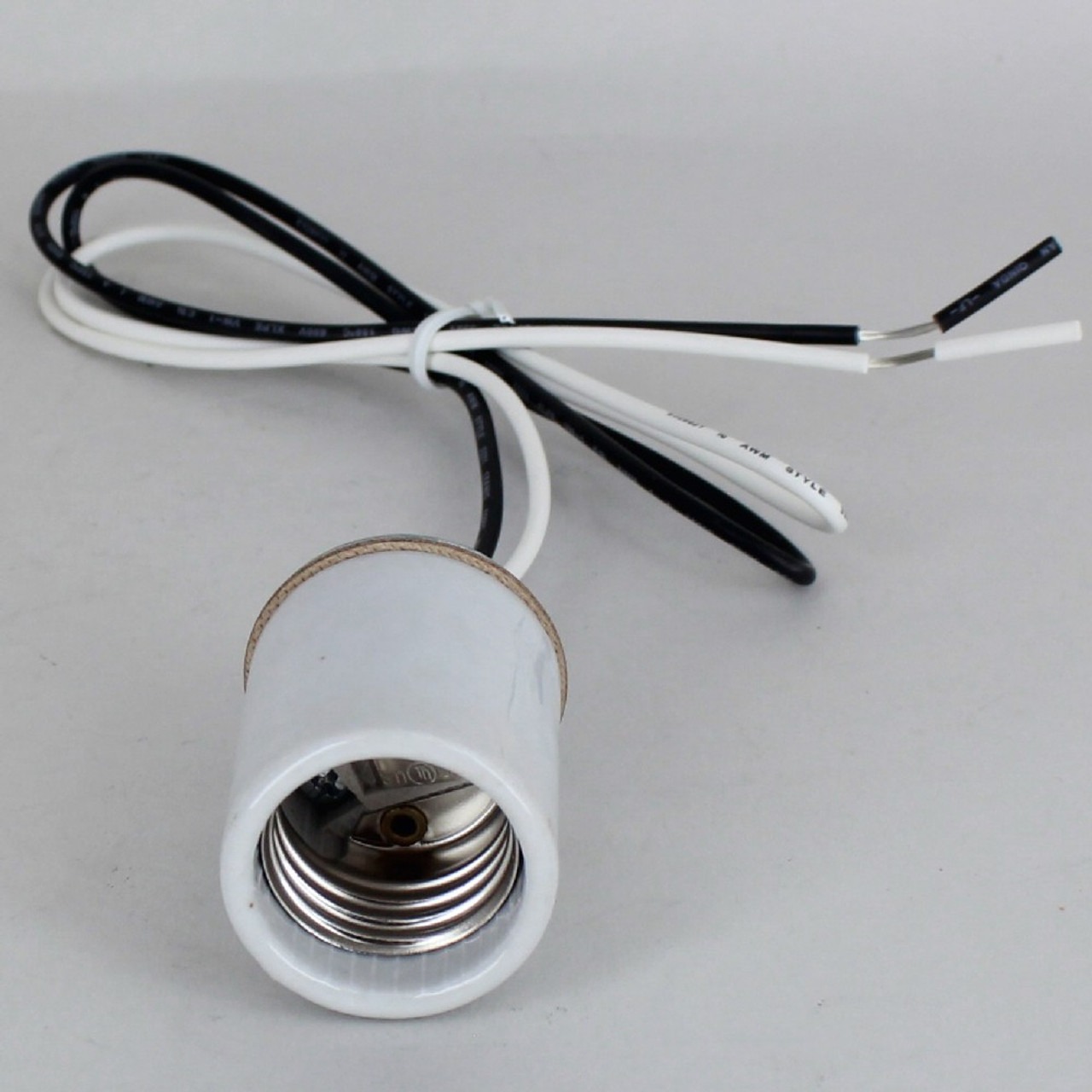

In the process of @ItsAllInMyHead mentoring me in building an Aleph J, the concept of a Dim Bulb Tester came up. I did a quick search in the forum but thought it might be helpful to any other dim bulbs out there to post what I found. I like the idea of having a switched outlet so I ordered this, and for the socket. Other than that, a 3 conductor power cord, 1 end cut off, and a work box for the outlet, super easy peasy. Add to that maybe 3 different wattage incandescent light bulbs and for about $15-$20 a nice way to test and possibly save an Oops!

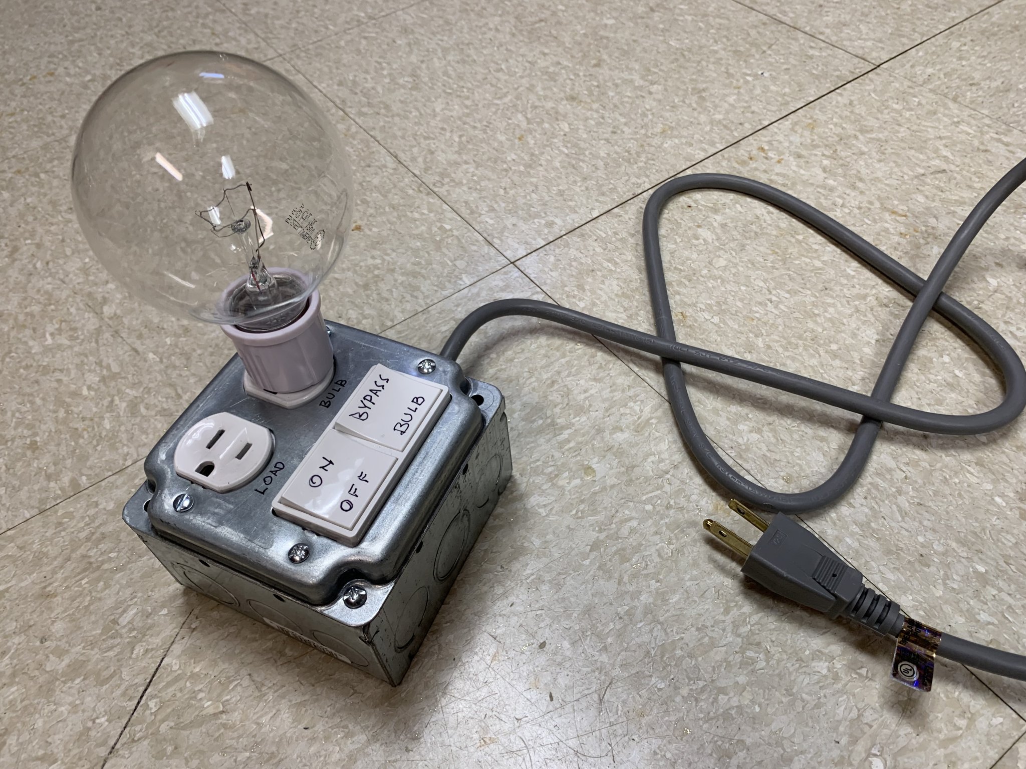

I use both, not at the same time. This was my ACE hardware build. Simple, solid, and compact.
Reactions: 1 users

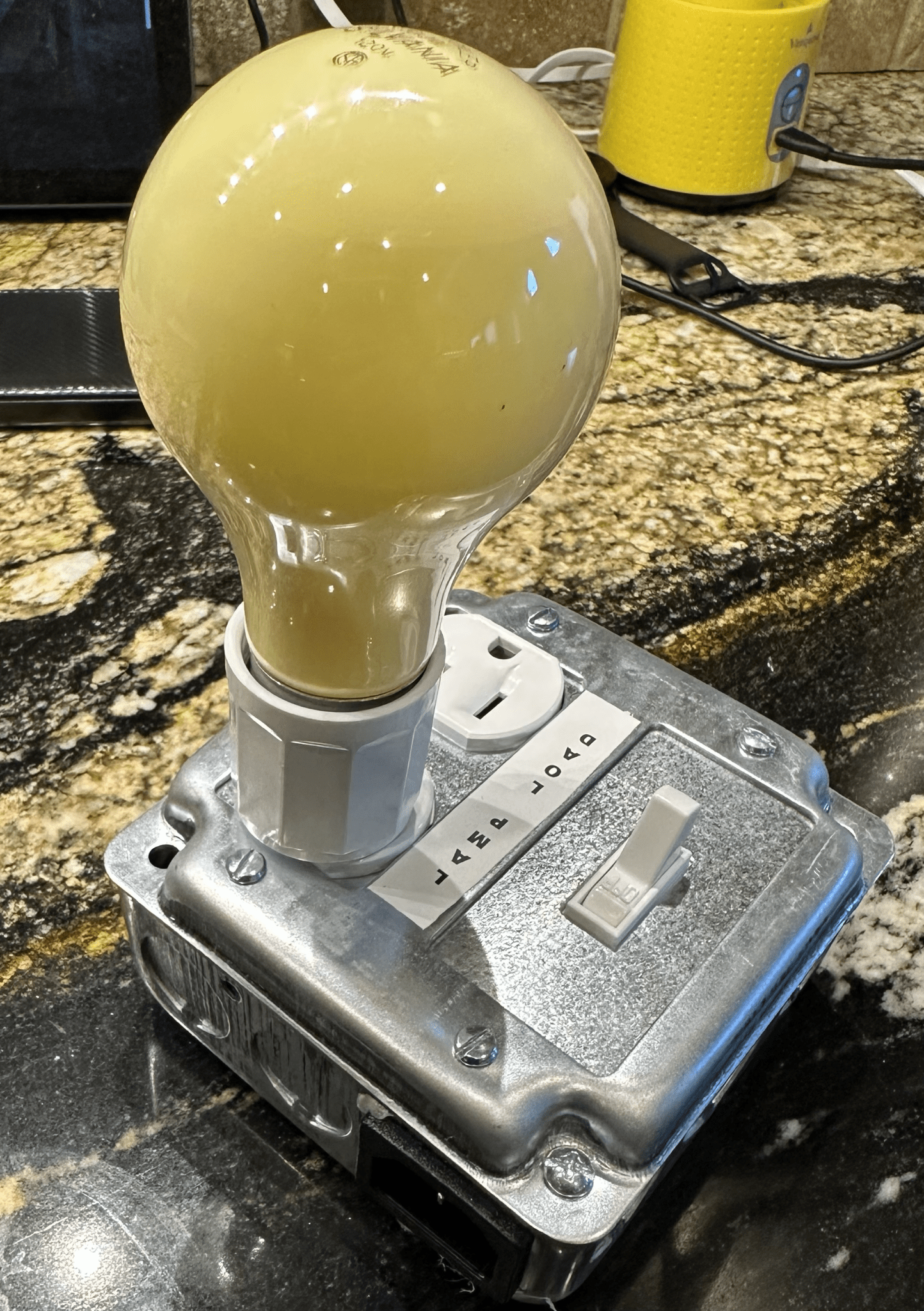

Sold my diy built dimbulb tester a while back (The yellow bulb I got from McMaster-Carr):
Like Russell says, it’s fine for your first few projects, after that…variac!
