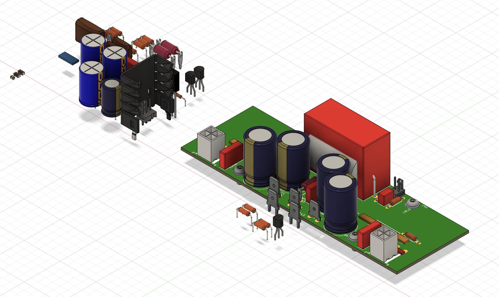

Ahh, to see JPS64’s mastery of the art of layout. Work in progress, but the PCB will have same footprint as Alpha 20 and be UMS compatible and have option for flying lead Molex Minifit Jr connectors.

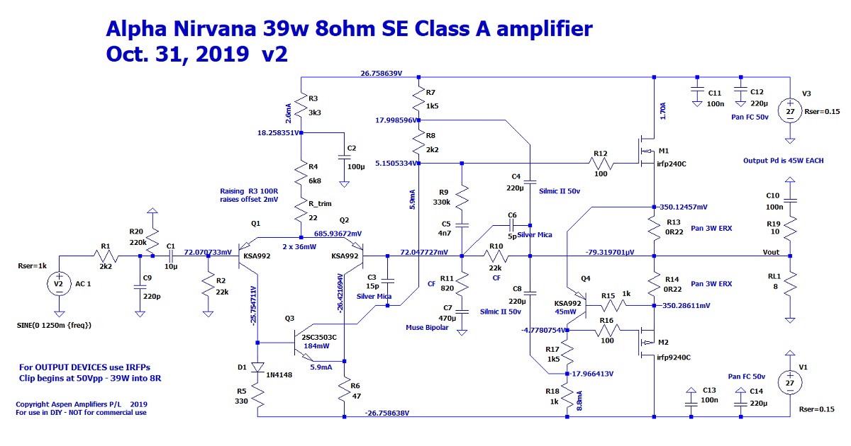

All correct, Bigun........
One thing; the active CCS is concertina, the voltage across the two sources resistors will remain constant at 0.65V, but the two resistors will pass conjugate currents which will always sum to 3.4A. The two resistors are identical so that the see-saw action is completely symmetrical.
HD
The original Aleph current source allows you to tweak how much of the load induced current variations are passed back to the amplifier and I remember reading that a symmetrical split was not always the preference - in this SEPP/SRPP style you can also tweak the values of the two resistors so that it’s not symmetrical, if you happen to prefer it that way... of course you will trade off some of the efficiency if you do that.
791246d1572467756-alpha-nirvana-39w-8ohm-class-amp-516feaf4-73bd-4421-9b28-647e092a1329-jpeg
Warning with PCB.
The two 0.22 ohms resistors must imperatively be non inductive , I used ordinary 5w the circuit oscillate. They must be physically parallel very near to each other so that there is the least distance for the Q4 transistor to capture the current sense . I don't see the outputs , the source of IRFP9240 must be just on the 0.22 ohms . This makes the P MOSFET ,Q4 and the two resistors must make a single block . You are dealing with a closed loop circuit of 10Mhz.

Here is the Alpha Nirvana v2 schematic with Hugh's latest tweaks:

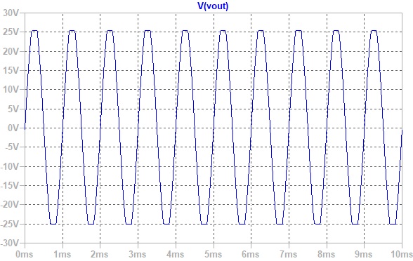

Here is the behavior at clipping - notice how symmetric it is:

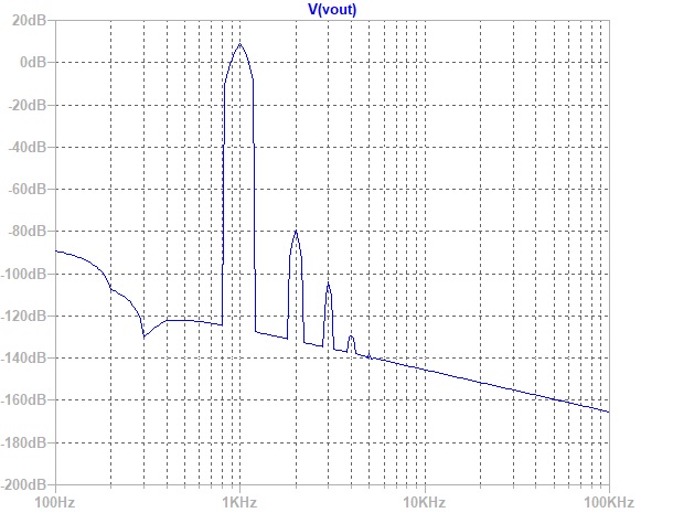

Here is the FFT for 8Vpp into 8ohms:
attachment.php
Here are the distortion components with 0.0039% THD:
Code:
Harmonic	Frequency	 Fourier 	Normalized	 Phase  	Normalized
 Number 	  [Hz]   	Component	 Component	[degree]	Phase [deg]
    1   	1.000e+03	3.937e+00	1.000e+00	   -0.68°	    0.00°
    2   	2.000e+03	1.538e-04	3.906e-05	 -113.08°	 -112.40°
    3   	3.000e+03	8.049e-06	2.045e-06	   56.41°	   57.09°
    4   	4.000e+03	1.027e-06	2.608e-07	  164.55°	  165.23°
    5   	5.000e+03	1.262e-06	3.207e-07	 -177.53°	 -176.85°
    6   	6.000e+03	1.038e-06	2.637e-07	  179.93°	  180.61°
    7   	7.000e+03	8.854e-07	2.249e-07	  179.88°	  180.56°
    8   	8.000e+03	7.748e-07	1.968e-07	  179.92°	  180.60°
    9   	9.000e+03	6.887e-07	1.749e-07	  179.93°	  180.61°
   10   	1.000e+04	6.198e-07	1.574e-07	  179.94°	  180.62°
   11   	1.100e+04	5.635e-07	1.431e-07	  179.94°	  180.63°
   12   	1.200e+04	5.165e-07	1.312e-07	  179.95°	  180.63°
   13   	1.300e+04	4.768e-07	1.211e-07	  179.95°	  180.63°
   14   	1.400e+04	4.427e-07	1.125e-07	  179.95°	  180.64°
   15   	1.500e+04	4.132e-07	1.050e-07	  179.96°	  180.64°
Total Harmonic Distortion: 0.003912%(0.004251%)

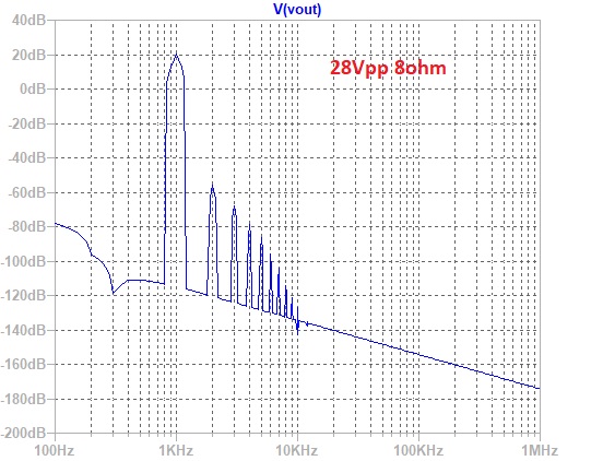

And here is FFT for 28Vpp into 8ohms (12.5w):
attachment.php
And here are the distortion components for 0.016% THD:
Code:
    1   	1.000e+03	1.417e+01	1.000e+00	   -0.68°	    0.00°
    2   	2.000e+03	2.278e-03	1.608e-04	 -115.76°	 -115.08°
    3   	3.000e+03	5.799e-04	4.092e-05	   51.25°	   51.93°
    4   	4.000e+03	1.615e-04	1.139e-05	   20.66°	   21.34°
    5   	5.000e+03	6.764e-05	4.773e-06	 -110.87°	 -110.19°
    6   	6.000e+03	2.623e-05	1.851e-06	 -177.51°	 -176.82°
    7   	7.000e+03	8.719e-06	6.152e-07	   98.94°	   99.62°
    8   	8.000e+03	3.366e-07	2.375e-08	  -37.39°	  -36.70°
    9   	9.000e+03	2.908e-06	2.052e-07	 -157.53°	 -156.85°
   10   	1.000e+04	2.602e-06	1.836e-07	  178.74°	  179.43°
   11   	1.100e+04	1.990e-06	1.404e-07	  176.05°	  176.73°
   12   	1.200e+04	1.803e-06	1.272e-07	 -179.77°	 -179.08°
   13   	1.300e+04	1.709e-06	1.206e-07	 -179.55°	 -178.87°
   14   	1.400e+04	1.588e-06	1.121e-07	  179.91°	  180.60°
   15   	1.500e+04	1.477e-06	1.042e-07	  179.90°	  180.58°
Total Harmonic Distortion: 0.016635%(0.016717%)

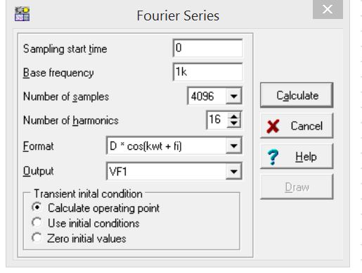

Here is the LT command line:
.options method=gear
.options numdgt=7
.param freq=1k
.param numcyc=10
.param dlycyc=10
.param FFT=2**16
.param simtime=numcyc/Freq+dlytime
.param dlytime=dlycyc/Freq
.param timestep=(simtime-dlytime)/FFT
.four {freq}15 8 V(Vout)
.four {freq} 4 8 V(Vout)
Perhaps you can suggest how to change this to delay the measurements for ten cycles?

You could brute force it by running the sim for a much longer time. These sims take about 5 seconds and are going to get the profile shape and THD probably within 10% of final answer. Extending the duration by 10x or circa 1min sim run probably works but not pleasant to do.
It’s might have something to do with delay-cycles directive.
.param numcyc=10
.param dlycyc=10
